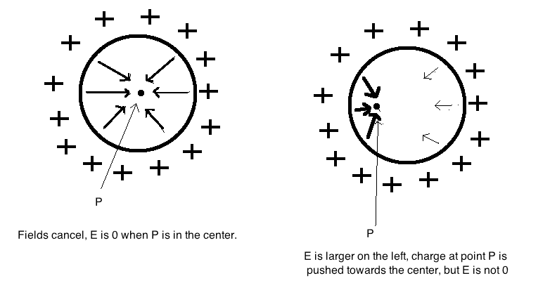

Given a charged sphere, the electric field within it is zero at every point. Why is this? Why is not merely zero only at the center? If a sphere is conducting, then its charge is all across the surface. If electric field is inversely proportional to distance from charge squared, won't the field be greater at a point that isn't in the center, as it will be closer to one side of the sphere?
My attempt to visualize this question: http://[PLAIN]http://i.imgur.com/nhvZjNh.png
In your second diagram, what about all the charges on the right side that would contribute arrows generally opposite to those you drew?

Consider the situation in your right figure. The charges on the left are closer to P, but there are more charges to the right of P. Look at an infinitesimal solid angle pointing directly left of P, and another one pointing directly right. The right solid angle subtends a larger surface area than the left solid angle. The amount of surface area subtended increases with distance squared (for uniform charge distribution). Therefore, the number of charges per unit solid angle increases with distance squared. The force per charge decreases by 1/distance squared. Distance cancels and the force per solid angle is independent of distance.
Similarly, the brightness of a surface is independent of distance. That's because intensity drops off as 1/distance squared.
