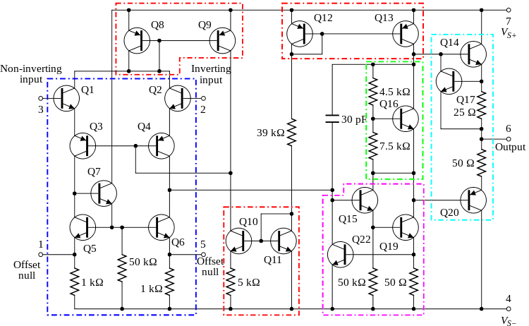

This is the most typical op-amp, according to Wikipedia:
We see the input voltage difference converted into proportional current that is charging the 30 pF capacitor. The capacitor voltage is added to the (Q15 base potential which is almost the) "Vs-" potential and the result is applied to the input of the output voltage follower thus defining the output potential.

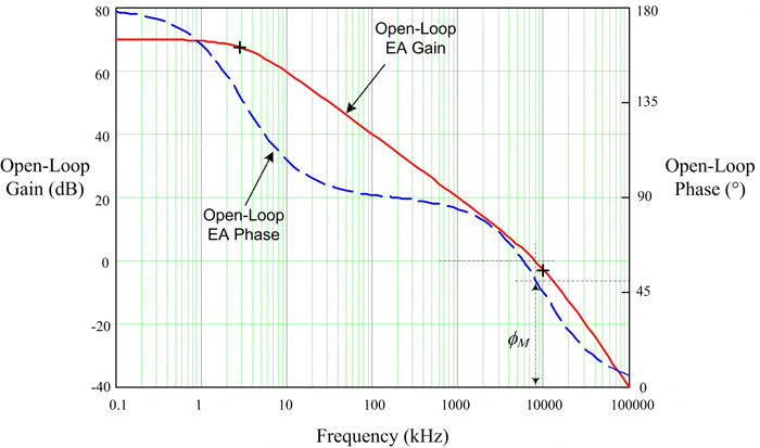

It's not really "charging" that capacitor. That is likely the "dominant pole" setting capacitor for the opamp, which is needed for stability when the opamp is used in feedback configurations.
http://m.eet.com/media/1126333/266795-6666155_fig2.gif
Likes AlexCaledin
