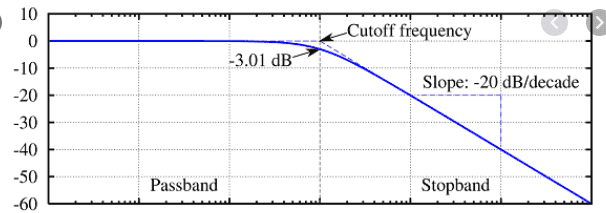

Does this picture of a low pass filter's frequency response help? The horizontal axis is log of frequency. The vertical axis is attenuation. The simple answer is that higher frequencies are attenuated by the filter, so a waveform with fundamental plus higher frequencies will come out closer to fundamental only.
