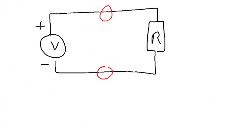

Hey! I have a question and a drew up a diagram to help out. I drew up a circuit that includes just a voltage source and a resistor. I know the voltage is constant in each of the circled portions of the circuit. As in, as you move through the wiring, the voltage doesn't change from one point to the next. Really, the voltage only changes when you move through the load. This much I know, haha.
The source of my confusion is I don't know why this happens. If voltage is supposed to be the driving force that moves the current, how can the electrons move from one point to the next if the voltage isn't changing? After all, there isn't a difference in energy states from one point to the next within the wiring, so what's causing the motion?
This has been what's bothering me. Any and all help is appreciated!

Connect one lead of a voltmeter to the negative terminal of your voltage source. Now connect the other lead of the voltmeter to first one circled section of wire, and then to the other circled section. Do you get the same voltage reading for each of the two different connections to the circuit?
Consider the water level in a slow flowing river. It's not exactly level, but near enough. The same applies to the voltage in a good conductor.

To simplify circuit design we assume that the voltage across a wire is zero. In reality it is a small nonzero value. Unless you are talking about a superconductor.
If you were building your circuit in a classroom setting you would often be using 22gauge wire. This is about 0.053 ohms per meter. If you were to have a small lamp that draws 0.1 Amps through say 0.1 meter wire you would get 530 micro-volts. Even if you were using a single cell at 1.5V that is an insignificant amount and we can safely call it zero in most cases.

When we say that the voltage is the same at both ends of the wire, that's a very good approximation, not absolutely true. The wire has some very very small resistance (for example, ten centimeters of 14 gauge has a resistance of about .0001 ohms), so by ##V=IR## if there is any current flowing there will be some minuscule voltage drop along the wires.
In many more practical problems we can just neglect the resistance of the wire altogether. It's a good exercise to calculate the voltage at both ends of the wires in your diagram, assuming a 10 volt power supply, a 1000 ohm resistor, and the wires having a resistance of .0001 ohms as in my example above.
Even when we cannot neglect the resistance, we often care only about the current flow through the circuit, and then we can treat the wire as having as having zero resistance while adding the resistance of the wires to the resistor itself - we get the same answer and the calculation is easier.

I see, so it's just an approximation. There is a change in voltage as the electrons move through the wire, and that change is going to be a function of the wire length among other things.
There is another thing that is still bothering me though. I know that current is constant throughout a circuit, but how can it remain constant if the voltage is dropping? These electrons move with an amount of potential energy that changes as you move throughout the circuit, and yet, they still move at the same speed throughout. How is this possible?

The current can remain constant if the voltage difference between any two points in the circuit is given by ##\Delta{V}=IR## where ##R## is the resistance between those two points (this is just Ohm's law; the ##\Delta{V}## instead of ##V## is to make it clear that it's the voltage difference, not the absolute level, that matters).

Yes that is absolutely true. My initial thought was, okay, if the entire voltage of the voltage source drops across the resistor, then what is the motive force driving the electrons towards and away from the resistor? Following E=IR, there must be a very small voltage drop across each "feed" and "return" wire to the resistor. Indeed very small voltage drops are there, but they are essential to a functioning circuit.
I thought that this was kind of interesting and hope it is somewhat interesting to others, and it helps and does not confuse the OP.
That's right - it's what it's what @rtbell1 said in #4 and what I was trying to say in #5.
...but they are essential to a functioning circuit.
For any real circuit built out of real wires that have non-zero resistance, yes. The zero resistance ideal wire is a very useful idealization that when applied thoughtfully works for an enormous number of problems and gives the same answer as the more painful calculation that recognizes that the wires are not really ideal. That's why we teach it, and that's why everyone studying circuits should have it down cold before they move on to the harder problems. But once you've got that baseline, you do have to learn to recognize and properly handle the situations in which the zero resistance wire idealization won't work - the electrical code has an entire chapter devoted to the resistance of wires and why it matters.

Although quite 'popular', that is not a valid model for how energy is transferred along a wire. The average speed of the electrons in a wire (the drift velocity) is a matter of around 1mm per second. The mass of electrons in a wire will be a tiny fraction of the total mass of the wire. That would be 1/1800n where n is the atomic number of the metal (29 for copper). Do the sum for KE with that and you'll see that the electrons that arrive at the end of a wire with virtually no KE at all.
As with a bicycle chain that transfers power, the chain links are going slowly and their KE is negligible but they transfer all the cyclist's power to the wheels.
Edit: The drift velocity of the electrons does change on the way round the circuit. The same number go past all points around the loop per second but (as with water through pipes) for a given number per second, the speed will be slower for a thicker wire (fat pipe and faster for a narrow wire (narrow pipe).

Explanatory models for electronic circuits assume that all conductors connecting the parts of a circuit are perfect, with no resistance, capacitance or inductance. To predict the circuit's real behavior, one adds virtual resistors, capacitors and inductors to account for the non-idealities. Estimating the resistances, inductances and capacitances of these virtual components and applying the appropriate mathematical models (eg. Ohm's law), one can predict the behavior of the circuit. To get a notion of the convenience of using fictitious components, take the case of a battery: An electrochemical voltage source is modeled as having an internal resistance, pictured as a resistor in series with an ideal voltage/current source. In turn, 'internal resistance' is an idealization of more than one factor that opposes the flow of electrons into and out of the battery. Perhaps the most significant of these is the finite speed at which the chemical system in the battery can donate and receive electrons. As a battery ages, the concentrations of reducing and oxidizing agents in its component cells decrease and the reaction between them slows down. ( Same goes for temperature: As we know, batteries don't 'work' when they're too cold.) When you place a voltmeter across a battery's terminals, the current drawn from the battery must pass through the internal resistance of the meter. As long as the battery's internal resistance is negligible compared to the meter resistance, the latter will read the voltage defined by the standard electrochemical potentials of the battery reactions. So even a 'dead' battery will show a voltage when measured by a good voltmeter. Connected to a real circuit, however, and this condition is no longer met - the internal resistance of the 'dead' battery exceeds the resistance of the circuit and very little current will flow. This is why a 'battery tester' meter contains a low-value resistance in parallel with the meter - to simulate a realistic load on the battery.
