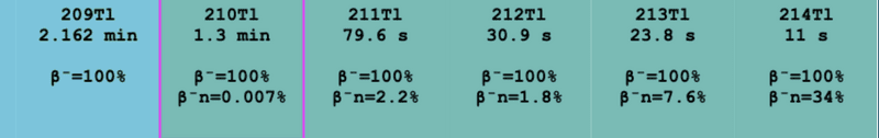

Looking at the Tl isotopes 209 through 214, one sees a decrease in half-life and high fraction of β-,n decay. There are heavier nuclides that may decay by β-,n, e.g., 221Bi, 227At, 233Fr, and the heavier isotopes of those elements. I suspect they have very short half-lives and are difficult to produce given the relative high n; they are also odd Z elements, Bi (Z=83), At (Z-85), Fr (Z=87).
230Ac is perhaps the lightest nuclide that can undergo 'spontaneous fission' (SF), but is more likely to undergo beta decay with a half-life of 122 s.
