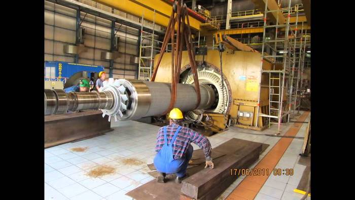

@cnh1995 gave you good answers. Here's another.
Look at the generator rotor in the picture below. It is almost all field winding to make the electromagnet. Can you imagine making a permanent magnet that size? How would its size and weight compare with the electromagnet of the same field strength?
Thank you for demonstration.
So Synchronous motors are given external power to generate out power ?
Your have the right idea, but the wrong words. Synchronous generators use external sources to power their field windings. But the field winding power is tiny compared to the mechanical power used to spin the rotor. Usually, a turbine provides that mechanical power.
