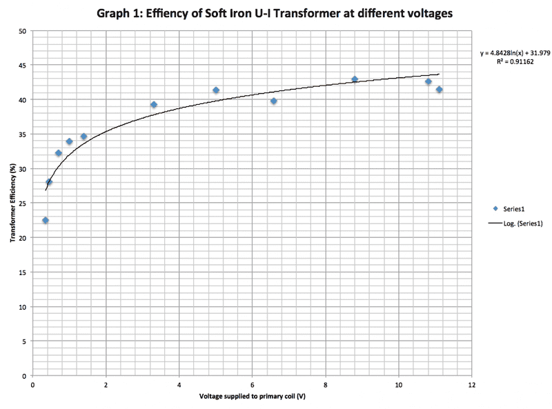

Why the efficiency of air core transformer changes (up and down)
In summary, the efficiency of air core transformers can change both upwards and downwards due to a variety of factors. These include changes in the core material, variations in voltage and current, and fluctuations in temperature. Additionally, the design and construction of the transformer can also impact its efficiency. Understanding these factors and their effects on efficiency is crucial for optimizing the performance of air core transformers.
UtsavRaj
30

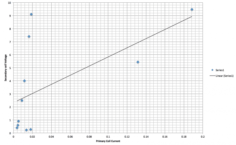

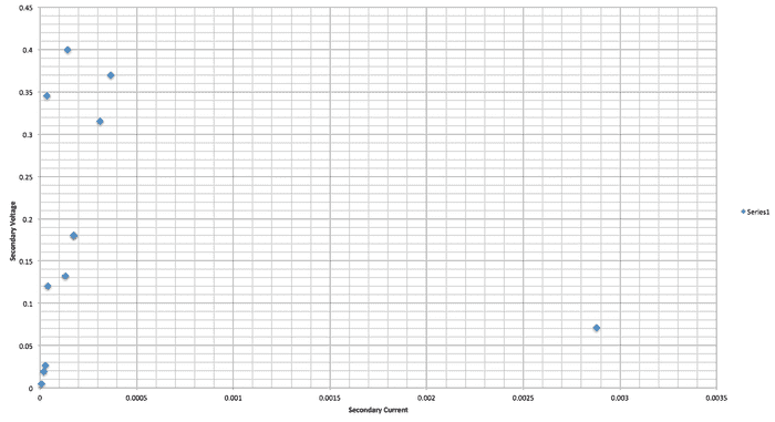

The graph below shows the efficiency of an AIR CORE transformer at different voltages (from MAINS). At low voltages, it has high efficiency and gets lowers because of high magnetising current causing heat loss. But why is it higher at some points again? I do not understand this pattern.
Please give me a detailed explanation with scientific terminology.
Thank you.
Graph : https://postimg.org/image/vd50yniox/
Table of current and voltage: https://postimg.org/image/cojojmvhd/
Efficiency and voltage:
https://postimg.org/image/di6wj9jlj/

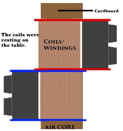

The setup for air-core: the coil were put on top of each other with cardboard in between for support .(
Coil used: http://int.frederiksen.eu/shop/product/coil-f--student-transformer--400-turns
Looking at your graph it appears that at _one_ data point it has "high" efficiency (0.088%). Either side of that data point the efficiency appears more consistent with the rest of your graph. Is that data point correct?
Likes UtsavRaj

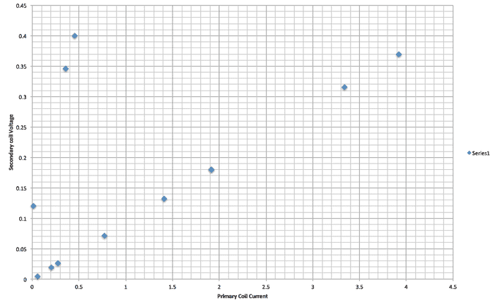

The graph looks like this if you zoom near the end parts. Link:https://postimg.org/image/t2y1eqhgh/
I want to understand why it has a bouncing ball type graph (as it goes up and down and less up and down and so on)

So I looked at this graph..
At low voltages (<1V) there are four data points.
0.2V approx 0%
0.4V approx. 0.09%
0.6V approx. 0%
1V approx. 0%
Only one of these data points has "high" efficiency. Is it possible you made a mistake when recording the data?

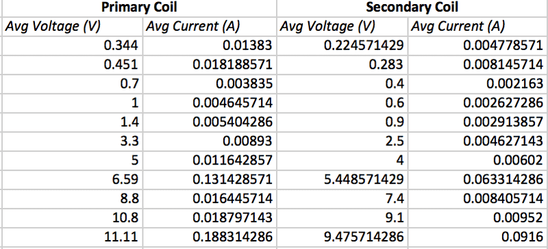

Is this...
_all_ of the data from the experiment?
If that is all of the data you have then the "bouncing ball type graph" is probably due to the curve fitting program you used. You do not appear to have enough data points to get a nice smooth curve that bounces up and down.

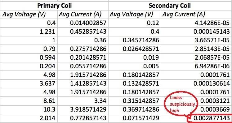

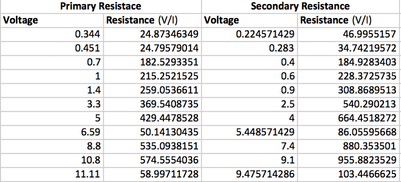

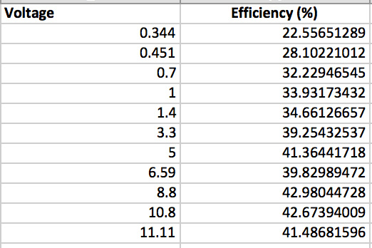

The data i used to plot is the one below:
I don't get why it rises again at the specific voltages and believe that people here can help me. I used the bouncing ball idea as it was easier to convey but it really does show a similar pattern although i agree that the data is a little low to truly call it that. But i am interested in the explanation of the rise-drop than the trend itself.
Thank you for your time

I apologise as I framed it wrongly. What i meant was that at specific voltages the there an increase in efficiency but as you from lower to higher voltages, the increase became smaller and smaller.
Hope this helps you understand what i want meant.
What was the turns ratio of the transformer? I tried calculating it using the primary and secondary voltages and get either 3:1 (3 data points) or about 27-30:1 (8 data points).
How were you measuring the secondary current? What was the secondary load? A resistor?

I don't think it is an effect of the transformer operation itself. I would expect some problems with data-taking, or maybe mechanical issues like a variable coil position (did you just put the other coil on top, or did you fix its location somehow?).
You have three groups of efficiencies: 0.00033% (most values), 0.003% to 0.013% (three values) and then this one outlier of 0.088%. That could indicate three different setups, or some changes between them. The small differences within the low-efficiency group can come from measurement uncertainties, I wouldn't worry about those too much. The massive difference between the groups needs an explanation first.

Which setup and which device(s) did you use to measure voltage and current? Did you change the range of the instruments?
How did you determine efficiency? Power in vs power out ?
How did you measure AC microamps to six significant figures the in presence of a line frequency magnetic field?
What is physical arrangement of the coils? The meters and their leads?
Be aware that in an air core transformer the flux is not constrained to an iron core, instead it's free to meander
so as secondary current increases it will make flux find another path back to primary coil
I think that a lot of what you measured is EMI.and you would have been better off to leave the secondary open circuited , using it as a flux detector, that way it wouldn't affect flux distribution
I used this coil for BOTH primary and secondary coil.

The coils have a square gap which you can see. So i put cardboard to hold it still.

The method went like this:
  • Powerpack attached to rheostat
  • rheostat attached to digital ammeter
  • Digital ammeter attached to Transformer coil (primary winding)
  • Transformer coil attached back to powerpack.
  • The digital voltmeter attached in parallel to the primary coil.
  • The secondary winding was attached to another Digital ammeter.
  • The digital ammeter attached to a bulb.
  • Bulb attached back to the secondary winding.
  • Another digital voltmeter attached in parallel to secondary winding.
  • All wires were copper wires.
  • All the voltage and current readings were taken from the respective devices and recorded.
As for the setup of Air-core transformer
The image below will help:
Note: Coil were resting on the table and no gap between the coils.

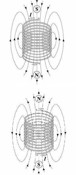

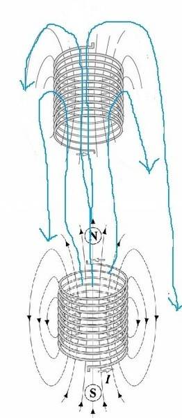

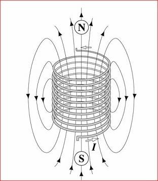

I work in thought experiments... so,
Fire up that young imagination !
Your coil makes a "solenoid", try a search on magnetic field of a solenoid
http://hyperphysics.phy-astr.gsu.edu/hbase/magnetic/solenoid.html
In yourimagination
think of the magnetic field from your primary winding
it might look like this
of course reversing itself at line frequency
Magnetic flux travels in closed loops just like current, so the analogy of "Kirchoff's Flux Law" applies.
The picture just isn't big enough to show the bigger loops of flux
but with no iron around flux does spread out into the surrounding space
Now stack an identical coil on top of your solenoid but don't connect the lamp load yet .
Some of the flux from your bottom solenoid, quite a bit of it in fact, will continue up and exit through the upper coil linking ts turns and inducing voltage there.
I drew that flux in blue, please excuse my lack of draftsmanship. It's "MSPaint" after all...
An open circuited coil in a magnetic field makes a simple flux detector - voltage is rate of change of flux through the coil , and whatever flux goes through it is changing at line frequency.
Current is what pushes flux, and the bottom coil pushes some of its flux through the top one. Since the top coil has no current it doesn't push back against the flux from bottom one.
Now connect a load to the top coil and let current flow in it
Now the top coil can push flux of its own
and it will push against the flux from bottonm coil because of something called "Lenz's Law"
giving you in effect opposing electromagnets
distorting the flux field
so some of the flux from bottom coil won't go up into top coil it'll detour out into air, lowering the efficiency of your transformer.
You could demonstrate that using paper iron filings and DC current through your coils
i didnt draw the re-routed flux on this one , i think you're savvy enough to have figured it out by now ...
observe opposing fields
so any current flowing in your secondary pushes flux down against the upward flux from primary, lowering secondary voltage
i think if you open circuit secondary you'd find secondary voltage linear with primary current
but as soon as you allow current to flow it shape shifts your flux field .

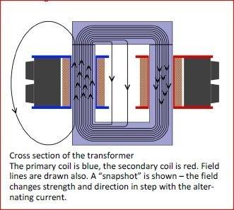

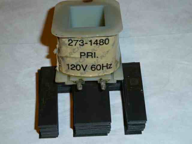

Now iron conducts magnetic flux hundreds or thousands of times better than does air
so with ah iron core almost all the flux stays in the iron
as shown in this picture from the datasheet for your coil that you linked
http://int.frederiksen.eu/shop/product/coil-f--student-transformer--400-turns , click on pdf
There's a small amount of flux that goes through the air
indicated by the solitary black lines going there in that picture
but a huge amount of flux going through the iron.The flux that shortcuts through air is a necessary evil in transformer design, it's called "Leakage Flux"
and precision transformers arrange the windings carefully so as to minimize it.
Your arrangement has a lot of it.

jim hardy said:
could you plot secondary voltage on vertical versus primary amps horizontal ?
The graph:
Can you tell me how this relationship tell you about the
jim hardy said:
The closer that is to a straight line the less your upsy-downsy was due to secondary coil's MMF pushing backward against primary coil's MMF
I find this graph very intriguing and most likely will be used in my Essay. Can everyone tell some more interesting graph like this?

Question regarding the previous explanation:
Does this mean that they are not closed or just very big loops?
Due to the pushing of the top coil to the bottom. Will it go into the air because of that only?
A little bit explanation would be nice here. Is it due to saturation?

Maybe someone has trouble with reading or positioning decimal points.
Looking at the graph at the top of post #21, I see three points out of line. For the two points in the top left corner 0.35V and 0.4V, I suspect the decimal point has been misplaced in voltage. If the values are reduced by a factor of ten they become 0.035V and 0.04V which then fall on the line.
The point on the LHS axis should be closer to zero volts which will be in the local EMI noise floor.
So maybe 0.12V is also out by a factor of ten making a corrected voltage reading of 0.012V.
Likes mfb and jim hardy
Thank you Baluncore. I will check again
Interesting graphs
UtsavRaj said:
Can you tell me how this relationship?
Also, I can find the resistance by taking out the gradient of the straight line. What resistance would i be taking about then?

Thank you for doing that.
It'd be really nice if Baluncore is right and there's a decimal point error or interference that pushed those three points off the line.
The reason i asked is this
1. A coil hanging in space that's occupied by a changing magnetic field will experience induced voltage.
That voltage will be the number of turns X rate of change of magnetic flux going through the coil
if no current is allowed to flow in the coil, it is then acting like a flux detector . A simple coil and voltmeter will do the job.
2. A coil hanging in space that has current forced through it will produce a local magnetic field with intensity that is directly proportional to the coil's current.
That is shown in the hyperphysics link i gave for field of a solenoid...
Since your two coils have the same number of turns
and your secondary current is thousands of times smaller than your primary current
i figured the the magnetic field in the region surrounding your two coils comes >99.9% from primary and <0.1% from secondary
which means your secondary makes a decent if imperfect flux detector, certainly close enough for plotting a graph.
It'll measure the flux in the area
What i wanted to see is -
Is measured flux linear with current ?
Secondary voltage measures flux
Primary current causes flux
if the ratio of those two is constant you'll get a straight line, ie constant slope
which would confirm that the primary flux is behaving as predicted by that hyperphysics link, which said
B = μnI
flux density B is directly proportional to current I, because μ is a constant of free space an n is 400 for your coil
giving one great faith in his data
If you find that those three outlying points were errors of transcription and they do indeed lie on the line
then your "efficiency" plot might straighten out.
I like to plot raw data for sanity checks.
For a hint at bulb behavior, plot secondary voltage vertical versus secondary current horizontal.

Oh my god, I am really embarrassed by my mistake.
Baluncore, you are absolutely right. It's actually what you predicted.
I am really sorry to everyone because of mistakes. Therefore, I will check all my work before I post all the changed graph.
Thank you to all who have been helping me.

Inductive reactance is a property of coils, the magnetic field surrounding them holds the energy from current that i mentioned above
Capacitive reactance is a property of plates separated by a small distance, the electric field between them holds the energy from current i mentioned up above
and since you are working with coils - surely you can guess which sub flavor of of reactance it is that you just calculated?
We designate capacitive reactance by Xc (uppercase X sbuscript C as in capacitance)
We designate inductive reactance by Xl (uppercase X subscript L as in lag)

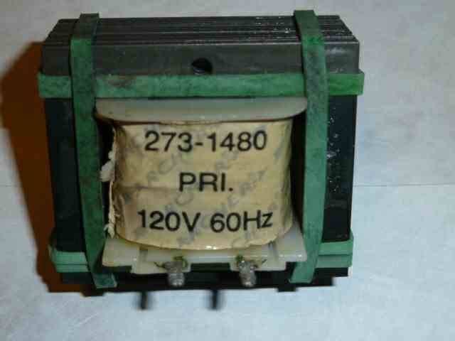

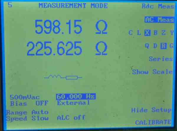

So how many ohms of Xl did you come up with for your transformer primary ? _____________________

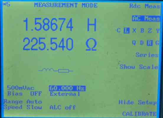

Inductive reactance is a characteristic of inductors, which have the physical property " inductance." and it's an important concept for any budding EE to grasp.
Inductance is named after a scientist Henry and we measure inductance in Henries. But we designate Henries not by H but L ( for some reason.)
Inductive reactance that you calculated from your measurement is the product of your coil's inductance and the frequency at which you are operating it.
Are you 50 hz or 60 ?
Xl = 2 X π X frequency X Lhenries
so L = Xl / 2πf
What is the inductance L of your primary winding ? _______________________
The physics definition of Inductance is (Flux Φ per Ampere I ) X #of turns N
L = NΦ/I
Now think back - that's why i asked you to plot secondary volts(proportional to flux) versus primary current. It tells you what is inductance of your coil.
And an air core coil will have constant inductance. But an iron cored one will not, because of saturation.
You specify inductors by their inductance L because they might be used at any frequency.
That's a too-basic of introductions to inductance, but it's tailored to your experiment. Now that you have successfully measured it, you'll want to read up on it .
