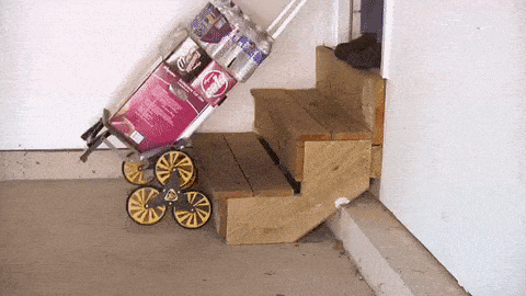

There are some situations for which a round wheel is not ideal, like climbing stairs or the side of a rocky mountain.
Legs or wheels that mimic the profile tends to work more efficiently in those cases, based on the principle of a more linear trajectory of the center of mass of the object.
