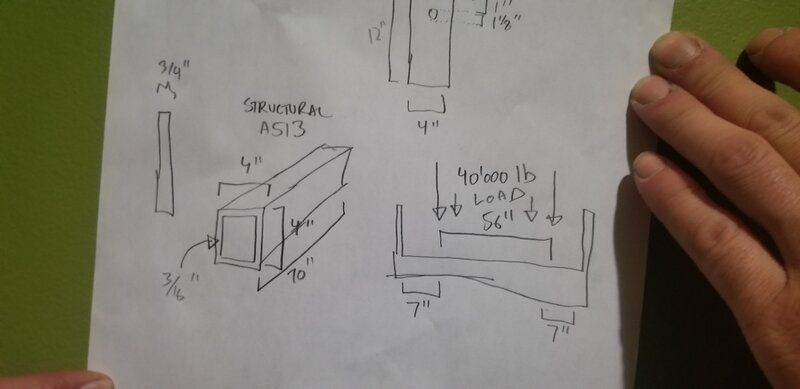

Have a lifting yoke with 7/8 inch lifting eyes welded onto the ends of a 3/16 or 1/4 inch wall 4x4 a500 or a513 square steel tube.
Expected UDL is as much as 35-40,000 lbs.
Is this tube going to fail?

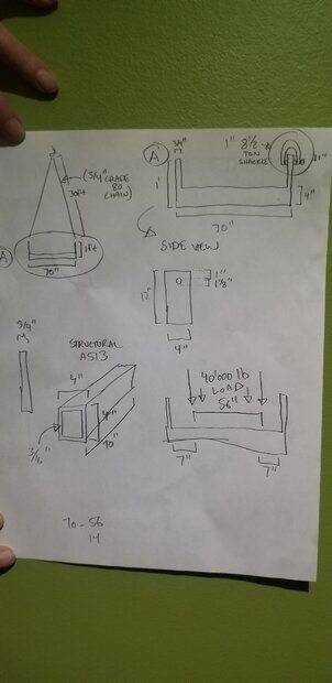

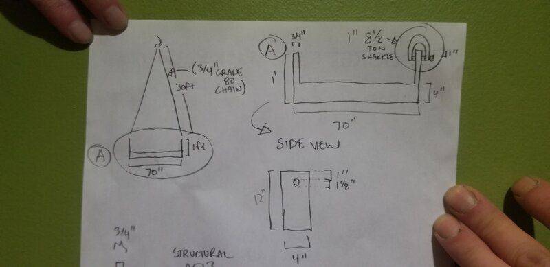

Look at the triangle of forces.
How long is the tube ?
How long are the risers from the tube ends to the common lifting point ?

I will send a napkin CAD within the hour.

Sorry is that even remotely a useful diagram?

Two 1", 8.5 ton shackles are insufficient to carry over 40,000 lb load.
You need to consult a qualified rigger.
You do not show the end lug weld detail. Is that a but joint under tension ?
The end lugs must be welded to the ends of the tube, in shear, closing the tube section.
Avoid the liabiliy. Say NO. It is a job for an engineer with insurance.
Okay. The weld is the whole way around. It is a butt weld. There's at least 5 passes. It's built up a 1/4 inch. Hard corner on the 4 inch tube was chamfered.

The question is what is a safe UDL for an A513 3/16" wall 4"×4" square tube 70" in length.

You show the load is being distributed over the upper surface of the square tube. That upper surface is under compression, with the lower surface under tension.
I expect the failure mode will be by buckling of the upper surface of the tube. The constraint to that buckling is the tube side walls.
So how do you distribute the load on the upper surface?
The loaded beam model employed will depend on the load being lifted.
If the material being supported was a loose bundle of material it might be evenly distributed, but if it was a solid block then the load could be carried at the mid point, or at the two outside edge points, depending on if the load or the square tube deflects more.
How can I explain. It might be a length of 56 inch wide conveyor belt hanging vertically. A flat one inch wide thing would still be heavier in the middle, hypothetically would it not? In any case a centre point load is the least desirable of the possible situations. Then the question would be what it the minimum breaking strength of that square tube with a centre load. Is that what I am understanding?
That's not hypothetical. The load would be centred. I mean an evenly thick load is heaviest in the middle no?
