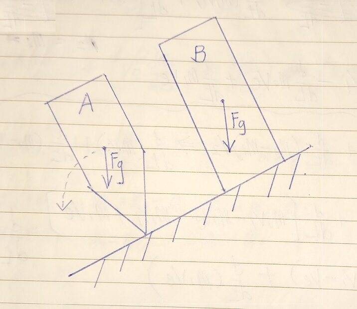

Will a round-headed rod topple if it slides down a frictionless slope?
In summary: Welcome to PF. In summary, the problem is that, someone told me that a ball won't roll when sliding down a frictionless slope because the resultant force mgsinx is parallel to the slope which means that the ball will slide down the slope. Now, replace the ball with a round headed rod, does this means that the rod won't topple no matter the rod is perpendicular to the slope or not? Actually, I think the torque is not "around the point of contact" but rather around the center of mass of the rod.
James Brown
Well, the problem is that, someone told me that a ball won't roll when sliding down a frictionless slope because the resultant force mgsinx is parallel to the slope which means that the ball will slide down the slope. Now, replace the ball with a round headed rod, does this means that the rod won't topple no matter the rod is perpendicular to the slope or not?

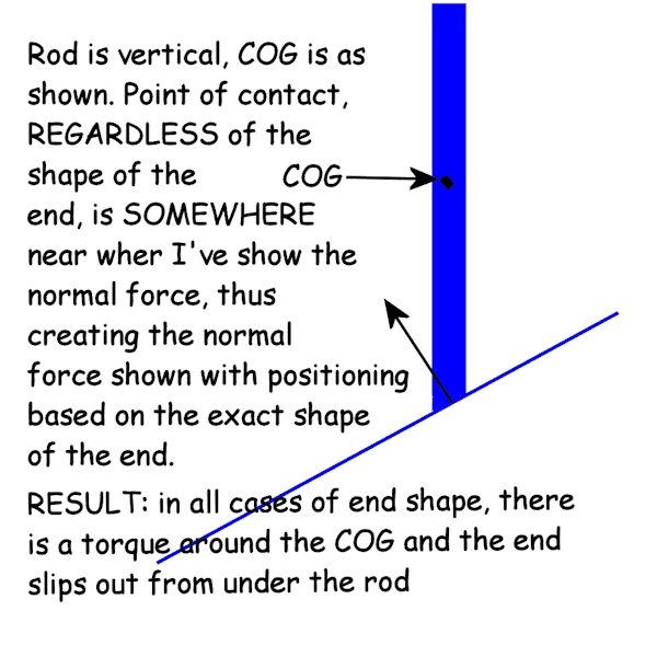

phinds said:
... so the rounded bottom will slide out from under the center of mass ...
Then in your analysis, that must also be true of the ball.
Do you assume the rod is vertical or perpendicular to the surface?
James Brown said:
... , does this means that the rod won't topple no matter the rod is perpendicular to the slope or not?
No, because the normal force of the ball pressing against the slope runs THROUGH the center of mass so absent any impediment (friction) to the point of contract, the ball has no reason to roll. With the vertical rod, the normal force against the point of contact with the slope does NOT go through the center of mass, so there is an imbalance and the rod topples.

phinds said:
With the vertical rod, ...
Ah. You assume the rod is vertical.
The OP assumed the rod could be perpendicular to the surface.

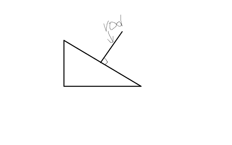

@Baluncore what do you mean rod vertical and rod perpendicular, vertical and perpendicular are synonyms depending on the context. A scheme would help here.
If the rod is going to topple there must be a net torque around some point, I don't see any net torques here.
Actually I think I am wrong, the weight has a net torque around the point of contact
Exactly. The rod does, the ball doesn't. See post #10
The two special cases are with (1) the rod perpendicular to the slope, and (2) the rod vertical.
1. The rod would remain perpendicular to the slope as it slides, with all parts accelerating at the same rate. A sphere is an example of a short rod, with CofM on the perpendicular to the contact point on the slope.
2. A vertical rod would rotate about it's CofG, and would fall as the foot slid down-slope.

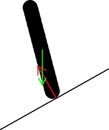

Delta2 said:
I think we mean a perfect rounded head that has only one point of contact with the slope.
Indeed
I think this is the point @Baluncore made in #21 in diagrammatic form.
There are only two forces here in the absence of friction - the green weight and the red normal reaction force. The weight has no moment about the center of mass of the rod so is irrelevant to whether or not it rotates. The normal reaction force, however, can cause it to rotate except in the special case that it points at the center of mass - i.e., when the rod is perpendicular to the slope. In the case shown, the rod will rotate clockwise as it slides down to the right, so "fall backwards".
In reality, a frictional force pointing up the slope will tend to cause the rod to rotate anticlockwise. Which way the rod actually falls depends on the balance between the torques from the normal and frictional forces.

Well so if the Reaction force does not point to the center of weight the rod will topple?
Looks like it to me. If it feels slightly counter intuitive, I think it's the lack of friction messing with your notion of how stuff behaves.
