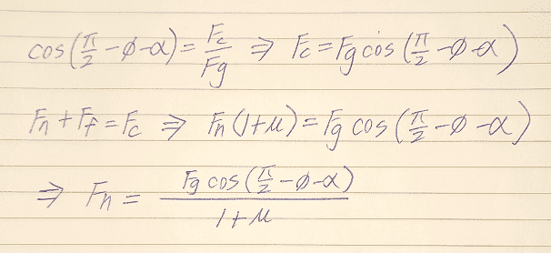

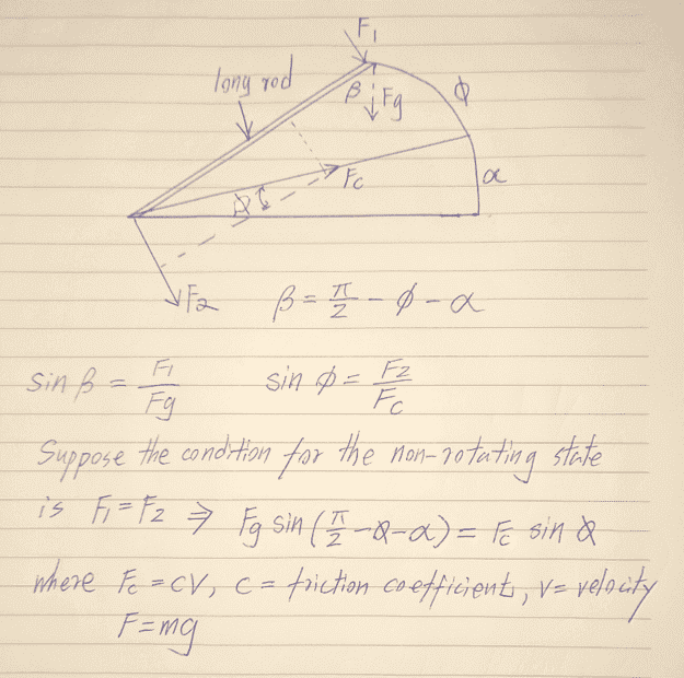

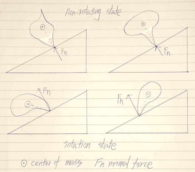

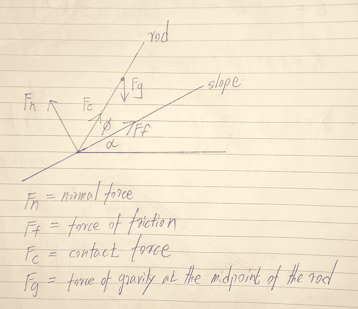

  • #87
Other examples are as follows. Even if the surface is completely free of any friction, IMHO I think it's clear that the long rods will still fall down.
Likes Delta2

But isn't every part of the rod being acted on by the same gravitational force, @alan123hk? Especially in your second diagram. If friction does not impart any force on the contact point, why would it move any faster or slower than the other end?
Likes alan123hk

Melbourne Guy said:

Edit : Think again, it feels like if the inclination is small, the long rod will tip over like in the second diagram, but if the inclination is large, it is very different, I don't know what will happen yet, maybe it will tip over slowly or never tip over, but of course the long rod in the horizontal state will accelerates to the left and down.. :smile:
