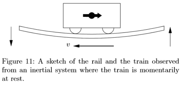

No, this doesn't follow.
It is true that one can construct a stationary elevator with flat floors in a stationary frame. "Stationary frame" is just a word here to distinguish it from "Superman's frame", there is no claim that it's stationary in any absolute sense. Similarly, one can construct another elevator instantaneously co-moving with Superman with flat floors. But, non-intuitively, it turns out that the elevator with flat floors in the stationary frame won't have flat floors in superman's frame. And vica-versa. The elevator with flat floors in the stationary frame is a different elevator than the one with flat floors in Superman's frame.
To appreciate this takes some math, in particular the Lorentz transforms. It's a consequence of the relativity of simultaneity.
Special relativity can only be easily applied to accelerating frames if we use the idea of instantaneously co-moving inertial frames. Fortunately, this is quite possible to do. To proceed, we need to distinguish between the time t in the stationary frame, and the time t' in the moving frame, they are related by the Lorentz transform
$$t' = \gamma(t - \beta x/c) \quad x' = \gamma(x - \beta c t)$$
Here ##\beta## is the normalized velocity ##v/c##, and ##\gamma = 1/\sqrt{1-\beta^2}##.
Saying the floor is flat at some instant t means that x=constant for all t. When we perform a Lorentz boost , though, we find that x' as transformed won't be constant for all t', we findthat the flat floor of the elevator will no longer be flat in the moving frame. The Lorentz transformations are linear, which is why one might expect a flat floor to map to a flat floor. But the elevator is accelerating, and the Lorentz transformation mixes together space and time, so while the Lorentz transform is linear, the accelerated motion is not linear.
See for instance figure 11 of the paper https://arxiv.org/abs/0708.2490v1
The paper is mainly about Thomas precession, but it also illustrates the effect I'm talking about, where the floor (rails in the paper) appear curved.

I agree that Superman's motion, as seen in the elevator frame (i.e, Green Lantern's frame), is perpendicular to the direction of the elevator's acceleration.
However, @pervect is correct that, in Superman's frame, the elevator floor will not be flat. More precisely, the spatial locus occupied by the elevator floor at some constant time ##t'## in Superman's frame will not be a flat plane. The reason is relativity of simultaneity; surfaces of constant time in the two frames "cut" the world tube of the elevator floor at different angles, and only one such "cut" results in flat planes.
Likes dagmar
dagmar said:
@pervect Huh? What's this all about? I was referring to your #12 post. The direction of motion of the second elevator is at right angles with its flat floor, and both floors of the elevators are parallel to each other. It's shooting upwards the surface of an imaginary planet past a stationary elevator on the surface of the planet, at constant speed ( and the acceleration of gravity is constant, no matter what height above the surface of the planet, at least that's what your example indicates).
Edit: Let's remove the planet in the above example and stick to elevators only.
I suspect we're analyzing the same problem, and you're just not getting the point of what I was trying to say. I can see where it might be difficult to follow, but I'm not sure how to resolve the issue. I'd normaly suggest drawing a space-time diagram, but aside from the usual resistance in getting people to either draw their own space-time diagrams or look at space-time diagrams that others have drawn, one would need a 3-d diagram. One needs a time axis, an acceleration axis (the z-axis in my own thoughts), and another axis for superman to fly along (the x-axis, in my thoughts) that's perpendicular to the acceleration axis, to fully depict the problem.
The end result, though, is that one does not wind up with two elevators with parallel floors. Your intuition that it does is leading you astray here.
Ok, draw your diagrams. What you get is an hyperbola in the t-x plane for the stationary observer and another one in 3D space not belonging in any of the t-x, t-y or x-y planes. Uniform acceleration didn't you say? Right, now measure the radius of curvature of your two hyperbolas and find them to be constant and equal. Next, measure the magnitude of your 3-acceleration vectors and find them to be constant and equal. Who cares in which direction your vectors point at? Who cares in which direction your elevator floor is pointing at, or if its shape is cubic or parallelepiped? (Put a wedge shaped object on the floor to make it level and stand on it, to do your experiments!). You have found constant and equal in magnitude acceleration in both frames and that's exactly the measurement of the extension of your spring and that's equal in both frames, and regardless of the direction of motion of your second elevator with respect to the first, up or down, to and fro in any frame...
I am repeating what I have just said: Since when, and in what possible way the phenomena observed in a closed elevator that undergoes constant acceleration g with initial velocity=0, will be any different than those in another elevator that begins to accelerate constantly ( same g in magnitude and direction ) with initial velocity v?
Please do not lead the OP astray, by altering the meanings of the words that you've just written firstly, and by passing from idealized examples to real world situations secondly, and this applies to @PeterDonis.
Cheers, be good!

Idunno said:
Thanks everybody! :) Is there an easy way to calculate the spring extension when you use Einstein's elevator? Or is that pretty involved?
Probably the easiest thing to calculate the proper acceleration of superman. This turns out to be
##\gamma_0^2##g, where ##\gamma_0 = 1/\sqrt{1-v^2/c^2}##, v being Superman's velocity relative to the foor of the elevator, and g is the acceleration of the elevator (as measured by an accelerometer at rest on the elevator floor). This formula is only valid if Superman is flying at "ground level", by the way.
However, this isn't necessarily all that easy to calculate without 4-vectors. I'm reluctant to do a 4-vector treatment if it isn't of interest, I'm also reluctant to try to stumble through a 3-vector treatment.
I will point out that the velocity v, of Superman, in the above expression is relative to the floor of the elevator, and not the velocity he has relative to an inertial observer, which is different (and not even constant).
So the first problem is to calculate the motion of the floor of the accelerating elevator in some inertial frame of reference, then one needs to calculate the motion of Superman in some inertial frame of reference. Once one understands the motion, one can compute the proper acceleration, there's a 3-vector formulation of it in Wiki, though I'd use the 4-vector formalism myself.
Wiki offers a helpful defintion of the proper acceleration, to illustrate why it is of interest:
In infinitesimal small durations there is always one inertial frame, which momentarily has the same velocity as the accelerated body, and in which the Lorentz transformation holds. The corresponding three-acceleration a
610c6b86f4f1846074e11d6bdddadb65240615c4
in these frames can be directly measured by an accelerometer, and is called proper acceleration
By phrasing the question in terms of proper acceleration, we avoid having to consider the details of the spring.
There are a fair number of therads on PF where these calculations are carried out , at various mathematical levels. I'm not sure there is one I'd particularly care to recommend at the I level, though. People unfamiliar with them resist using 4-vector formulations, but the 3-vector forumations are very awkwards.
Oh , yes please do so, for the elevator example that you have given us and please announce the results!
If they're different, then that's an observable difference.
If the directions of acceleration are different in the two cases, that is a difference in observed phenomena. It might not make a difference to the extension of the spring, but it will make a difference in its direction. Which means that your claim, underlined in the quote above, that there is no difference at all is not correct.
Please do not lead the OP astray by making claims that are (a) not true, and (b) stronger than what you actually need to claim to answer the OP's question.
