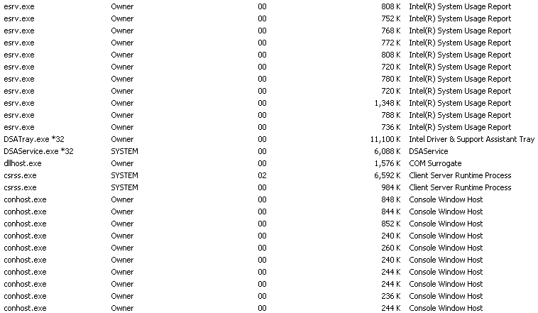

Task Manager shows sixty entries of 'esrv.exe' running
and seventy of 'conhost.exe'
Complete scans by Security Essentials and Malware Bytes both report no malware found
that can't be right...

Wow. How did you achieve all of that! :oldruck:
It should be clear that you shouldn't have so many instances of either esrv.exe or conhost.exe.
I don't even recognize them.
Did they nestle themselves into one of the registry entries I mentioned before or some such? As a result of installing some kind of application?
Anyway, the first thing I'd do is to right click one of them and try to kill it - just to see what happens.

Just looked up 'esrv.exe' and the first hit said:
OK, after some reading you are correct this is not a Sony only issue, that service is also contained in a lot of Intel Software Products, please try this:

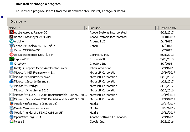

  1. Go to Control Panel (accessible by right clicking your Start Menu button if you are not on the Creators Update, if you are, type Control Panel into Cortana Search)
  2. Open Programs and Features.
  3. Look for Intel Driver Update Utility, if you find it, uninstall it
  4. Reboot
Didn't you say you installed some Intel driver?
I trust products of Microsoft and Intel most, but... maybe we've got to get rid of this particular thingy...

I agree, uninstall the Intel Management stuff, it's useless and consumes resources for no reason.
After that if those processes are still there you can use msconfig to disable the all startup processes and then slowly re enable them to figure out what's causing it.
It's time consuming but will help diagnose any issues you've created by installing 3rd party software or dev environments.

I just uninstalled Intel Utility Update Driver and those two no longer show in Task Manager,
and it's not so sluggish

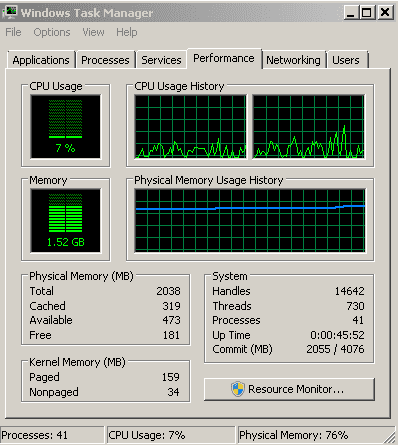

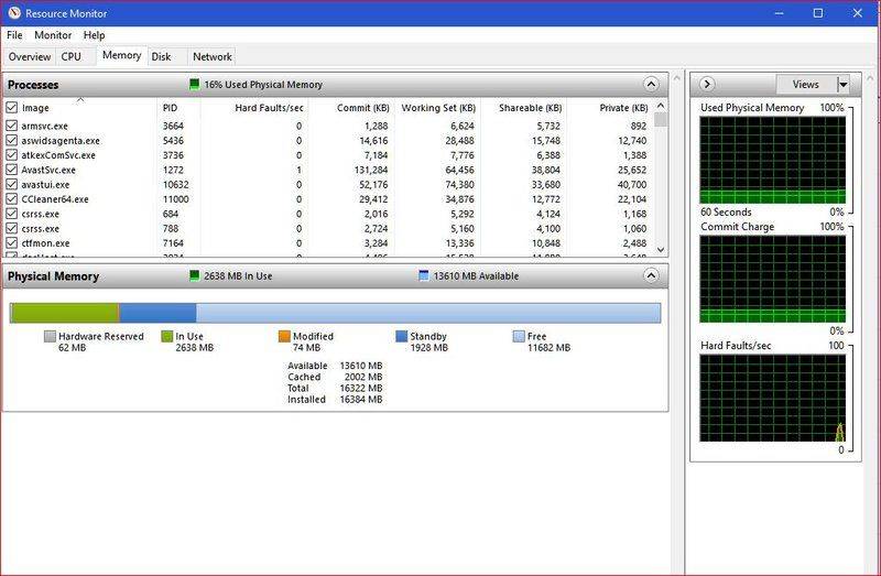

Maybe it needs more RAM ? How much do you guys find being used, nothing running but Firefox on PF.?

  • #60
That looks about right, windows tends to allocate about half the available memory for processes, but 2 gig is simply not enough in todays environments.
4 is the max for 32 bit OS's, 8 is a good working size for 64 bit OS's.
I've got 16 gig installed and my machine tends to run at about 6 gigabytes all the time.
It's showing you have plenty of spare RAM for running just Firefox.
No need to add more RAM unless you are planning to run other apps as well.

Yep. I'm a bit surprised by the physical amount of memory of 2 GiB - low as it is - but it doesn't appear to be a problem based on the graphs and numbers you've shown. :)

Thanks folks - with esrv and conhost running multiple copies all memory was used up .
This machine is several years old now. i think i got it Summer of 2010 and 2G seemed a lot back then.
So it looks as if uninstalling Intel Update whatever it was cured part of my problem
and a few more memory sticks should help

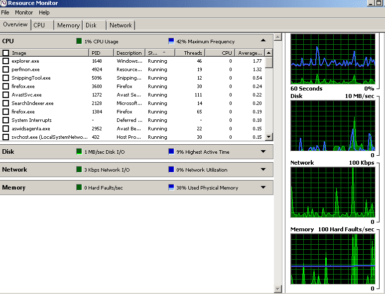

  • #65
Idyit said:
Use the resource monitor if you want to see what happens with limited memory, you'll be getting page faults constantly.
Much of it is Greek to me
have an Acrobat document open at the moment as you see
Seriously guys, THANKS .
old jim
  • #66
No worries, and yes updates are worthy all the vulnerabilities that are patched on a regular basis makes it very worthwhile.
It's the hard fault graph that's of interest, you'll find on low memory systems it goes through the roof everytime you try to do something, and that means memory swapping to the hdd so the OS can do something.

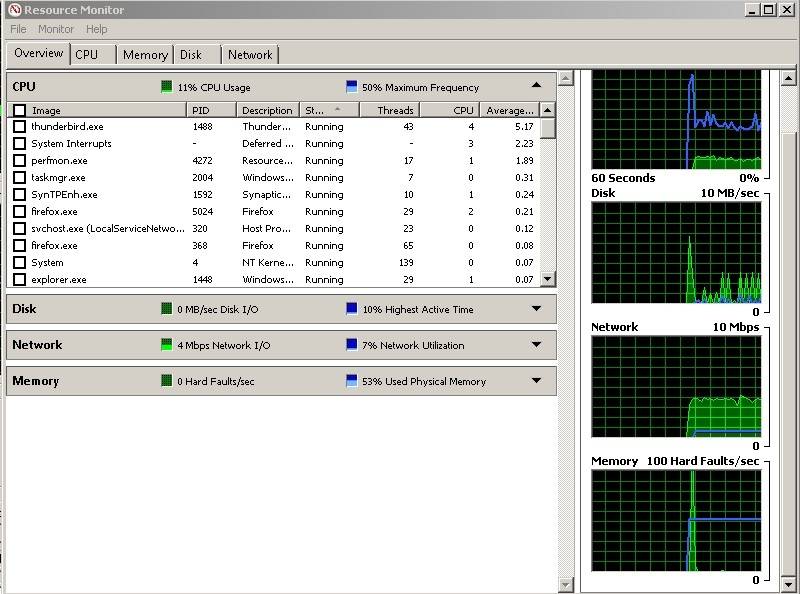

  • #75
Yeah, me too... mine's a lot different than yours though ?
So is my Task Manager... after this latest update, it shows the GPUs.
Windows 10 -- Version 1709.

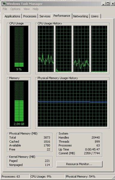

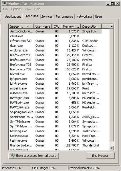

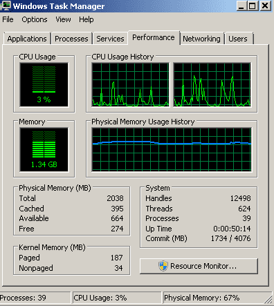

Laptop is back home now with afresh install of Windows 7.
Here's what 2 more G of ram does
sigh now have to fix touchpad driver to disable tapping and a few other things...
  • #78
Seeing the scrollbar as it is suggests to me that you still have way too many processes running.
I have Windows 7 as well, but I have way less - and I have both Firefox and Chrome running.
Either way, I'm not surprised if 2 GiB more memory over 2 GiB will improve your user experience (I have 8 GiB myself privately and 16 GiB at my job - and at my job I need it).

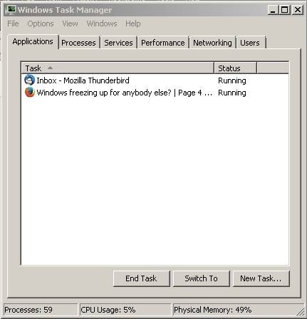

Actually, your dialog looks more primitive than I'd expect from Windows 7.
How did you get that dialog?
If I use Ctrl+Alt+Delete to bring up the task manager I get:
https://www.dropbox.com/s/951d296c9llnbvx/taskmanager.png
(Tried to insert it as an image, but that doesn't seem to work anymore - not sure why.)

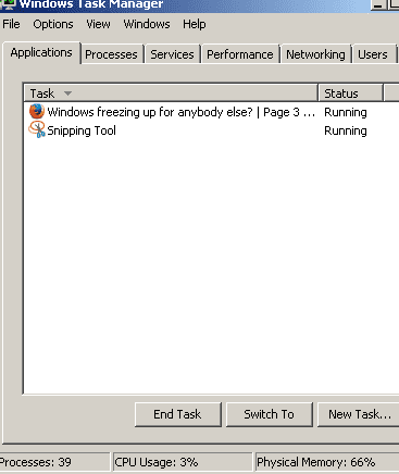

  • #80
Control-Alt-Delete then 'start task manager'
gives this , i selected it part screen so it wouldn't get shrunk unduly when posted here
them selecting 'processes' gives this horrendously long list of heaven knows what
'Services' gives this equally chaotic pile
'Performance' yields this
and 'resource monitor' brings up the one you asked about
Any of them can be expanded to full screen

  • #81
Ah okay.
It looks as if you're using some kind of 'retro' theme, which doesn't really matter.
Your list of processes looks okay after all.
And it looks like you made a good choice to increase the memory to 4 GiB.

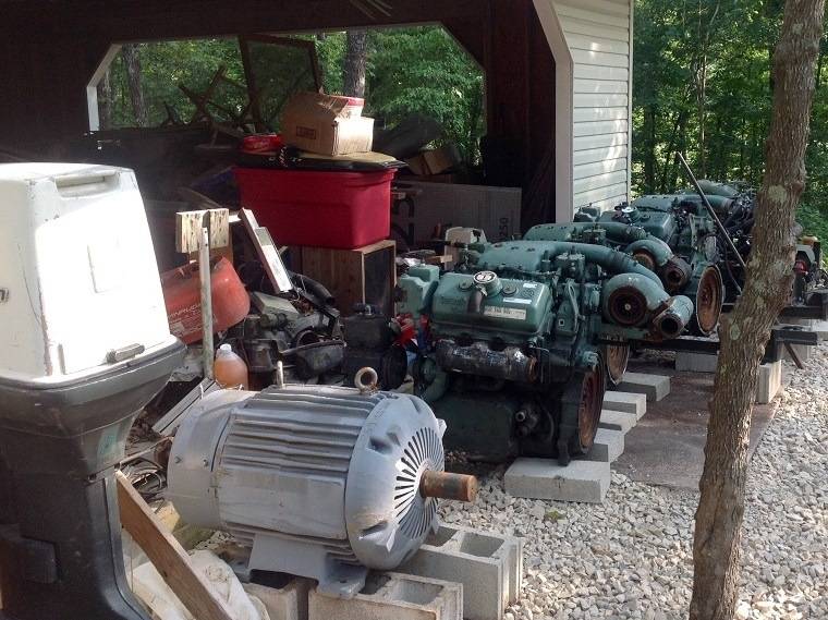

And i was raised in the "waste not want not' era . Everywhere i look is some interesting machine i have rescued 'to fix up. '
to wit: engines for son's boat project
Detroit Diesels for 30 cents a pound - who could pass that up ?
and a wound rotor 3 phase induction motor (it was 7 cents a pound)
and a classic 3 cylinder Johnson outboard
and a Porsche engine in there someplace
'Tis a fine madness though.

I understand that Systems folks always blame the user and users always blame the operating system. It's human nature to mistrust whatever is unfamiliar to us..
Actually I'm real careful to NOT let stuff install. If that's a requirement of some page I'm looking at i just close the window and forego it.
when something sneaks in i uninstall it.
and i run frequent virus scans.
Here's what's on this machine (hmmm id forgot about the time i tried djvu, it'll be uninstalled in a few minutes)
Windows Ten DID sneak in and self install one night but i was able to make it go back to this 7 I'm running now..

Comparing its performance with 4G of memory to this desktop's with 2G makes clear the effect of that extra RAM.
I can see on Resource Monitor the difference in disk traffic just loading PF pages .

1. a corrupted Intel display driver that, to fix, required downloading and installing another Intel program with a bug that caused my ESRV issue.
Uninstalling that one cured ESRV and freed up about a half-G of memory, which on this machine is 25%.
2. Not enough memory. Some recent Windows update makes it need more memory than i have. Since fixing ESRV issue It limps along running on a restore point from before that update ,
when my local shop opens Monday and i get more RAM i'll perhaps let Windows update again...
Will see if i have enough slots for 8G.

Oh, I didn't realize you only had 2GB of RAM. Windows 7 generally requires a minimum of 4GB to run smoothly and Windows 10 needs a little more. So if you are going to buy more RAM, I think it would be helpful.
Likes jim hardy
