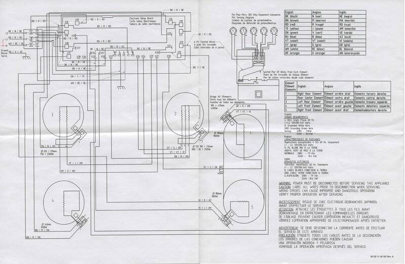

Wiring 4 wire US 120V/208V-240V ceramic cooktop to 230V EU outlet.

How to wire a 120V/208V-240V US cooktop to 230V EU outlet? Thanks for your valuable feedback.
Welcome to PF.
Unfortunately, your schematic is unreadable. That may be a website conversion problem. Check your original.
The international standard is 230 volts for single phase.
A cook-top wired for 240 volt, should run on the EU 230 volts without a problem.
Connect the ground and neutral, then tie L1 and L2 together to active.

My question is about the neutral (white) wire. Do I wire it together with L1 (red) or L2 (black) wire to the EU phase?

I would need to read the unreadable schematic, to determine the way it should be wired in the 240 volt mode. Is there some text on the schematic that identifies the 240 volt mode.

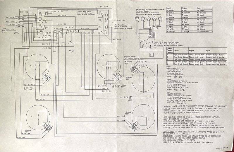

Is it still unreadable?

Neither, and what you want can’t be done.
In North American household wiring there are three voltages available: +120, -120, and 0/neutral. This is done by center-tapping a nearby 240V output transformer and running three wires to the house. The 120 volt outlets are wired to one of the two hot legs and neutral; 240V outlets are wired to the two hot legs which are 180 degrees out of phase so 240V apart.
Four-wire appliances have components that operate on 240V and others that require 120V; the outlet is wired to all three available voltages. Either hot leg will be at 120V relative to neutral and 240V relative to other. (The fourth wire is of course the safety ground, which should never carry current).
You only have two conductors 240V apart so no way of also providing 120 to your appliance. You will not be able to use it.

I have an oven by the same manufacturer Thermador. Connected the neutral white wire to a step down transformer and it works just fine. The cooktop however has no motors whatsoever. There’s a signal transformer that operates at 120V/240V to 12V.

It may be that the "120V/208V-240V US cooktop" needs different resistive elements installed for the different voltage regions.
That is certainly possible, but if so I would expect it to come with specific instructions about how to adapt it for European operation, and it would be unusual to have designed it for four-wire operation in the first place.

We are closing this thread because the answer to the question in the original post is that there is no safe way of doing what they want, and further discussion will run afoul of the forum rule prohibiting dangerous activities.
Further discussion of American 240/120 wiring should be in a new thread - it’s interesting and important but not directly relevant to the original post.
