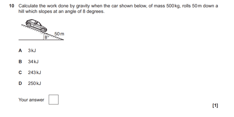

Work done by gravity on a car rolling down a hill
The discussion centers on calculating work done by gravity on a car rolling down a hill, with a focus on the formula E = F x cos(θ). A participant mentions obtaining 243 kJ but questions the values used for force (F), distance (x), and angle (θ). The conversation suggests that using the work-energy principle, W = ΔE_P, is more appropriate for this scenario than the traditional formula. Additionally, there is a query about the specific distance represented by 50 cos(8°) m in the context of the problem. The thread emphasizes the importance of correctly applying the relevant formulas to accurately determine the work done by gravity.
physicsmaster123
Thread moved from the technical forums to the schoolwork forums
I tried E =Fxcos0 but only ended up with 243kJ
What values of ##F##, ##x##, and ##\theta## did you use and why?
Hint: What is the textbook definition of ##\theta## in the formula you stated?
What distance in the diagram is ##50\cos(8°)##m?
Specific to this exercise, ##W=\Delta E_P## is a better fit than ##W=Fd\cos \theta##
