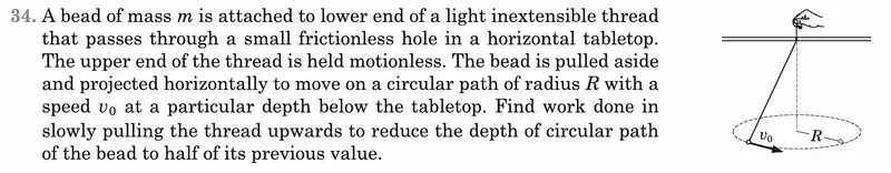

Work Done in slowly pulling a thread
  • Thread starter Thread starter Bling Fizikst
The discussion focuses on the work done by an external agent in pulling a thread, which reduces the depth of a circular path while maintaining the relationship between radius and velocity. Participants explore the implications of the work-energy theorem, noting that the kinetic energy change is negligible due to the slow process. They derive relationships involving tension, radius, and depth using force equations and conservation of angular momentum. The conversation emphasizes the need to account for the tension's vertical component, which performs work and affects the system's dynamics. Ultimately, the participants aim to find a clear expression relating the radius of the circular path to the vertical depth.
Bling Fizikst
119
ok
ok
Say some external agent does the above work ##W_{\text{ext}}## , say the inital depth was ##h## , then final depth ##=\frac{h}{2}## . Now , we don't know the radius of the new circular path , as well as the new velocity of the particle . Employing the work energy theorem : $$W_{\text{ext}}-mg(h/2)=m\frac{v^2}{2}-m\frac{v_{\circ}^2}{2}$$. I think i am unable to exploit the fact that the process was done slowly and the change in kinetic energy during that process ##\approx 0## . Also , since there doesn't seem to be any non zero external moment so we can write $$\triangle H_{O/I}=0$$ where ##O## is the center of the circular path at all times . THis means $$mv_{\circ} R=mvr$$ . Stuck here .
Can you find an expression that relates the radius ##r## of the horizontal circle and the vertical "depth" ##h##?
Hint: Draw a free body diagram of the bead.

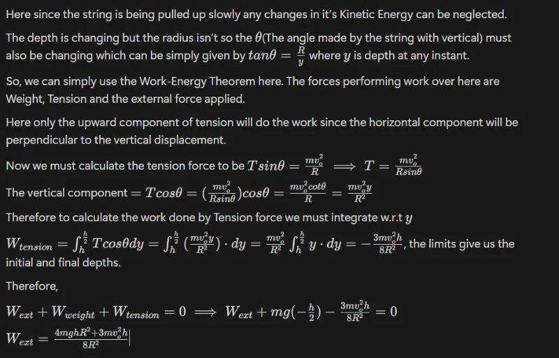

Based on the above discussions , i wrote a general relation for ##v,r,\alpha## : $$T_x=T\sin\alpha=\frac{mv^2}{r}$$ $$T_y=T\cos\alpha =mg$$ From here , $$\tan\alpha=\frac{r}{y} =\frac{v^2}{rg}$$ $$\implies y\equiv y(r,v)=\frac{r^2g}{v^2}$$ Now , if i were to compute $$\int \vec{T}\cdot \vec{dy} =\int T_y dy=mg\frac{h}{2}$$ . Not sure what to make of this , all these are functions of ##(r,v)##. And yeah , idt you use the ##\tan\alpha## relation as it changes corresponding to the change in ##r## and ##y## , it ain't fixed imo . @erobz
I actually then used conservation of angular momentum about ##O## : $$mv_{\circ}R=mvr\implies r=\frac{v_{\circ}R}{v}$$ Using this in $$\frac{h}{2}=\frac{r^2g}{v^2}$$ We can find $$v^2=\sqrt{2}v_{\circ}^2$$ From the work energy equation , i wrote first : $$W_{\text{ext}}= m\frac{v^2}{2}-m\frac{v_{\circ}^2}{2} +mg\frac{h}{2}$$ Using the fact that ##h,v## are known we substitute it's values in terms of the known parameters to find : $$W_{\text{ext}}=\frac{mv_{\circ}^2}{2}\left[\frac{g^2R^2}{v_{\circ}^4}+\sqrt{2}-1\right]$$
The limit shall be from h to h/2 because while calculating the work done by variable forces, we perform a line integral as the limit goes from the bodies initial position to the final position and not it's displacement
You are right , but here ##mg## is a constant force .
yes but the exernal forces acting is variable and depends on y
Here you have considered T_y to be equal to mg, but it's not, because if that had been the case, then the vertical ascent of the bead wouldn't have happened
I just used work energy theorem which includes ##W_{\text{ext}}+W_{mg}=\triangle KE## , all i need is ##W_{\text{ext}}## . Morever , i don't even think you can find tension in that way explicitly . So , yeah just ignore that work done by tension thing , it's useless imo .
Actually you also need to consider the tension force since, it's vertical component is performing work. I have posted the solution in one of my replies you can check it`

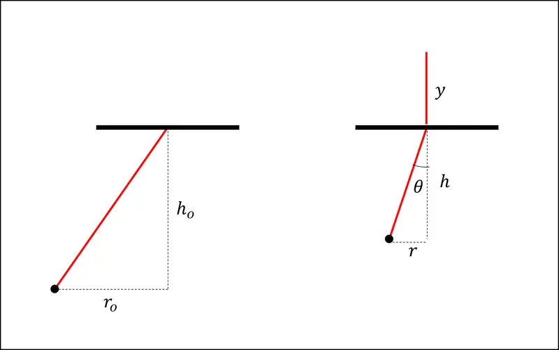

Inextensible Rope Constraint:
$$ y = L - \sqrt{R^2 + h^2} $$
Again, eliminate ##R##. Take the derivative## \frac{dy}{dh}##:
When you put ##T## and ##dy## in the integrand you can massage the integrand to cancel the factors involving the root in the numerator of ##T##, and the root in the denominator of ##dy##.
The result looks pretty clean to me.
I now see that the expression for ##T## and ## \tan \theta## aren't correct in post 3. those should be instantaneous velocity of the bead ##v##, not ##v_o##.
$$ T = m\frac{ \sqrt{v^4 + R^2 g^2}}{R} $$
$$ \tan \theta = \frac{R}{h} = \frac{v^2}{Rg} $$
They did correct the expressions in post no. 17.
But I still think it's ok because of the conservation of angular momentum relationship ## m v_o R_o = mv R ##, I'm sure it is more manipulation. I haven't re-done the integral though, it might be a mess as @haruspex says.
By combining:
$$ T \sin \theta = m \frac{v^2}{r} $$
$$ T \cos \theta \approx mg $$
$$ mv_o r_o = m v r $$
$$y = L - \sqrt{h^2 + r^2}$$
I get the following relationships in terms of the instantaneous height ##h##:
$$ r = \frac{\sqrt{g} v_o }{g} \left( h_o h \right)^{1/4}$$
$$ v^4 = v_o^4 h_o h^{-1} $$
Differentiate ##y## w.r.t. ##h## ( after substitution for ##r##):
$$ dy = -\frac{1}{2} \left( h^2 +\frac{v_o^2}{g}( h_o h )^{1/2} \right)^{-1/2} \left( 2h + \frac{v_o^2 h_o^{1/2} }{2g} h^{-1/2} \right) dh $$
$$ T(h) = \frac{m \sqrt{ v_o^4 h_o h^{-1} + v_o^2g ( h_o h)^{1/2} )} }{ \frac{g^{1/2}}{g} v_o ( h_o h )^{1/4} } $$
The work would in going from ## h_o## to ##h_o/2##:
$$ W = \int T dy = -\frac{1}{2} \int_{h_o}^{h_o/2} \frac{m \sqrt{ v_o^4 h_o h^{-1} + v_o^2g ( h_o h)^{1/2} } }{ \frac{g^{1/2}}{g} v_o ( h_o h )^{1/4} } \left( h^2 +\frac{v_o^2}{g}( h_o h )^{1/2} \right)^{-1/2} \left( 2h + \frac{v_o^2 h_o^{1/2} }{2g} h^{-1/2} \right) dh $$
So its a wildfire of an integral...
