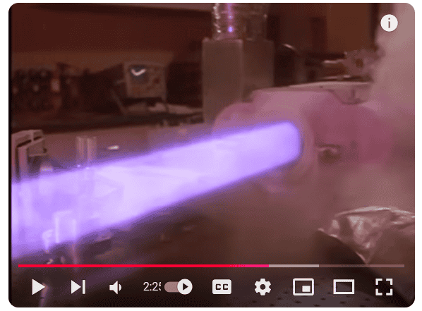

So basically, instead of using large complex pumped lasers, we use chemical lasers that have insane power output. They are used to fuse a fusion pellet. The excess energy is collected and part of it is used to prepare the next batch of chemicals needed to run the laser. What would be the problems with that design and how could you design it better.

You need extremely short high intensity pulses that can be focused on a tiny target. Chemical lasers are not a good choice for that.

Are chemical lasers not known for their high power output?

I remember reading an article about how the UK is developing chemical lasers as anti missile systems
