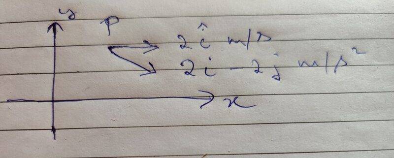

A particle P, as shown in diagram below, is moving at a velocity of ##2 \hat i \, {m/s}## at time ##t=0## under a constant acceleration of ## 2 \hat i - 2 \hat j \, m/s^2 ##. Would the particle move in a circular path? Provide explanation.
## F_c= \dfrac {mv^2} {r}##
## a_t= \alpha r##

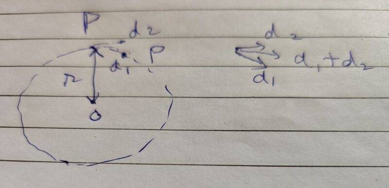

At t= 0, we can see that the particle P has a radial acceleration of ##-2\hat j## and a tangential acceleration of ##2 \hat i##. The radial acceleration will tend to move it in a circle of a certain radius, whereas the tangential acceleration will tend to displace it parallel to x- axis.
Consider a very small interval of time after the time t = 0. At the end of this very small interval of time, the vector sum of above two displacements is not going to be on a circle as shown in diagram below. In this diagram, the displacements due to tangential and radial accelerations are shown as ##d_2## and ##d_1## respectively after a very small time interval from t = 0. We can see that net displacement is going to place the particle slightly above the circular path and therefore, the particle will not move along a circular path.

It doesn’t specify a circle about the origin.
In my diagram, O is the center of a circle that would be traversed if there was no tangential acceleration. So, O is not the origin of the x-y axes system.
if the force is such that it would make the particle move in a circular path, then it should verify$$|\mathbf F|=\frac{m|\mathbf v(t)|^2}{R}$$suppose that you already know ##m## and that there is such an ##R##. you are given ##\mathbf F(=m\mathbf a)## and you can deduce ##\mathbf v(t)## from the given data.
is that equation verified?
Then I do not understand your diagram.
You define ##\vec d_1, \vec d_2## as radial and tangential accelerations about some presumed centre, but you do not show them as perpendicular.
vcsharp2003 said:
The constant radial acceleration
It is given as a constant acceleration, not as a constant radial acceleration.

haruspex said:
You define d→1,d→2 as radial and tangential accelerations
These are displacements due to tangential and radial accelerations.
Yes, that is true and my mistake.
But since I am considering a very small interval of time, I am showing the full circle along which a very small arc of particle's trajectory would lie due to acceleration perpendicular to its velocity at time t= 0.
I have corrected this in my original post.
One difficulty with supposing a small interval of time is that you are starting with accelerations, so one level of such integration gives velocity change, not displacement.
Another is that you need to be careful to ignore second order small differences, or you may wrongly conclude the path cannot be circular.
I think there is a much easier way to answer the question. If the acceleration is constant, what can you say about its distance from some given point over the long term?
You mean get ##\vec {v(t)}## by integrating ## \dfrac {d {\vec v}} {dt} = 2 \hat i -2 \hat j## and then get position vector at a time t ##\vec {s(t)}## by integrating the velocity equation.
If it's one dimensional motion, then constant acceleration would cause distance from a given point to increase over a long term. But, I am not sure if the same occurs in two dimensional motion.
As far as I can see, your original post still shows a constant acceleration. What should it show?
In this 2 dimensional motion scenario, we could consider the acceleration component along x-axis separately from acceleration component along y axis, since for any vector we can consider it's components instead of the original vector.
x axis: The acceleration is + 2 m/s2.
y axis: The acceleration is -2 m/s2.
So, we can say that distance from its position at t=0 is going to increase as time increases. So, if we take an arbitrary point in x-y plane, then after some very large interval of time the distance of particle P would be increasing from this arbitrary point.

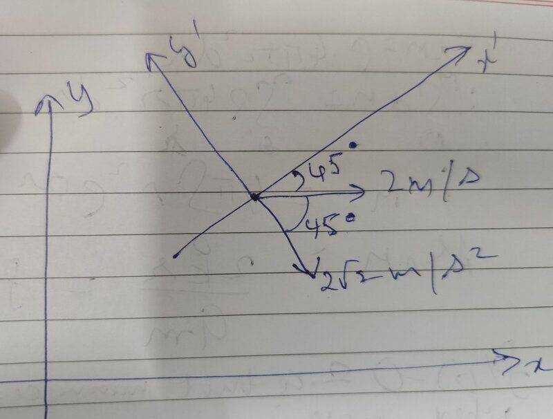

Doc Al said:
Define a new set of axes (x', y') that are at an angle with respect to x,y so that the acceleration is in the y' direction. Then the trajectory in that coordinate system will be familiar.

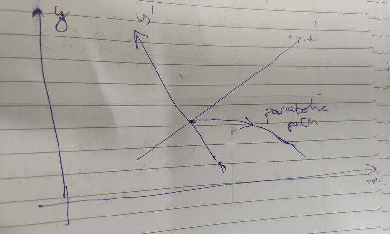

I have used a new rotated system of axes x'-y', and then there is no acceleration along x' axis and a constant acceleration in negative y' axis direction. The case then becomes like a projectile motion under gravity with particle thrown down at 45o to vertical. We would then end up with a perfect parabolic path in the x'-y' axes system.
Therefore, the trajectory of the particle will not be a circular path in the x-y axes system. The distance of particle P from its postion at t= 0 will keep on increasing with time due to its parabolic trajectory.
Actually, any two dimensional motion with constant acceleration and an initial velocity that is not parallel to constant acceleration, can be analyzed in this manner and will always follow a parabolic path in a rotated axes system.
Therefore, the trajectory of the particle will not be circular path in x-y axes system.
Good! Switching to the x'-y' axes allows you to immediately recognize the trajectory as a parabola.
