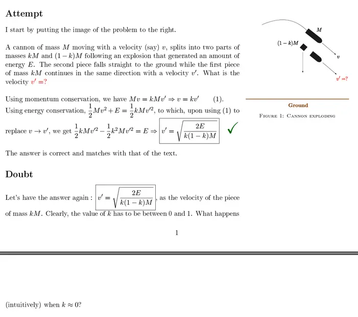

The wrapfigure environment in ##\rm{LaTeX}## is leaving the text curtailed, long after the figure (image) has ended. The remaining text of the article is now permanently short from the right hand side, to the extent to which the wrapfig environment was defined using the \textwidth option. While the left hand margin remains, the right hand margin has shrunk to the defined dimensions of the environment (wrapfig). Details are below.
Problem :
I copy and paste the image of the problem to the right.
I put the wrapfig environment before the section marked "Attempt" in order to bring the image as high up as possible.
As you can see, the following section (titled "Doubt") along with its contents are all curtailed long after the picture has ended along with its caption. The same moves on to the next page.
Code :
I copy and paste the code below.
Code:
\begin{wrapfigure}[10]{r}{0.3\textwidth}
  \centering
    \includegraphics[width=0.3\textwidth]{Problem.png}
  \caption{Cannon exploding}
\end{wrapfigure}
\section*{Attempt}
I start by putting the image of the problem to the right. \\
A cannon of mass $M$ moving with a velocity (say) $v$, splits into two parts of masses $kM$ and $(1-k)M$ following an explosion that generated an amount of energy $E$. The second piece falls straight to the ground while the first piece of mass $kM$ continues in the same direction with a velocity $v'$. What is the velocity ${\color{red}{v' =?}}$\\
Using momentum conservation, we have $Mv=kMv'\Rightarrow v=kv'\qquad (1).$
As you can see, the wrapfig environment was declared and ended before the section titled "Attempt".

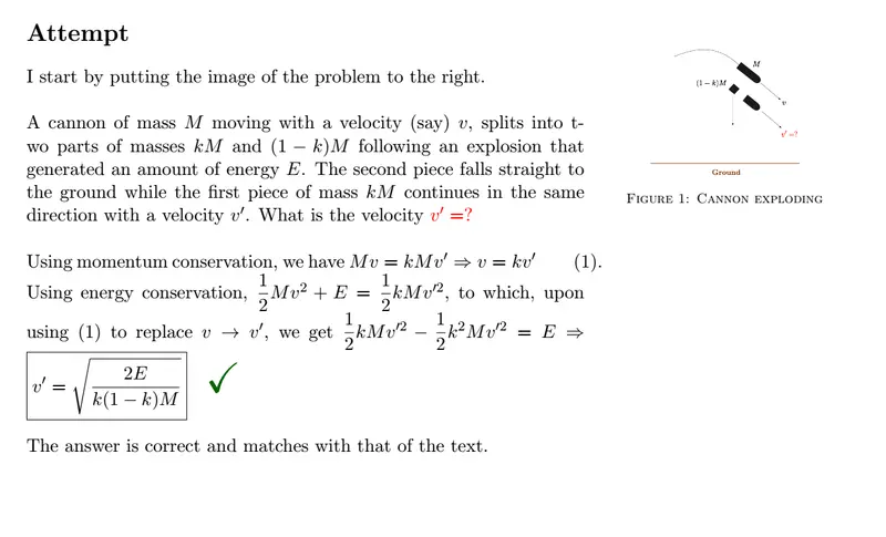

Try changing the textwidth to linewidth in the includegraphic descriptor
Am sorry it didn't help.
Here's the code :
Code:
  \centering
    \includegraphics[width=0.6\linewidth]{Problem.png}
\end{wrapfigure}
\section*{Attempt}
Worse, if you're there @jedishrfu, I'd like you to see what came up later. The text came over a second image I put below using Wrapfig.

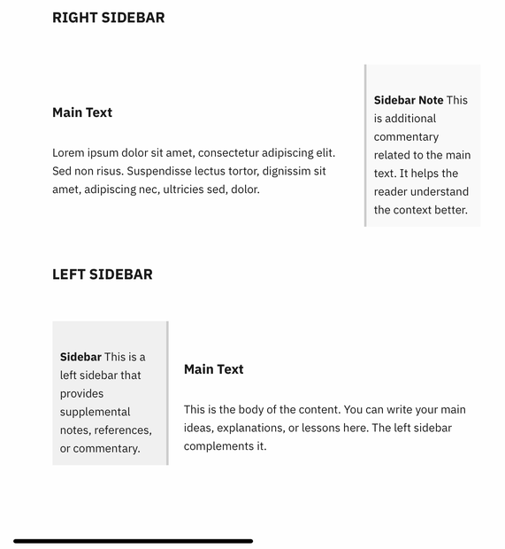

Yes, I know the feeling. I use iaWriter for markdown documents and wanted to have sidebars but markdown has no facility for that construct. However I found an example where someone added html to their markdown document to create them and that was enough for my needs.
**Notice how I had to embed html within the markdown to get it to work.
Markdown (GitHub flavored):
# RIGHT SIDEBAR
<div style="display: flex; align-items: flex-start; gap: 20px;">
<div style="flex: 3;">
<p>
## **Main Text**
Lorem ipsum dolor sit amet, consectetur adipiscing elit. Sed non risus. Suspendisse lectus tortor, dignissim sit amet, adipiscing nec, ultricies sed, dolor.
</p>
</div>
<div style="flex: 1; background-color: #f9f9f9; padding: 10px; border-left: 3px solid #ccc;">
<p>
**Sidebar Note**
This is additional commentary related to the main text. It helps the reader understand the context better.
</p>
</div>
</div>
# LEFT SIDEBAR
<!-- Left Sidebar -->
<div style="flex: 1; background-color: #f0f0f0; padding: 10px; border-right: 3px solid #ccc;">
<p>
**Sidebar**
This is a left sidebar that provides supplemental notes, references, or commentary.
</p>
</div>
<!-- Main Content -->
<p>
## **Main Text**
This is the body of the content. You can write your main ideas, explanations, or lessons here. The left sidebar complements it.
</p>
</div>
</div>
