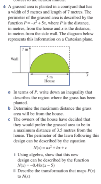

I do not know how to start thinking about part a and then got even more confused when I saw the answer be:
P<x^2-5x.
I ask for your guidance please.

The problem is rather misleading since the perimeter upper edge follows the path of the parabolic curve $P = 5x-x^2$ for values $0 \le x \le 5$. The sketch shown looks more like a semicircle (why, I don't know). See the attached graph for a better depiction.
Since grass is planted below the edge defined by that parabola, then the planted region, $R$, is located under the curve that defines the upper edge and above the x-axis ... that is $0 \le R \le P = 5x-x^2$. So I do not agree with the inequality you stated, $P < x^2-5x$.
Are you able to answer the remaining questions?
