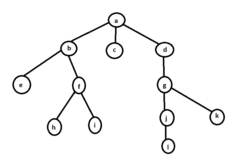

Suppose that we have, for example, this tree:

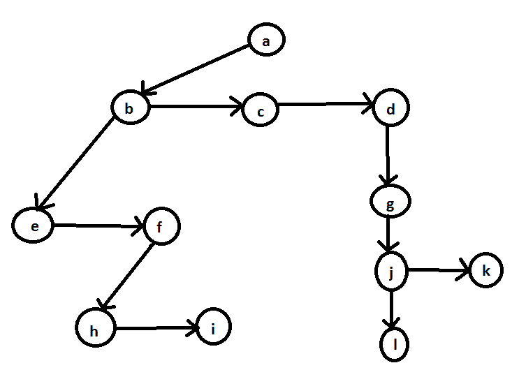

Could you explain me how we found this binary search tree:
in order to make operations at the first tree? (Thinking)

If we have a tree like the second one, we can convert it into the binary tree that is shown first. (Wasntme)

A ok.. (Nod) But, could you explain me how we can do this? (Thinking)
Well, we start with an ordered tree, which is not binary, as in your example where the root has 3 children.
Then we keep the link of each node to its leftmost child, and we remove all other child links, replacing them by sibling links.
Presto! An ordered binary tree. (Whew)

So, do we conclude the following? :confused:
I like Serena said:
If the root has any nodes connected to it, it's not a leaf, but an internal node.
The connected nodes are the children of the root, which are each at depth 1. (Thinking)
The node a is not a leaf.
I like Serena said:
If any child has nodes connected to it other than its parent, it's not a leaf, but an internal node, and those nodes are in turn its children, which have a depth that is 1 greater. (Wasntme)
The node b is the only child of a.
The nodes c,e are not leaves, and also they are children of b.
I like Serena said:
Any child that has no other nodes connected to it other than its parent, is a leaf.
It has a depth that is 1 greater than its parent. (Nerd)
The only leaves are k,l,i.Or have I understood it wrong? (Worried)

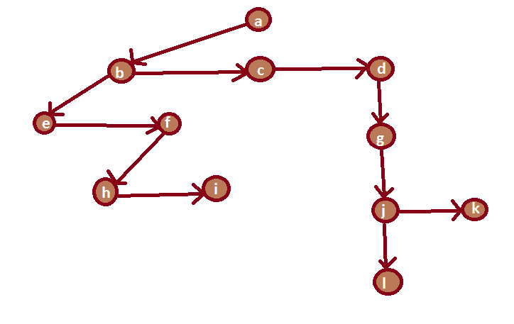

I think I detect some confusion on your part. Here's a tree:
Now here's the associated binary tree:

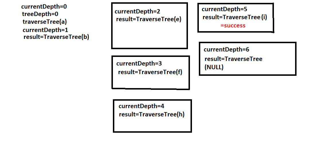

What might we do when we are in the final case of the recursive function? (Wondering)
When we have, for example, this tree:
we call the functions [m]traverseTree(a,depth), traverseTree(b,depth+1), traverseTree(e,depth+2), traverseTree(f,depth+3), traverseTree(h,depth+4), traverseTree(i,depth+5)[/m], right? But.. what do we do after the command [m] return; [/m] , that is executed at the function [m]traverseTree(i,depth+5)[/m]? (Worried)
Right. (Smile)
And btw, the depth is initially 0, so the initial call is actually [m]traverseTree(a, 0)[/m]. (Nerd)The first time we get to the [m]return[/m], we need to register the depth.
Every other time, we need to check if the depth is the same as the one we previously registered. (Thinking)

So, if we want to trace the algorithm, I tried the following:
Is it right? If so, how could we continue? (Sweating)
  • #42
That looks right, although I think the success should be at depth 6.
At that point, we store the currentDepth in treeDepth.
And then we go back up, and then down into the next child.
Or rather, we keep backing up, until we can go down again. (Wasntme)
