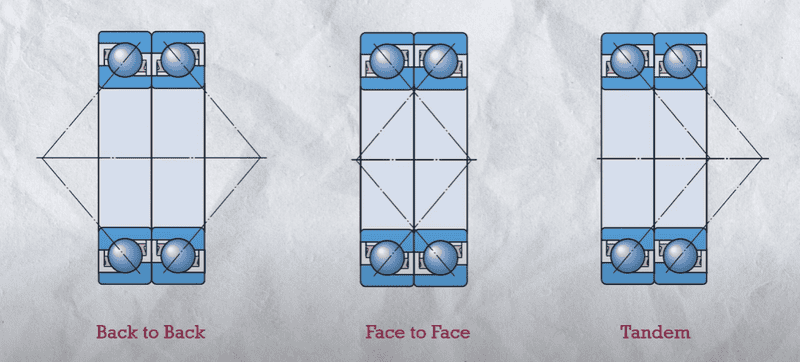

The title mentions angular bearings although the concept applies to tapered bearings as well.
They can be assembled in different configurations which results in different properties.
(Picture from this video although the pictures I think are from SKF)
The support span (it might also be called with other terms but that's how I found it described on this page) is very important for bearings. For the 3 configurations, the tandem will have the same support span as "straight" bearings, the back-to-back or O configuration will have the greatest, and the face-to-face or X will have the smallest (even negative as in that picture?).

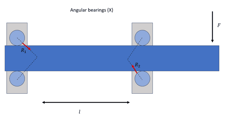

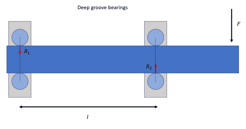

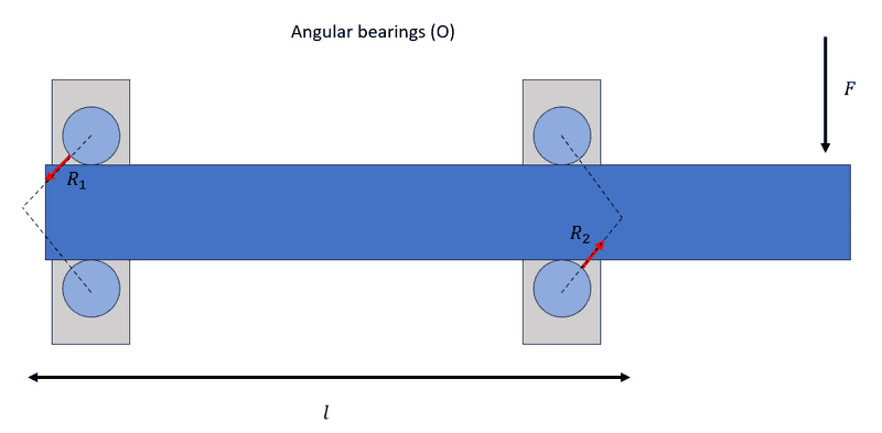

I tried using a free-body diagram which clearly shows how the support span makes it more rigid in the case of deep groove bearings or other "straight" bearings but I don't see how the angular bearings change the support span.
In the previous picture, it's evident that by increasing the distance between the bearings, the support span increases which gives the assembly more leverage to counter input forces so it'll be stiffer.
I tried doing a similar diagram with angular contact bearings and I don't see how the equivalent support span grows or shortens depending on the angle of the bearings. The implication is that it is equivalent to "straight" bearings being placed at a different location but I don't see why.
Does it just fall out from the algebra once the equations of equilibrium are in place?
Also, what would be the implications of an X configuration where the support span is negative because the X crosses as in the previous picture?

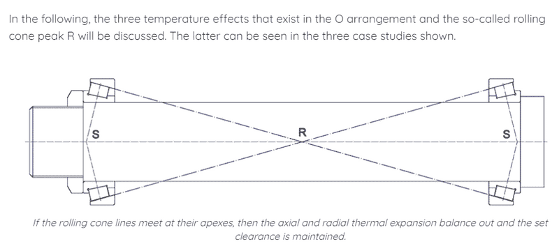

The arrangement is described by the normal to the contact surfaces, but it is the contact surfaces that explain the behaviour and leads to understanding.
The balls cannot move in the direction of the inner or outer race, but they can roll along slightly different tracks between the races.
When the contact surfaces of two separated bearings fall on a common circle, there is room for some variation of the axial alignment about the centre of the circle. To confuse things, that is called the X configuration.
When the contact surfaces of two separated bearings fall on two cones with coincident apexes, there is less available variation of axial movement. To maintain the confusion, that is called the O-configuration.
This part is key. I didn't realize it.
It's even shown in the pictures from one of the pages I linked but I didn't see it that way on the first read.
There it shows an O configuration but there is also a kind of X drawn which can lead to confusion. At least, it confused me.
