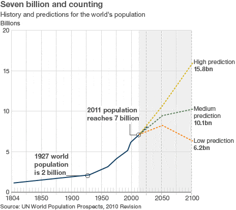

are you suggesting that the population of the Earth will simply level out?
Yes, that is the expectation.
Regarding the US, the internal propulation growth is already flat: The US gains population mostly because of immigration.

So, the derivative of population is negative? Or the second derivative is negative...
Well, I think we've already passed that point. The Earth was not meant to feed 12 billion people, as it will have to in the next fifty years...

  • #564
2nd is negative, i.e. the growth of population is slowing down; has been for some decades.
  • #565
mheslep said:
Again I spoke to rates of growth, not to growth. The rate of world population growth has clearly decreased over the last 60 years, an indisputable fact. In some developed countries, the rate is actually negative.
Wiki will do for now:
http://en.wikipedia.org/wiki/World_population
Regarding developed and developing countries, here's China, with a clearly decreasing rate:
http://www.google.com/publicdata?ds...=-315619200000&tunit=Y&tlen=48&hl=en_US&dl=en
Japan's population peaked in 2005
http://www.google.com/publicdata?ds...d+population#met=sp_pop_totl&idim=country:JPN
Similar for Germany:
http://www.google.com/publicdata?ds...d+population#met=sp_pop_totl&idim=country:DEU
