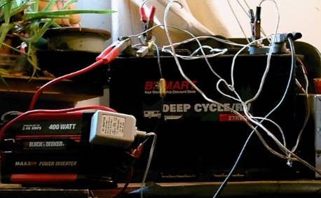

To be more precise, the sun does not shine on photovoltaic cells at night (local night for the photovoltaics). At least not in any relevant amount. And clouds give a similar problem.
Hence the deep cycle battery sitting in my living room.
ps. It's really only there to keep the crack heads from stealing it out of my boat. I cycle it lightly through the winter month by powering my xmas lights.

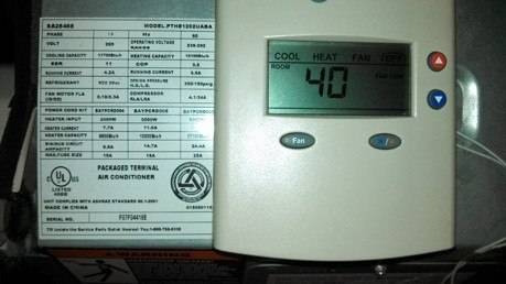

Perhaps we need to take a closer look at the little things we may be missing. I spent three days in the same motel recently. This was unusual because I am usually arriving after dark and leaving early in the morning.
It was a typical mid priced motel. The A/C units were the typical through the wall heat pumps mounted under the window. I sat in a chair reading a magazine in the early afternoon and noticed that the A/C would run about three minutes then go off for about two minutes.
I immediately spotted the reason, the blasted air was blowing up behind the window curtains, then dropping back down and into the return. The curtains came down to the top of the A/C. I pushed the curtains back and set a book in front of them.
Now the unit ran for fifteen minutes straight and shut down for 18 minutes.
The units also need better insulation between the condenser (outdoor) section and the (interior) evaporator section. I say this because in the morning when the sun hit the east facing condensers the units would kick on for short runs. I walked around to the west side of the building in the afternoon and the same thing was happening.
The sensors for the thermostats were located in the return air stream. This wouldn't need a rocket science fix. The 50 room motel is only two years old.
  • #993

  • #995

edward said:
...The sensors for the thermostats were located in the return air stream.
How on Earth do you know that?
google google google
You took it apart.
You were only going to spend one night, but you decided to take the air conditioner apart.
And it took you two days, to put it back together.
:thumbs:
[1] Speculation.

OmCheeto said:
I do believe, I've dug myself a new hole.
Do you still have the shovel?
I only had to pull out the filter and I could peek in and see the thermostat sensor. I believe in the A/C business they are called a feeler bulb:devil:
You took it apart.
No, no, no, I only do that at Luxury hotels with large central air conditioning systems.
  • #997

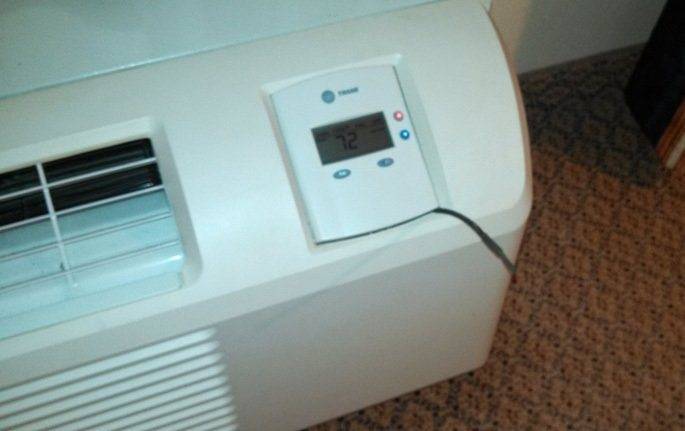

  • #998
OmCheeto said:
Quote by edward
"...The sensors for the thermostats were located in the return air stream."
Ehem:
Before:
After:
You took it apart.
:thumbs:
[1] Speculation.
Can't speak for edward, but I was staying in that hotel room for business and I had some after-hours testing to do at a client's site that was picking-up again in the morning, so I arrived at the hotel at about midnight and wrote the note at quarter after one, to drop off at the front desk when I ckecked-out in the morning.

  • #1,000
russ_watters said:
Ehem:
Before:
After:
Good job fixing that. And your first image confirmed another suspicion I had, as to why edward's air conditioner was so poorly designed, yet were only two years old. They're made in China. What do they care about how efficient they are for the American market. And the contractors who build the hotels probably don't care either, as long as it's the cheapest thing on the market.
Perhaps you should learn Mandarin, or Cantonese, and do some consulting work.
And I can barely make out the refrigerant type from your image. It looks like R22.

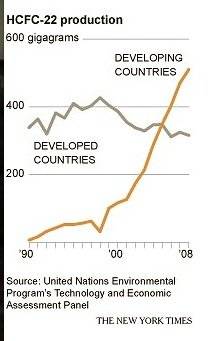

hmmm...
Relief in Every Window, but Global Worry Too
Commercial interests foster the stalemate. Though the protocol aggressively reduces the use of HCFC-22 for cooling, it restricts production on a slower, more lenient timetable, and as a result, output has grown more than 60 percent in the past decade. Even in the United States, HCFC-22 is still profitably manufactured for use in older appliances, export and a few other industrial purposes that do not create significant emissions, like making Teflon.
You would probably understand the article better than I, but it looks like you can buy an R-22 unit here in the states, as long as it doesn't contain any refrigerant when it crosses the border, and fill it up after the fact.
ps. Greg should get ahold of the Hotel Assn. of America, and get us all a deal on hotel rates. It seems PF'ers are really good at fixing poorly designed/installed air conditioners. :-p
