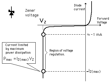

Check out the difference in their IV curves.
http://hyperphysics.phy-astr.gsu.edu/hbase/solids/zener.html"

My fig1
we should start with the current voltage characteristic of a PN junction (diode).
Points to note are that it may be forward biased (C-D-E), reverse bised (A-B-C) or zero biased.
In Portions AB and DE of the curve the junction has broken down and is acting as a conductor. Note both sections look like the curve for a resistor.
AB exhibits avalanche breakdown at sufficient reverse voltage, depending upon the doping.
DE the forward bias is sufficient to boost electrons into the conduction band. this leaves holes in the valence band. Both contribute to conduction.
My Fig2
By increasing the doping of we can reduce the reverse bias point at which B occurs thus creating high value reference diodes.
Further increasing the doping introduces a small tunnel effect as fig 3 creating lower voltage zenere diodes. The next installment will show that the zener and tunnel effects are very similar.
MyFig3
The tunnel diode I - V curve can be seen to be made up from a normal diode characteristic plus the tunnel effect which only occurs over a small range of about 0 - 1 volt. Since the normal diode has almost no conduction in this region the tunnel effect dominates here
The doping is so high that the diode is in breakdown in both forward and revers biase so there is a resistor like line through the origin.
then there is the characteristic tunnel hump which occurs as the forward bias first brings the conduction and valence bands into alignment, then drives them out of alighment again.
It should be noted that only electrons are involved in tunneling. Holes play no part in this.
