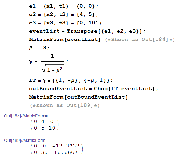

ghwellsjr said:
Wasn't that fun?
Hi ghwellsjr.
Yes, that was fun. I like your problem set-up. We have three major events
e1: departure (x,t)=(0,0)
e2: turnaround (x,t)=(4,5)
e3: return (x,t)=(0,10)
You also have defined another event (x,t)=(0,5), for which (x',t')= (-6.667,8.333). Then you said: "Those numbers don't make any sense at all, do they? But they do if we remember that these are coordinates in a different frame." I totally agree; but there's a lot more to say about that. Why doesn't it make sense. Why does it make sense? How does it make sense? How long is the outbound twin's reference frame relevant to the outbound twin? For only three years. But this event happens at t=8.333 years! How far away is it going to happen? 6.667 light-years from the origin.

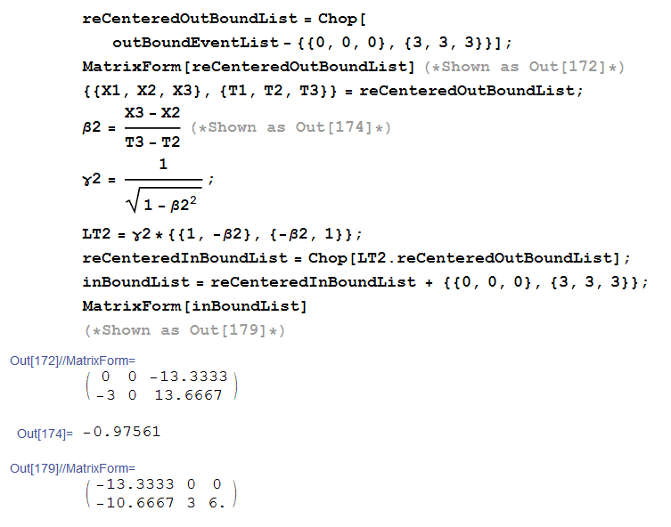

We should also figure out when and where this event happens according to the inbound twin's reference frame.
Here is my calculation of the coordinates of e1, e2, and e3 in the outbound and inbound frames:
e1': departure (x,t)=(0,0)

I was trying to follow along closely with what you did, with a little more matrices.
Here is a line-by-line explanation.
Code:
e1 = {x1, t1} = {0, 0};
e2 = {x2, t2} = {4, 5};
e3 = {x3, t3} = {0, 10};
This defines the original events in the original reference frame.
Code:
eventList = Transpose[{e1, e2, e3}];
(*This puts all of the relevant events into a matrix form:
[tex]eventList=\begin{pmatrix}
0 & 4 & 0\\
0 & 5 & 10
\end{pmatrix}[/tex]*)
Code:
MatrixForm[eventList]  (*Shown as Out[184]*)
(*This simply sent the output. Mathematica hides the output if you use a semicolon, and shows the output if you leave off the semi-colon*)
Code:
\[Beta] = .8;
\[Gamma] = 1/Sqrt[1 - \[Beta]^2];
LT = \[Gamma]*{{1, -\[Beta]}, {-\[Beta], 1}};
This is the Lorentz Transformation Matrix [tex]LT = \left( \begin{array}{cc} \gamma & -\beta \gamma \\ -\beta \gamma & \gamma \end{array} \right)[/tex]
Code:
outBoundEventList = Chop[LT.eventList];
This line performs the Lorentz Transformation. The dot (.) operator does matrix multiplication. The Chop function takes any value that is closer to zero than 10^-15 and zeros it out. It basically gets rid of a rounding error.
Code:
MatrixForm[outBoundEventList](*shown as Out[189]*)
Shows the result of the operation
Code:
reCenteredOutBoundList = Chop[
   outBoundEventList - {{0, 0, 0}, {3, 3, 3}}];
This translates all of the relevant events back in time 3 years (0,-3). Note the minus sign, putting the turn-around event at the origin. The goal here is to go through a process of "translate"-"boost"-"translate back" so that the transformation is done around the correct origin.
Code:
MatrixForm[reCenteredOutBoundList] (*Shown as Out[172]*)
{{X1, X2, X3}, {T1, T2, T3}} = reCenteredOutBoundList;
I'm just preparing, here, to calculate the velocity for the return trip. We have six numbers in the reCenteredOutBoundList, and we want four of them. This is the quick way to get them.
Code:
\[Beta]2 = (X3 - X2)/(T3 - T2) (*Shown as Out[174]*)
This calculates the velocity change needed for the return trip. This is mathematically, exactly the same thing you did. It came out to be the same value that you got.
Code:
\[Gamma]2 = 1/Sqrt[1 - \[Beta]2^2];
LT2 = \[Gamma]2*{{1, -\[Beta]2}, {-\[Beta]2, 1}};
This finds the Lorentz Transformation matrix needed for the return trip.
Code:
reCenteredInBoundList = Chop[LT2.reCenteredOutBoundList];
inBoundList = reCenteredInBoundList + {{0, 0, 0}, {3, 3, 3}};
This adds three to the hour on all of the events. This is the third step in "Translate"-"Boost"-"Translate back"
Code:
MatrixForm[inBoundList] (*Shown as Out[179]*)
That gives the relevant event coordinates in the final frame.

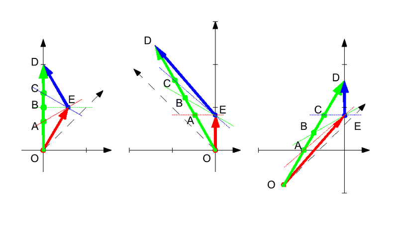

Here is a space-time diagram created by WWoods for Wikipedia's Twin Paradox Article.
You can see discussion of that here:
here, here, and here
WWoods did a good job at picking out the events A, B, and C. B is simultaneous with the turn-around event in the home-frame. A is simultaneous with the turn-around-event in the outbound frame, and C is simultaneous with the turn-around event in the return-bound frame.

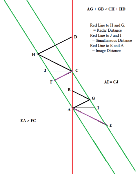

The only problematic thing about "spatial distance" in SR is that there are multiple meanings for it.
"Radar Distance"
"Simultaneous Distance"
"Image Distance"
The confusion mostly lies in not distinguishing between the meanings.
Dolby Gull are calculating Radar Distance.
WWoods, and Mike Fontenot are figuring out Simultaneous Distance.
For stellar aberration, and superluminal jets, you work with image distance.
The point is, they are all compatible if you say what you mean, but there is a lot of argument because people all think their meaning is "the best" meaning, or "the only" meaning.
