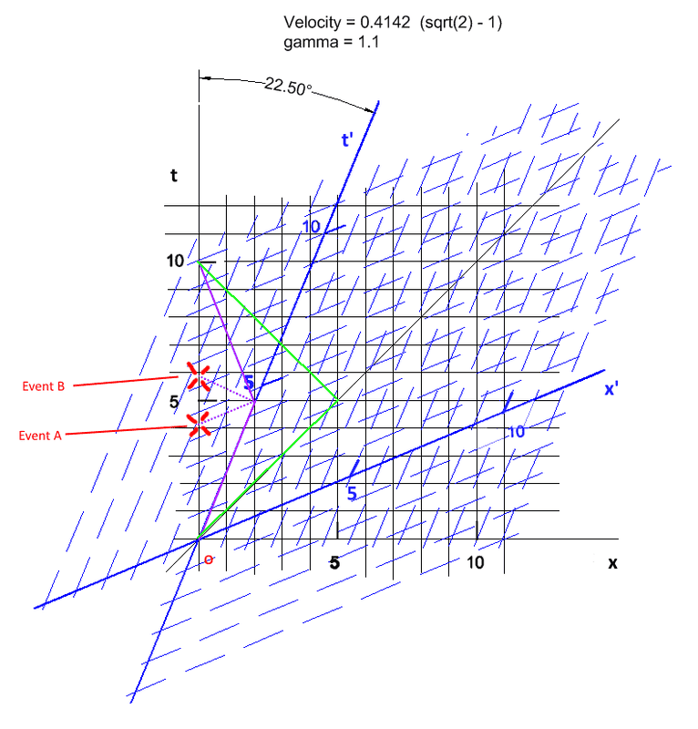

See the space-time diagram below.
The Twin Paradox
One twin stays on earth.
One twin leaves Earth at high speed (0.4142c), travels for 5 Earth years, and then returns.
The stay-at-home twin says that 10 years have elapsed since the traveller left.
The traveller says only 9 years have elapsed since she left.
Two things need to be explained:
Paradox 1. Why is the traveller only 9 years older whereas the stay-at-home twin is 10 years older?
Paradox 2. All the time that the traveller is travelling, the traveller observes stay-at-home's clock to be running slower than traveller's clock. And, all the time that traveller is travelling, stay-at-home observes traveller's clock to run slower than stay-at-home's clock. So each observes the other's clock to be running slower than his own clock so each must be younger than the other!
The resolution is given in the space-time diagram below based on Earth = 10 (years) and traveller (purple line), traveling at 0.4142c relative to earth, taking 9 years, 4.5 years on his blue axes to get to the turn round, and 4.5 years on the blue axis to get back. Note that I should really have drawn a yellow grid angled the other way for the traveller's return journey but the angles are the same so the values read off are the same.
An Event is a point on the diagram. The Earth observer uses the black grid lines to measure the time and space coordinates of the Event in their frame. The traveling observer uses the sloping blue grid lines to measure the time and space coordinates of that same Event in their frame.
Notice that, as he is traveling away, just before he turns round, traveller measures Event A on Earth (earth time t = 4.2) to take place at traveller's time t = 4.5 (dotted purple line of traveller's simultaneity). So traveller measures Earth's clock (4.2) to be running slower than traveller's clock (4.5).
Note that Earth observes the traveller to turn round at Earth time t = 5, but traveller's clock reads only 4.5. So Earth observes traveller's clock to run slower than Earth's clock.
That is, each observes the other's clock to run slower than their own clock.
When traveller is stationary at the turn round, he says time on Earth is now 5 (the dotted purple line would now be horizontal).
When traveller is up to speed going back (but before he has moved any distance) he measures Event B (earth time t = 5.8) to be at traveller's time of 4.5. So traveller jumps (instantaneously) from Earth time = 4.2 to Earth time = 5.8, and "jumps across" 1.6 years at the turn round point.
Similarly, on the way back, it takes traveller 4.5 years.
So, traveller's journey time = 4.5 + 4.5 = 9 years on traveller's clock. But the 10 years of Earth's time is made up of comprises 4.2 Earth years out, plus a gap of 1.6 Earth years, plus 4.2 Earth years back, for a total of 10 Earth years.
Note also that the faster the traveling twin moves the bigger the gap between Event A and Event B becomes. A photon traveling at c (the green line on the diagram) sees no time elapse between departing Earth and arriving back on Earth - the gap between Event A and Event B is now the full ten years.
This isn't correct as written. What the twins observe is affected by the Doppler effect, and each will observe that the other's clock runs fast or slow at different times. However, they will also observe that the distance to the other twin, and hence the lightspeed delay in what they observe, is changing. Only when they combine the two facts do they calculate the other's clock to be always running slow.
Better to say that he switched from using one set of clocks to another, and the clocks are offset by different amounts at different distances. The first set show, near Earth, that "the same time as turnaround" is 1.6 years earlier than the second set. Changing clocks without correcting for the time difference is the mistake, analogous to stepping from one timezone to another and thinking that one step took an hour (or minus an hour!).
There's no "jumping in time" going on, it's just a mistake with the clocks that might make it appear so.
I like your Minkowski diagram, but it's somewhat hard to read. I'd suggest making the grids into paler colours (e.g. 196,196,255 instead of 0,0,255) so that the worldlines are clearer. Also definitely don't mark the angle - the Euclidean angle is meaningless in Minkowski space.

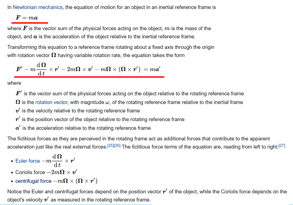

I am trying to learn about Rindler coordinates and would appreciate if you could point to a good introduction to them.
Are they in some way similar to rotating coordinates? By that I mean do we rewrite things like the Lorenz equations to take account of the acceleration as different rates of acceleration will undoubtedly give different a result?
When we compare inertial and rotating frames we can say "Newton's laws don't apply in rotating frames". This is true. If you stand still in a rotating frame and drop an object it will not fall in a straight line relative to you. It will travel in a curved path. You cannot explain that by Newton's Law F = ma.
However, we can write an equation of motion which describes the motion of an object when moving in a rotating frame using the rotating frame coordinates. This equation is very different from Newton's Laws and invokes new fictitious forces like Coriolis and centrifugal forces.
The Twin Paradox
