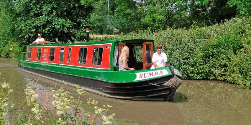

I'm not familiar with the term narrowboat. Do you mean something like this?
That type of construction would be highly likely to get swamped if it snagged on the lock wall while descending. I would not trust feet or angle estimates by eye witnesses, so calculations would be pointless.

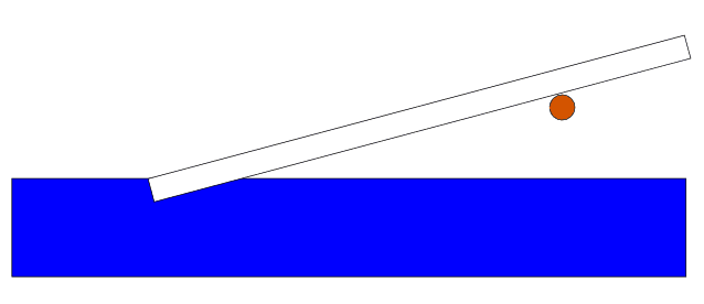

Pitch and Heel can be treated separately here, as heel is not the major problem. The fundamental problem arises from several factors but the most significant is that the snag or hang-up is not at the end of the boat but at 10' along the 60' hull. That is only 20' from the mid-point of the hull.
The centre of mass of the hull is effectively a fulcrum. The point that is lifted by 2' is 20' from that fulcrum, but the stern is 30' beyond the fulcrum. So freeboard at the stern will actually be reduced by about 3'. That was more than sufficient to cause the flooding.
The pitch angle was then close to Pa = Asin( 2' / 20' ) = 5.7°
I have ignored the issue that lifting one point on the hull reduces the buoyancy required to support the hull. It is important in the detail but not in the understanding of the lever and fulcrum model.

Anorlunda - yes, that is the correct type of boat. 60' long, 6'10" wide and (mostly) flat bottomed. It 's a common inland waterways vessel in the UK and although most have no keel, the baseplates are usually 10mm steel and they are remarkably stable. A few intrepid people have even motored across the English Channel - properly prepared and accompanied by a pilot of course!

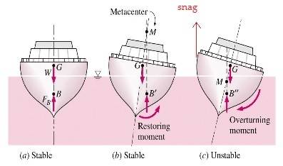

Here's what I think happened:
Under normal circumstances the boat has a single centre of gravity, with a centre of buoyancy. The hangup creates a second point, carrying some of the weight (apparently up to 33% if the bow is completely lifted out and the snag is 10' back on a 60' boat), with the buoyancy point (I think this is the metacentre) taking up the rest. As the water level drops, the metacentre moves rearwards but remains the fulcrum around which the boat rotates in pitch. Buoyancy is reduced as a greater proportion of the hull remaining in the water is taken up by the swim, but this is balanced (maybe (probably?) not entirely) by the amount of weight being carried by the snag.
If I have this right, the lever length is from the snag to the metacentre, and the stern will drop by a corresponding ratio dependant upon the lever length from the metacentre to the stern. The heel effect will also be apparent as the hull will rotate to the right, hence the water coming in over the starboard cant. I think the formulae and maths are actually pretty complicated and I'm trying to correlate the calculations needed against the owner's observations of the event i.e. a snag 10' from the bow combined with a water level drop of a few inches conspired to swamp the starboard stern cant. Still too many unknown factors to try to make sense of it though - at least to this bear of little brain. I think the key is how much the metacentre moves.

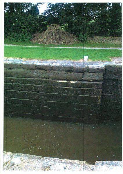

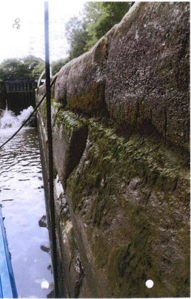

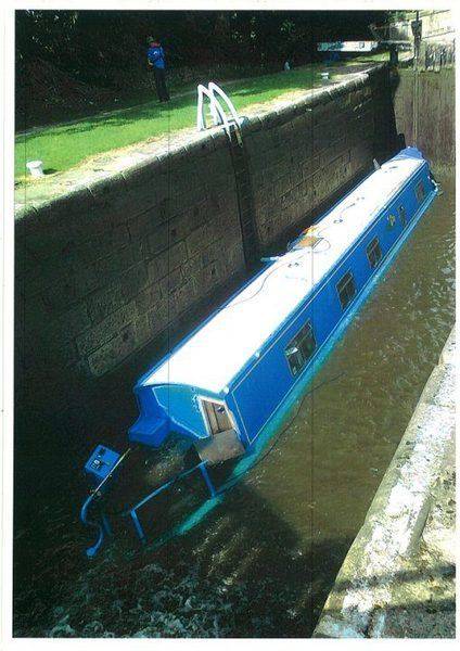

Found them. The first image shows the alignment of the lock wall and the bulge in the stonework. The second shows the scarring / witness marks from the hang up, and the third (very sad) shows the boat once the lock had been drained.
The witness mark appears to be close to the high water point so that says something about the height of the hang up point on the boat.

It is reassuring that the inward opening, high lock gates in the picture indicate that the boat snagged at the down-hill end of the lock where there is no high cill to complicate the issue.
The green slime in the picture indicates that the high water level in that lock is close to or just above the base of the top layer of stone. It appears that weathering of the upper two layers of stonework permitted the hull to move closer than usual to the wall. The loss of some mortar below the second layer of stone provided the shelf for the hull base plate to snag.

So now, using only geometry, I calculated the volume of the submerged triangle as a function of the angle of tilt. It is scaled as a fraction of the 16*720 rectangle defined as 100%. Below is a table of my results. Note that beam does not come into the calculation because the answer is expressed as a fraction of the triangle to the rectangle. The ratio of submerged cross sections is the same as the ratio of submerged volumes for any value of beam B of a rectangular barge.
angle in degrees, submerged fraction needed to swamp.
0, 200.00%
5, 51%
10, 26%
15, 17%
20, 13%
25, 11%
30, 9%
The part I didn't solve is the division of total vessel weight between the submerged triangle and the pivot point. Obviously, when the angle was 0 degrees, the boat is not snagged and the pivot carries zero. Also, at angle 90 degrees, the pivot carries zero of the weight. Maybe someone else could do that. When we have both, we can solve for the critical angle where the boat gets swamped from the stern.
There is no estimate of roll (heel). But if there was moderate heel, it might be approximated by reducing the effective freeboard. For severe heel, my 2D calculation would need to be made 3D to calculate the submerged fraction of volume.

CWatters said:
Sounds horribly complicated to me. Perhaps building a physical scale model would be quicker?
The experiment has already been done with a full size model, see pictures in post #22. We need to replicate that experiment at lower cost. I think a numerical model of the hull could be adjusted more easily than carving a scale model replica. The process may sound complicated but it can actually be broken down into neat modules. It would also be interesting to pivot a virtual narrow-boat on a virtual lock cill.
jim hardy said:
Just assuming the hull to be a rectangular prism with CG and CB dead center would be a starting point to figure out an algorithm.
I tried that simplistic approach with a calculator. Those assumptions hide the unexpected early sinking. Since the hull pivots on the snag fulcrum, it is the moment of mass versus the moment of buoyancy that must be solved. That situation is aggravated because there is little buoyancy at the stern with the narrow engine room, propeller and rudder.

anorlunda said:
I don't see how you say that. Especially up to 90 degrees.
Imagine a crane attached to the mid-line, 10' from the bow. Slowly lift the vessel, once the bow comes out of the water, about one third of the mass is being supported by the crane, that is the front 20' of the 60' hull. At some point the stern will flood, if you continue to 90° the entire mass will be supported by the crane. The hull will slide off the snag long before it reaches 45°. That was explained in post #20.
Baluncore said:
The mass that must be supported by hull buoyancy is less because the snag is supporting the forward 33% of the boat mass.
anorlunda said:
But if that is correct, then my answer is less than 10 degrees. My table in #30 says that at 10 degrees, the stern can only support 26% of the displacement before swamping (with zero heel).
Post #6 and #9 explains why 1/3 of the mass is carried by the snag.
