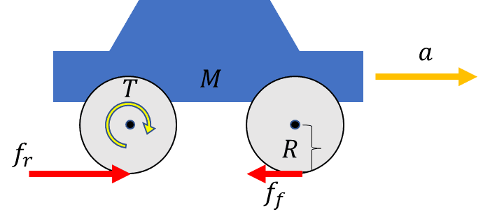

Front wheels: There must be a torque that is causing the angular acceleration of the wheel. Which implies there is a force acting at the point of contact.
$$ \circlearrowright^+ \sum \tau = R f_f = I \alpha = I \frac{a}{R} $$
Rear Wheel:
$$ \circlearrowright^+ \sum \tau = T - R f_r = I \alpha = I \frac{a}{R} $$
Total Vehicle:
$$ \rightarrow^+\sum F = 2 \left( f_r - f_f \right) = Ma $$
There is a torque. The torque is caused by the misalignment between the normal load and the normal reaction force at the tire-road contact. That misalignment is caused by the deformation of the wheel and/or ground. That rolling resistance torque can be defined as a perpendicular force acting at the tire-road contact patch when you assume both normal forces are aligned.

Can someone just show the appropriate set of equations that describes the motion of the car in the diagram? I feel that conceptually it will be easier to examine a relevant chunk of the EOM.

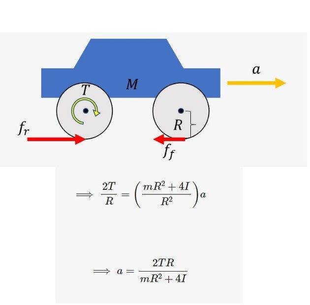

Can someone identify ##F_{net}## using work/energy?
$$ \begin{align} \int F_{net} dx &= \frac{1}{2} m v^2 + 4 \frac{1}{2} I \omega^2 \tag*{} \\ &= \frac{1}{2} m v^2 + \frac{1}{2 R^2} 4 I v^2 \tag*{} \\ &= \frac{1}{2} \left( \frac{mR^2 + 4I}{R^2}\right) v^2 \tag*{} \end{align} $$
If we differentiate both side with respect to ##x##:
$$ \begin{align} \end{align} $$
$$ \frac{d}{dx} \int F_{net} dx = \frac{d}{dx} \left( \frac{1}{2} \left( \frac{mR^2 + 4I}{R^2}\right) v^2 \right) \tag*{} $$
$$ \implies F_{net} = \left( \frac{1}{2} \left( \frac{mR^2 + 4I}{R^2}\right) \right) 2 v \frac{dv}{dx} \tag*{} $$
$$ \implies F_{net} = \left( \frac{mR^2 + 4I}{R^2}\right) a \tag*{} $$
$$ \implies a = \frac{F_{net} R^2}{mR^2 + 4I} \tag*{} $$

Picking up with Work/Energy replacing the LHS by the work done by a constant torque ##2T## ( ## T## is applied to each wheel).
$$ \frac{d}{dx} \int 2T \, d \theta = \frac{d}{dx} \left( \frac{1}{2} \left( \frac{mR^2 + 4I}{R^2}\right) v^2 \right) \tag*{} $$
$$ \frac{d}{dx}\frac{2T}{R} \int \, dx = \frac{d}{dx} \left( \frac{1}{2} \left( \frac{mR^2 + 4I}{R^2}\right) v^2 \right) \tag*{} $$
$$ \implies \frac{2T}{R} = \left( \frac{1}{2} \left( \frac{mR^2 + 4I}{R^2}\right) \right) 2 v \frac{dv}{dx} \tag*{} $$
$$ \implies \frac{2T}{R} = \left( \frac{mR^2 + 4I}{R^2}\right) a \tag*{} $$
$$ \implies a = \frac{2TR}{mR^2 + 4I} \tag*{} $$
This and the system of equations in #10 using Newtons Laws yield equivalent results.

I asked you to do the FBD for the wheels and the body separately, which you haven't done. So here we go:
Rear [driven] wheels:
$$m_w a = F_{f_r} - F_{a_r}$$
$$W_r + m_w g = F_{N_r}$$
$$I_w \frac{a}{R} = T_w - F_{f_r} R - F_{N_r} d$$
Body:
$$m_b a = F_{a_r} - F_{a_f} - F_R$$
$$W = W_r + W_f$$
$$W L_r = W_f L$$
Front wheels:
$$m_w a = F_{f_f} - F_{a_f}$$
$$W_f + m_w g = F_{N_f}$$
$$I_w \frac{a}{R} = - F_{f_f} R - F_{N_f} d$$
So you have a system of 9 equations with 9 unknowns, namely:
##a##: body acceleration;
##F_{f_r}, F_{f_f}##: rear & front friction forces;
##F_{a_r}, F_{a_f}##: rear & front axle forces;
##W_r, W_f##: rear & front weights;
##F_{N_r}, F_{N_r}##: rear & front normal forces;
And the known values:
##m_w, m_b##: wheel & body mass;
##I_w##: wheel inertia;
##R##: wheel radius;
##T_w##: wheel input torque;
##d##: misalignment distance for rolling resistance (actually equals the rolling resistance coefficient times the wheel radius, see ##F=\frac{Nb}{r}## on Wikipedia);
##F_R##: Body resistance (drag, etc);
##W##: body weight;
##L##: wheelbase;
##L_r##: CG to rear axle distance.
There might be some mistakes (maybe some + or - signs) and it could be more detailed, but that should be what you are looking for.

I appreciate you elaborating on that model, but I was after the minimum physical model that captures the basic idea. A simple physics model. Not the model an engineer would use. I had already provided the FBD for that.
I think you misunderstood what I am concerned about. If you neglect all that “real” stuff, you get the most basic result that can be used to talk about the fundamental physics that drives the model. That is where this stuff is confusing for me, and probably where the OP is confused as well. Fundamentally, there appears to be no difference between what you did and what I did. Which is good news! The difference just lies in level of the accounting. That’s not what I’m worried about though.
If you want to neglect the "real" stuff, then neglect the wheels as well. Then you have a simple block with the friction forces acting on it (including the one for rolling resistance). You can also increase the vehicle's mass to compensate for the rotating components' inertia when accelerating (equivalent mass concept).
  • #31
I feel like the wheels are a minimum model for which this concept of "work done by friction" can be looked at.
  • #32
If you don't want to include the wheels, you do the FBD for the vehicle as a whole, with the friction forces where the wheels are supposed to be;
If you want the wheels included, you do a FBD for the body and one FBD for each axle, and analyze them together, as I did in post #28.
If you want the powertrain included as well, you do a FBD for the body, one FBD for each axle, and one for each component of the powertrain.
Your choice.
But using wheels that move relative to the body while still considering them as part of the body won't work.
Likes hutchphd
  • #33
So, what you are saying the result of #10 being equivalent to #24 is a happy accident? I must consider some unknown force as pushing on the axles to solve the problem (namely F_a in your analysis)?
  • #34
@erobz , what is in contradiction (in your mind) with this result?
  • #35
erobz said:
However, considering the equations in #10 which appear to be equivalent, the net force on the car is the friction force. They seem to be different sides of the same coin.
They are in fact exactly that and they are consistent. There is a net external force on the car provided by the difference in the rear ground-tire friction and the front.
There is a net external force on the car provided by the difference in the rear ground-tire friction and the front. This does not say that the ground does work on the car because the cantact point is static. The contact point is static because the car is not a rigid body and is continuously deformed by the engine (it takes energy to make the rear wheels turn. There is also some external "rotational friction" as expertly detailed by @jack action. But the motive energy does not come from an external force. It is internal energy from the long ago sun channeled through dead dinosaurs.
There is no unknown force required: this is not a rigid block.
This question has now been asked and answered. Finis.
