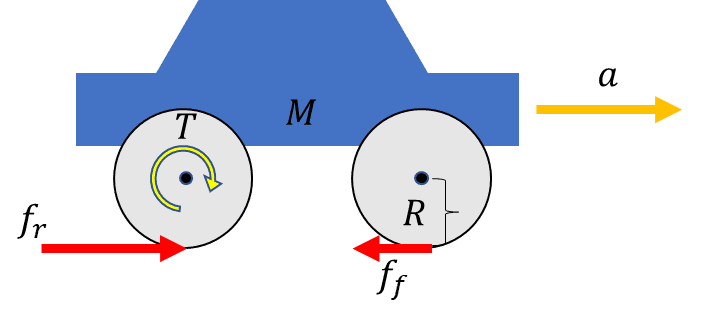

The front wheel has clearly a rolling resistance. There is a friction force that goes backward. Where is that force in your equation?
  • #73
Its not rolling resistance. Its static friction ##f_f##.
Front wheels:
$$ \circlearrowright^+ \sum \tau = R f_f = I \alpha = I \frac{a}{R} $$
The front wheels are not being driven by an active torque applied to the front axle, but they are none the less accelerating if the vehicle is accelerating ( angular ) and the no-slip condition applies. The static friction is responsible for the angular acceleration of the front wheels. Without it, they just slide without rotating.
  • #74
erobz said:
I want this to be over as much as anyone else. So I'm going to be as concise as possible about what I find confusing still:
$$\int F_{net} \, dx = \int 2 \left( f_r - f_f \right) dx = 0 $$

  • #75
erobz said:
Its not rolling resistance. Its static friction ##f_f#.
We have already shown that this static friction is a response to the rolling resistance.
So you have a backward force applied to a wheel with no reaction torque? Nope. Something is reacting to that force. That front wheel torque wheel center force is ultimately coming from the rear wheel torque, passing through the body.
Since the force is backward, it should contribute to decelerating, not only the front wheel itself but the whole vehicle, including the rear wheel.

  • #77
Its a steel wheeled car. virtually undeformed steel wheels on a steel track. rolling resistance is nill.
Your right. It does in the following ##\sum F## equation:
erobz said:
Total Vehicle:
$$ \rightarrow^+\sum F = 2 \left( f_r - f_f \right) = Ma $$

  • #79
Lnewqban said:
Thank you very much, erobz. :smile:
Just like it happens in the picture shown in that book that you posted earlier, using the magnitudes of those forces at the contact patches, which are relatively easy to calculate, is a very convenient and traditional way to compute the work in or out a vehicle.
As you are an intelligent person trying to understand the apparent conflict of the equation related to that way, I am simply trying to reason that, by definition of work (force times distance), those static forces themselves are unable to perform any work (add to or subtract from the car any kinetic energy).
Nevertheless, the magnitudes of those forces are a direct reflection of the actual physical processes happening inside and outside that vehicle (heat, expansion of gases, transmission reduction, torque at shaft, pad friction on brake rotors, etc.).
Mathematically, there is no contradiction in that equation.
IMHO, physically, there is.
Thank you for being honest. Something is strange here in that model and we aren’t quite sure what. That is how I’m interpreting your opinion. I hope I'm not projecting.
  • #80
Steel wheels do deform. There is no rolling possible without deformation. The simple fact that you have the static friction present means that it was created by some other opposing force or torque.
erobz said:
Your right. It does in the following equation:
Yes, but you are treating each ##a## in your equations as if they were independent of each other. They are not. ##a## is the acceleration of the vehicle but also the acceleration of each of your wheels. Furthermore, ##a =\alpha R## where ##\alpha## is the angular acceleration of your front and rear wheels. (They could have different angular acceleration if they had different radiuses.)
This means that if a wheel decelerates (both longitudinally and angularly), the other wheels must also decelerate, and the vehicle as a whole must decelerate. How is that represented in your equations in post #10?
Here is the problem with your 3 equations in post #10. There are 2 ways to look at it:
  1. Mine. ##f_f## is known. This means that the only unknows are ##a## and ##f_r##. Every other variable must be known. So you have 3 equations with 2 unknowns, so one of your equations is redundant. But we know that they all have pertinent information not available in the other equations. That cannot give a good result. You need more equations to solve this (post #28).
  2. Yours. ##f_f## is unknown. Then you have 3 equations with 3 unknowns, namely ##a##, ##f_r##, and ##f_f##. If you solve your system of equations in post #10, I end up:
$$f_r = \frac{T}{R}\left(1- \frac{I}{\frac{1}{2}MR^2 + 2I}\right)$$
$$f_f = \frac{T}{R}\frac{\frac{I}{R^2}}{\frac{1}{2}M + \frac{2I}{R^2}}$$
$$a= \frac{\frac{T}{R}}{\frac{1}{2}M + \frac{2I}{R^2}}$$
Doesn't that look weird that the front static force ##f_f## depends on the wheel inertia? What law of physics is implied here? If I assume ##I = 0##, then it disappears:
$$f_r = \frac{T}{R}$$
$$f_f = 0$$
$$a= \frac{2T}{MR}$$
And something is clearly wrong with the factor of ##2## with the acceleration.

None of this is unexpected with the model.
##f_f## and ##f_r## are a reaction force to the acceleration. The underlying no-slip criterion here is simply ##f_f < \mu_s N_f## and ##f_r < \mu_s N_r##
If you let ##I \to 0## the wheels ( front or back ) provide no resistance to the vehicle's acceleration. A wheel without inertia takes no torque to accelerate.
The ##2## comes from the last equation. The torque acting on each wheel causes the reaction ##2 f_r##. e.g. there are ##2 f_r## forces accelerating the car forward.
That is all internally consistent.
What is not internally consistent is the work done by the static forces should equal zero, but...
$$ \int F_{net} dx = \int 2 \left( f_r - f_f \right) dx \neq 0 $$

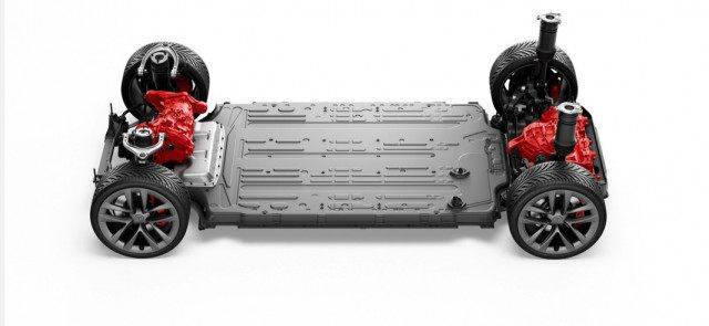

But that has been the principle of all automobiles, trucks, ships, locomotives, airplanes, old and new: to move at the expense of accumulated work or energy that is contained inside it.
That energy can be the chemical energy of fuel or batteries, converted to useful mechanical work via an engine or motor.
Is that energy (and its resulting internal output torque) the one doing the useful work.
These are the guts of a Tesla model S.
That grey plank is a battery capable of accumulating 100 Kw-h of energy.
The red motors can transfer enough of that energy onto the tires in 3.0 seconds as to accelerate the car's mass of 2,000 kg from 0 to 100 km/h.
  • #90
That’s all fine. They just need something to “push off” (or mass to eject) to accelerate their own center of mass.
I just noticed an inconsistent model, which either is indication of a bad static force model, or we accept the fact that we can’t really do much if we have don’t have anything to interact with.
Perhaps just accepting that duality is the simplest resolution. Just treat this as looking at it from the universes perspective, instead of the “thing” in it. After all ## \Delta U_{universe}=0## . The static friction force does work on the universe. That has to be the case. And that’s actually what’s being calculated here. Maybe static friction is saved…from nothing. Because nothing was going so change anyhow.
Anyhow, I expect to be burned at the stake the more I talk! I’m going to bed.

Thats a good observation that was missed. As you can see, it's also a good place where we can come, challenge ourselves and learn from our mistakes.
That being said, I believe the correction is to bring that factor of ##2## inside and only apply it to the ##I \frac{a}{R}## term.
I think that first term should actually be:
$$\frac{ TR -2Ia}{R^2}$$
and likewise the next term should be:
$$ \frac{2Ia}{R^2}$$
@Saalz seems to be missing that factor of ##\frac{1}{R}## in each of the terms.

Sorry to @jack action. That factor of ##2## was indeed a blunder in the original equations of motion.

@Saalz seems to be missing that factor of in each of the terms.
I was indeed missing the 1 / R factor, but I can't figure out the meaning, tho.
If we know that Torque = I * a, and so, that Force = Torque / r, then the why woldn't it be correct for the first term to be ## \frac {T \m 2 I a} {r}, ##
And the second: ## \frac { 2 I a} {r} ##
  • #100
If we know that Torque = I * a, and so, that Force = Torque / r, then the why woldn't it be correct for the first term to be $$ \frac {T \m 2 I a} {r] $$
And the second: $$ \frac { 2 I a} {r] $$
Don't use symbols in latex. I don't believe they parse. There is code ## \pi ## = \pi ## \alpha## = \alpha etc...
You have brackets and braces mixed together. Should be All braces there.
I think you actually have ## \alpha ## in your equations (looking more closely). If that is the case the factor of ##\frac{1}{R}## won't be in there yet.
That comes after substituting the no-slip condition ##a = R \alpha##
So, maybe not a problem. But that is why we like Latex here.
  • #101
I fixed up the Latex there. Just reply to this message to see what has changed.
"If we know that Torque = I * a, and so, that Force = Torque / r, then the why wouldn't it be correct for the first term to be ## \frac {T 2 I \alpha}{r} ##
And the second: ## \frac { 2 I \alpha}{r}##"
