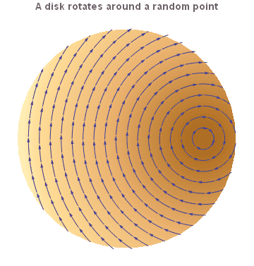

@user079622
This is just a mathematical fact of rigid body motion, purely kinematically. It is just the way that rigid body motion behaves mathematically.
Suppose I have a rigid disk which is spinning about its center of mass. At a given instant I can plot the velocity of each point on the disk as follows:
The formula for the velocity field is ##\vec v=(y,-x)##. This is rotation around the center, as expected.
However, suppose instead of a disk rotating, we have a wheel rolling. Kinematically these are the same motion in different reference frames. Then at any given instant I can plot the velocity of each point on the wheel as follows:
The formula for the velocity field is ##\vec v=(y,-x)+(1,0)##. Notice that this motion is also a pure rotation, but about the bottom of the wheel, the point that it contacts the ground. Again, this is kinematically identical to the disk rotating about the center in a different reference frame.
These two points are not special. In fact, for any point on the wheel you can pick a reference frame where that point is momentarily at rest. When you do so the motion is as follows:
The formula for this velocity field is ##\vec v=(y,-x)+(0,0.7)##. Notice again that this motion is momentarily a pure rotation about the chosen point which happens to be ##(0.7,0)##.
This is a general feature of rigid body motion. You can always decompose the velocity of the material points in a rigid body into a pure rotation about any point and a rigid translation.

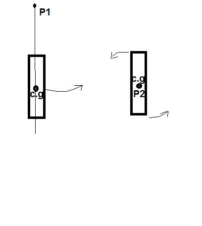

Wikipedia says that for a free-floating (unattached) object, the axis of rotation is commonly around its center of mass. https://en.wikipedia.org/wiki/Rotational_energy
Does this mean there are exceptions where some objects' axis of rotation does not rotate around their center of mass in the case of free-floating?
  • #44
It means that there are exceptions where the people analyzing the scenario choose to analyze its rotation about a different axis. For instance, they might analyze the moon as rotating about the barycenter instead of its own axis.

If force act at 90degress at the end of stick in free space, will he rotate around CoM and CoM will translate in straight line?

That is one possible way to desctibe the motion, but not the only one.
  • #51
But is instant axis of rotation through CoM?
  • #52
user079622 said:
But is instant axis of rotation through CoM? In another words, can single force make object to rotate around com?
The "instantaneous axis of rotation" is the axis that is momentarily motionless.
However, "motionless" is always relative to a chosen frame of reference. Change the frame of reference and you change which axis is "motionless".
It is quite convenient to adopt the rest frame of the stick's center of mass. So convenient that we tend to do so without even thinking about it. That is why we tend to think of the stick as rotating about its center of mass.

As already mentioned in several posts, the velocity of any point P of the rigid can be decomposed as a sum of two terms: the velocity (usualy called translation velocity) of another point, O and a rotation about this point O. ##\vec{V_P}=\vec{V_O}+\vec{\omega}\times \vec{r_P}## where ##\vec{r_P}## is the position vector of P relative to O and ##\vec{\omega}## is the same for all the points of the rigid and for any choice of the point O. When you change the point O, the translation changes but ##\vec{\omega}## does not. And at any instant you can find a reference point O so that ##\vec{V_P}## is zero. This point is what they call "instantaneous center of rotation" or "instant center of rotation". It is at rest at that instant. It will be just a coincidence if this point happens to be the COM or the CG at some specific time.
This works always for plan-parallel motion (or planar motion). For a more general motion, like an elicoidal one, I think that it does not work. I mean, there may not be any point instantaneously at rest.
