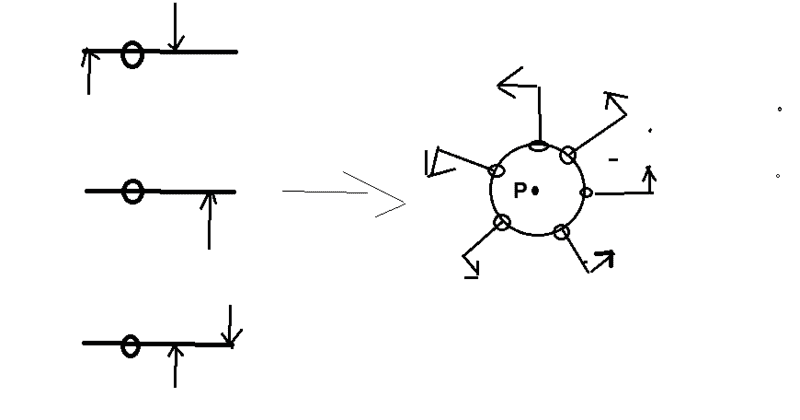

The video says the exact opposite of what you claim. The center of rotation is not the CoM when airborne (at 5:33):
Yes they are separated by 2cm, so he has problem with flight/shaking,he made him so he must do some fine tunning.
Wait a second, that mean CoM move in circle, where is centripetal force to do that?
If we say, rotate around CoM then we brake net force non zero rule.
If we say com move around center of rotation, then we dont have centripetal force to do this.
Paradox :)
  • #142
user079622 said:
If we say, rotation is around CoM then we brake net force non zero rule.
Or perhaps your analysis of the forces is wrong. Let’s see, which is more likely? The established laws of physics are wrong or a novice missed something important.
Anyway, this is getting both frustrating and pointless. I am going to close this thread.
