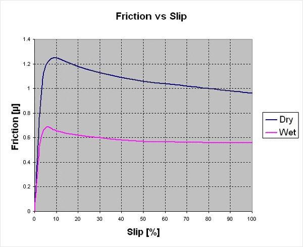

The force exerted on the road is equal to torque divided by radius for the no slip case (|T / r| < us * Fn). If you've got slip the force will be equal to kinetic friction. You would have to reduce the torque to get rid of the slip. There is no velocity dependency in this friction model.
There are more complex tire friction models where the friction coefficient depends on tire slip. Starting at 100% slip(car standing still) the friction coefficient will increase until its maximum as the car is accelerating.
