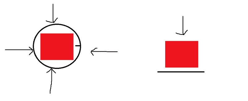

I have a project which requires me to get 5 very specific images of an object from various angles. The user can't use their hands because it would be too shakey and introduce error. These images have to be precise and steady. So that's why I need to build a helper camera mounting device to help. I need help in designing this. The background of the images also needs to be removed.
The 5 angles I need is 4 from it's sides 0 degrees, 90 degrees, 180 degrees, 270 degrees. Where the camera is x distance away from the center of the object. The fifth angle is a top down view of the object, but the camera also needs to be x distance away from the center of the object.

7. A green screen that becomes the background of all 5 shots, so that a program can automate removing the background.What I had in mind, would be a a plank of wood, with a circular piece on the center which the object rests on. The initial rotation a marker lines up with the 0 degree marker. There is also markers marked for 90, 180 and 270 degrees. So the user can just rotate the circular thing and align the markers to exactly rotate the object with each of the 4 degrees, so the camera can get the 4 side shots. Then there would be two thin L shape sticks attached to the main wood plank. The phone would rest in the center of the 2 L sticks held by rubber bands. It can be attached on the bottom for the 4 side shots, and also on the top to get the top down view. For the bottom position, it needs something to stand on, so perhaps another rubber band twisted in a 8 shape. Then I could tape green papers all around it. With a green wall behind it.

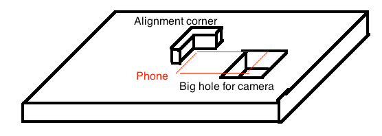

All phones I know of have their camera in the upper half. If you make a support for the lower half (including some features sticking out of the surface to help with alignment), you can make a big hole in the wooden sheet to have the camera point through that hole.

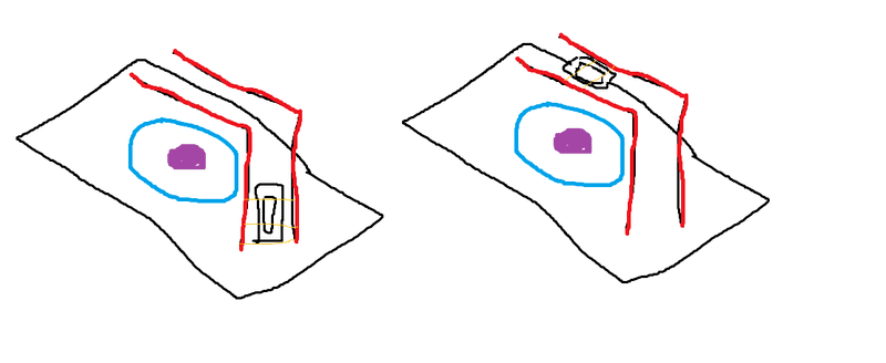

Rubber bands are flexible and they might wobble or shake, so you might have a point there. In that case I would need something more sturdy to hold the phone at any position. Holes in a stick might not work because they limit the number of positions, and I need to be as flexible as possible. Maybe something like a vice grip to stick to a pole would work better.
Also do you mean to make a hole in the wood base floor and put the phone in that? Also how would I raise it if it needs to go higher?
Here is a sketch showing what I meant. The hole can be really big to accommodate all common phone types. The alignment corner makes sure the phone has the correct orientation.
It's a bit confusing because it looks like the phone is flat on the ground. How would it take the picture of the object, and where would the object be?
The board is the distance x above the surface where the object rests on.
At the place where you want to take the picture - where else?
oh ok, so that whole thing would be on top, but it looks like there is a lot of extra material needed for the top then. I was looking to minimize on material used. In my example, I have two L shape sticks, which is much less material.
You don't need a large board. Just large enough for the phone. Don't take the sketch too literal.
It could work, but I'm also looking to minimize other factors. Your idea would increase material compared to my idea. It would need an extra base on top. Then you would need to cut a hole in it, then construct that alignment piece and stick it on the base. It just seems like it would be more effort and cost to construct compared to my example.
Basically, as part of the requirements, the total cost and effort to build the whole device, should be minimized. So I'm looking for a way to make this sturdy but using materials that don't really need much modifications. In other words, putting them together like lego blocks (not literally as easy but you get the point).

The alignment blocks can be small wooden pieces or small metal angles. Something that takes 10 minutes to add with a negligible budget, and it will lead to a very precise alignment of the phone.
