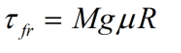

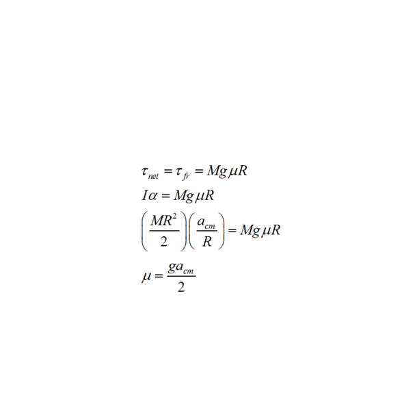

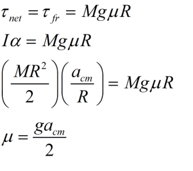

Well since it is rolling without slipping, the linear acceleration must equal to angular acceleration multiplied by radius:
So since the sum of torques is the torque from friction:
Is this correct then?
(Sorry about the really big pictures)
Retry that last step.
Also, your answer should express μmin in terms of F, M, g and R (or any subset of those).

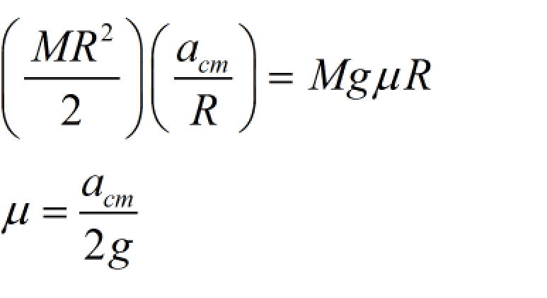

:doh:
haruspex said:
That's better. But see the edit I made to my previous post.

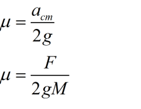

Hm..
The only substitution which I can make is this:
I am not sure how to get R in there.
It seems that the coefficient of fric. is not dependent on R.

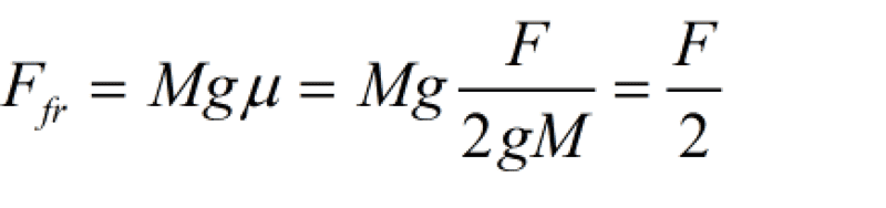

Interesting, this follows:
HaoPhysics said:
No, acm is not F/M.
As I wrote, a subset of those variables is fine. It just must not involve any variables outside of the given set.
haruspex said:
No, acm is not F/M.

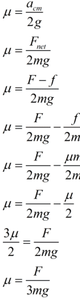

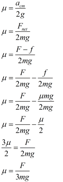

Oops! acm is net force / m,
