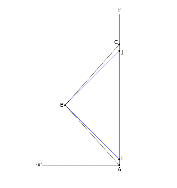

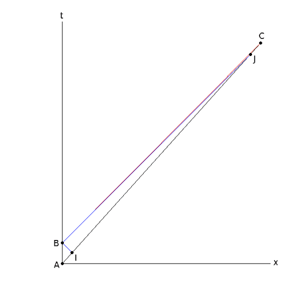

zonde said:
Now how it looks from perspective of second twin - first twin is time dilated by the same factor in forward and backward trip (the same speed). But contrary to the first case acceleration (because we have to switch coordinates) has effect. And result of this clearly unphysical effect is that we just add some accumulated time to Earth clock.
Here is where you have chosen to jump frames so that the traveling twin is always at rest. But before doing that, I want to make sure you agree that we can use a frame in which the traveling twin is at rest during the outbound portion of the trip but for the entire trip. Do you agree with that?
In this case, the traveling twin will have no time dilation for the first half of the trip while the Earth twin has the same time dilation that the traveling twin had in the first frame where the Earth twin was at rest, correct? But then when the traveling twin turns around, he will have more time dilation than the Earth twin continues to have, correct? Do you see this as a legitimate explanation? And do you also see that the this frame does not provide either twin with any more perspective or insight or observation than they had with the first frame? And do you understand that even in this single inertial frame, we can calculate exactly what each twin can observe of each others clock during the entire trip and it will be exactly the same as what we calculated in the first frame?
Now we can go on to a third frame in which the traveling twin is at rest during the inbound portion of the trip but we will apply it during the entire trip. And all the same sorts of questions and answers apply, correct?
Finally, since you want to have the traveling twin and the Earth twin jump frames at the moment of turn around, I beg you to provide us with the details of the calculations. Let's assume that the traveling twin turns around after one year on his clock and is traveling at 90%c. Can you do that? And can you also show the calculations for what each twin sees of the other twin's clock during the entire scenario, please?

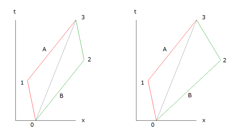

  • #124
stevendaryl said:
No, that's not true. Not in any objective sense.
Here's an analogy. Suppose you have a system of roads, and every road has markers on it every 100 meters. You have two roads that meet at a point, diverge, and then come back together at a second point. You can compare the number of markers along the two different roads between the first meeting and the second meeting. You might find that one road has a greater number of markers between the two points than the other road. Does that mean that the road with the greater number of markers must have its markers closer together, or that the road with the small number of markers must have its markers farther apart? No, it's just that the distance between two points depends on the path taken. The number of markers is an accurate measure of these two distances.
In SR, the analogy of "number of markers along a road" is "number of ticks of a clock along a spacetime path". Two spacetime paths meet at some point, diverge, and then come back together later. The number of clock ticks between the two points is different for the two different paths. Does this mean that one clock's ticks come closer together, or that the other clock's ticks come farther apart? No, it's just that the proper time between two points depends on the spacetime path taken.
That is a good try at trying to solve the problem... but it fails - for it simply replaces the change in the rate of ticks of the clock, with a change in the length of the spacetime path.
The same problem still persists, but now becomes: if the initial acceleration reduces the length of the traveling twin's spacetime path as compared to the stay at home twin's spacetime path, how does the traveling twin use acceleration at the end of his journey to return to the stay at home twin's spacetime path?
(And on a point of understanding your description of a spacetime path, not sure how the shorter spacetime path can return to the stay at home twin's longer space time path? Is the stay at home twin's spacetime path curved or something?)
  • #125
It's not that the acceleration/deceleration reduces the length of the path, it's that it sets the traveling twin on a different path. I've attached a picture that shows the different paths followed by the twins through space-time, how they start out on the same path , and how the traveling twns acceleration and decelerations change his path through spacetime.
Now, because these are paths through space-time, not just space, it's not that surprising that the two twins measure different times along the two different paths. Basically if you travel one of those paths, your wristwatch will tick off the 'distance' traveled along the path.
What is more surprising at first glance, and sometimes throws people, is that the traveling twin appears to be taking the longer path through space-time. You have to remember that in space-time, the distance between points is calculated as [itex]s^2=x^2-t^2[/itex], not the [itex]s^2=x^2+y^2[/itex] that the Pythagorean theorem tells you to expect in space.

  • #128
ghwellsjr said:
Just because you analyze the Twin Paradox from a frame in which the Earth twin is at rest and all the time dilation applies to the traveling twin, this does not mean that this frame provides the Earth twin with any insight into the traveling twin's time dilation. Time dilation cannot be observed, it can only be calculated based on a reference frame.
As for me that's fine.
ghwellsjr said:
What can be observed by the Earth twin is the Relativistic Doppler which this frame will allow you to calculate (although there is an easier way). This is the only perspective that the Earth twin has of the traveling twin's clock.
Not sure I understand. Are you saying that the only perspective that I can have about something is what I can observe about this something?
Mostly yes. I just want to point out that perspective is not the same thing as observation. We can have different interpretations (perspectives) about the same observations.
And then, to address your comments to me, I'd like you to show us how you use the LT in this process, OK?
I consider spacetime diagrams much more convenient tool to demonstrate "frame jumping" and role of LT in this. Anyways for me spacetime diagrams come first and then math. And you will have to wait a bit.
There are two different aspects to time dilation and the twin paradox: The first is understanding how mutual time dilation (each twin views the other twin's clock to be running slow) can produce an asymmetric result (the traveling twin's clock advances less for the whole trip than the stay-at-home twin). The second is the non-Euclidean metric of Minkowsky space. The first aspect has a direct analogy with Euclidean geometry. The second does not.
By the "non-Euclidean metric of Minkowsky space", I mean this: In Euclidean geometry, if you have a line segment that runs from point A to point B, and the displacement in going from A to B is X in the x-direction and Y in the y-direction, then then length of the line segment L is given by L2 = X2 + Y2. In contrast, if point A and B are points in Minkowsky space, and the separation is X in the x-direction and T in the time-direction, then the proper time of the inertial path connecting A and B is given by L2 = (cT)2 - X2. That minus sign is the reason moving clocks run slower, instead of faster. I don't know of a really good way to understand why spacetime has that minus sign in its metric, other than working with it and seeing how it fits together. For example, if you assume that light has speed c in all directions in one frame, and you assume that getting a straight rod moving in a direction perpendicular to its length doesn't change that length, then you automatically get time dilation for a moving "light clock" formed by a pair of mirrors on either end of a moving rod, with a pulse of light bouncing back and forth between them.
But a lot of the trouble have with the twin paradox is not in accepting time dilation, it's in understanding how MUTUAL time dilation can lead to an asymmetric result in the elapsed times of the two twins. This is where the analogy with Euclidean geometry helps.
You have two roads that intersect at point A. The "slope" of the second road relative to the first road is m. (Slope is the tangent of the angle between the roads). If s1 is the distance along the first road, and s2 is the distance along the second road, then we can relate the two as follows:
Imagine being at a point on the first road at distance marker s1 , and looking in the perpendicular direction toward the second road to see what the "corresponding" distance marker is there. Euclidean geometry predicts that
[itex]ds_2 = ds_1 \sqrt{1+m^2}[/itex]
So [itex]ds_2 > ds_1[/itex]
If you move [itex]ds_1[/itex] along the first road, then the corresponding distance marker on the second road changes by a greater amount, [itex]ds_2[/itex]. But this effect is completely mutual! A traveler on the second road comparing the distance marker [itex]s_2[/itex] to the corresponding distance marker [itex]s_1[/itex] on the first road (which he sees by looking in a direction perpendicular to his road) will likewise find:
[itex]ds_1 = ds_2 \sqrt{1+m^2}[/itex]
That seems like a contradiction. The first traveler thinks that the markers on the second road are increasing faster, and the second traveler thinks that the markers on the first road are increasing faster. How can they both be right? It's because while each traveler sets up a correspondence between markers on one road and markers on the other road, they use a DIFFERENT correspondence. The traveler on the first road associates two points on a line perpendicular to the first road, while the traveler on the second road associates two points on a line perpendicular to the second road. Those are two different correspondences.
Now, if the first road continues straight, but the second road makes a turn and comes back to meet the first road, then the first traveler can compute the relationship between distance markers on the two roads as follows:
[itex]s_2[/itex] at finish = [itex]s_2[/itex] at start + [itex]\Delta s_2[/itex]
where [itex]\Delta s_2[/itex] is computed by
[itex]\Delta s_2 = \int \sqrt{1+m^2} ds_1[/itex]
If the slope [itex]m[/itex] is greater than 0 anywhere along the route, then
[itex]\Delta s_2 > \Delta s_1[/itex]
This is the same mystery as in the twin paradox. Slope is relative, each traveler thinks that the other road has a nonzero slope. But when the two roads get back together, the difference in distance markers along the two roads is objective. How is that possible? Why can't the traveler on the "bent" road use the analogous formula to conclude that [itex]\Delta s_1 > \Delta s_2[/itex]?
The answer is that when the second road makes a turn, its notion of the "perpendicular" direction changes, and its notion of the "corresponding" point on the other road also changes. The formula
doesn't take into account these abrupt changes of the correspondence. From the point of view of the traveler on the "bent" road, the corresponding distance marker on the first road leaps forward or backward suddenly when he makes the turn. This is exactly what happens in the twin paradox to the traveling twin. During turn-around, the traveling twin's notion of how old the stay-at-home twin changes abruptly.
  • #132
Exactly?? I'd feel a lot better about your analogy is if you had pointed out at the end what you pointed out at the beginning, that it gets it only half right. So if someone remembers what you pointed out earlier that there is that minus sign in the metric for the Minkowski space, then they might not be disturbed by your last two sentences. When the traveling twin turns around the time on the stay-at-home clock jumps forward over a positive gap but in your analogy the distance jumps backwards over a negative gap.
I would also feel a lot better if you had emphasized that your analogy applies to the explanation that uses two inertial frames and requires both twins to jump between them at the moment of turn-around and that this is just one of many different explanations that all account for the final clock comparison equally well.
For example, you showed by analogy how the traveler that continues in a straight line can calculate the other traveler's path without "jumping frames". You could have also shown how you could have continued to use the "frame" of the other traveler even after he made the bend to calculate the distance of both paths. In fact, I maintain that you only use one frame, that of the straight-line traveler and that you are making an incorrect claim that the other one can actually see the gap in distance (and by analogy time) which is not true.
Do you believe that the "frame jumping" explanation is the only valid one for understanding the Twin Paradox?
What you should be pointing out if you want to make this simple, like Einstein claimed his theory is, is that in any inertial frame that you want to pick, you integrate the Proper Time rate of each clock over the entire scenario and you use the Time Dilation formula to calculate that Proper Time rate based on the instantaneous speed of each clock. It's so simple when you do that and to suggest that you need to something more complicated or that doing it the more complicated way (frame jumping) somehow is closer to the traveling twin's reality is just wrong. It doesn't matter which frame(s) you use, none of them change anything that any observer can perceive or see or measure or observe or know. Any observer is free to use any frame they want, not just the one or ones that they happen to be at rest in.
And as I have asked others to do, I would like to see your frame jumping explanation done with the specific example of the the traveling twin traveling for one year at 90%c and then returning. Show the numbers, calculations for the entire scenario. Show us how you do it including how you determine what each twin actually sees of the other twins clock during the entire scenario, not just at the end. And I will be happy to show you the same scenario based on any frame you desire.
  • #133
In both cases, comparing the path parameter of one path to the path parameter of the other path involves a discontinuity when the path "bends". The numerical value of the discontinuity depends on the metric, of course.
  • #134
No. I like how the Usenet Physics FAQ at http://math.ucr.edu/home/baez/physics/Relativity/SR/TwinParadox/twin_gap.html puts it: That's just an accounting error.
The problem is that to arrive at that sudden jump in the age of the stay at home twin, you are ignoring that the co-moving inertial frames of the outbound and inbound travelers are different frames. They are different tangent spaces. Suppose you and I are standing at different points on the surface of the Earth and we each point north with one hand, east with the other. We aren't pointing in the same directions. You can't travel along the surface using my unit vectors. In a sense, my directions and yours are incomparable. At least not directly. You need a transformation to make them comparable.
One way to make those differently calculated ages comparable is to ask what the outbound and inbound traveler see. For example, the traveling twin might have a very good telescope aimed at the Earth. Or she might just be in regular communication with the stay-at-home twin. Now there is no sudden jump in the age of the stay at home twin at the turnaround point. What there is instead is a sudden jump in the rate at which the stay at home twin ages.
  • #135
I wouldn't say that it's an "accounting error". It's not an error at all. At any given time, the traveling twin has an instantaneous inertial reference frame. In each of those frames, there is a different notion of "the current age of the stay-at-home twin". Changing frames means changing your notion of what events are simultaneous, which changing your notion of what the "current" age of the distant twin is. That's not an error, it's just a fact. I don't know why Baez would call it an "error".
That doesn't make any sense. How does saying "When the traveler changes frames, his notion of the age of the stay-at-home twin jumps suddenly" ignore the fact that the traveler changes frames?
I don't quite understand the Physics FAQ on this point. They have a very nice spacetime diagram showing the "gap" here:
http://math.ucr.edu/home/baez/physics/Relativity/SR/TwinParadox/twin_vase.html#gap
So in what sense is the gap an "accounting error"?
  • #136
That doesn't make any sense. How does saying "When the traveler changes frames, his notion of the age of the stay-at-home twin jumps suddenly" ignore the fact that the traveler changes frames?I don't quite understand the Physics FAQ on this point. They have a very nice spacetime diagram showing the "gap" here:
Consider what happens at turn around. In practice the traveler frame would have to resynchronize its system clocks.
As a quick fix let's assume that there is a previously moving frame headed to earth, which by chance has the same proper time as the traveler at his location. So if we assume a line of virtual traveler observers stretching back to Earth they can simply adjust their proper time to the now co-moving clocks of the other frame which are proximate.
What would that adjustment be??
It seems clear to me that they would be turning back their clocks all along the line with the maximal amount being at earth.
SO relative to their new proper times the Earth time has jumped ahead but of course this does not imply any unrealistic shift or change in Earth time whatsoever.
Does this track??.
It also tells us nothing about the relative temporality of the traveler and his inertial twin (proper times) or anything meaningful about simultaneity . This is just a comparison of coordinate time and relative clock synchronicity.
