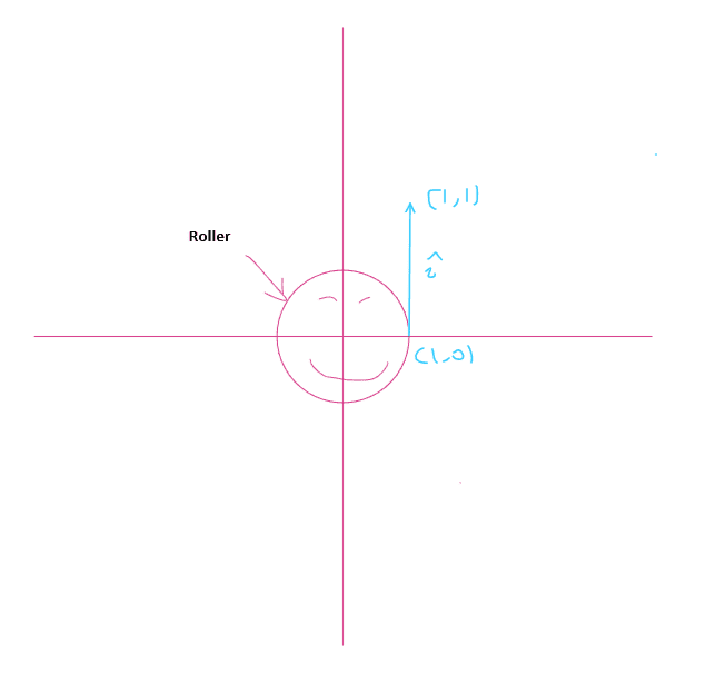

Just one more question -- if a constant tangential force is applied, will it give us a circular trajectory?

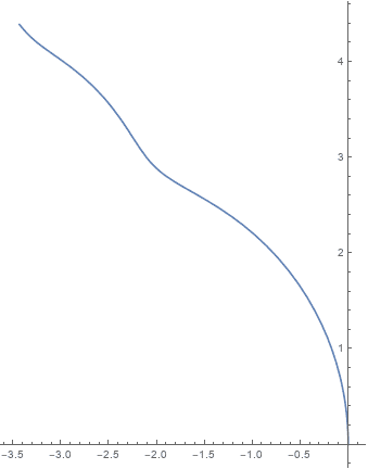

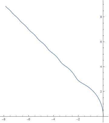

Leo Liu said:
Could you tell me why this implies CM has steady acceleration? Is it translational , rotational, or both?
This is Newton’s 2nd law. The net force on an object is equal to the acceleration of the center of mass of the object times its mass. A steady force therefore implies a steady acceleration of the center of mass.
Likes jbriggs444, Lnewqban and Leo Liu
In a certain sense it is a circular argument. We define the center of mass to make this true by demanding the "moments of mass" about it to be zero. Of course it turns out to always be the center of "gravity" because of equivalency of inertial and gravitational mass.
A tangential force can make a rigid body rotate, if that's what you asking. And it will also accelerate the center of mass of the rigid body, unless there are other external forces that neutralize the first force .
Example: A disk with an axis fixed through its center of mass. If we apply a tangential force at the disk, the disk will start rotating around its center, but the disk will not do translational motion because the tangential force is neutralized from the force that the fixed axis applies to the disk (if we assume that the axis is also fixed to a not moving point) which is opposite and equal to the tangential force. However the rotational effect is not neutralized because the force from the fixed axis has zero torque (w.r.t to the center of the disk) while the tangential force has non-zero torque (w.r.t to the center of the disk).
Things become more interesting if the fixed axis doesn't pass through the CM of the disk but through an other point. Then the rotational effect will still be the same, with regards to the angular acceleration , however the force from the axis now will not be opposite and equal to the tangential force now . The vector sum of the latter two forces will be equal to the mass of the disk times the acceleration of the CM, as theorem 1 states, but now the acceleration of the CM will not be zero, because CM will rotate around the fixed axis which is located at another point of the disk.
