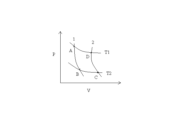

I didn't get you. Could you please explain it in a more simple way? I am herewith attaching a P-V diagram in which I have drawn two adiabatics 1 & 2 between 2 isothermals at temperatures T1 & T2. As we move from A to B in adiabatic 1 and from D to C in adiabatic 2, will the change in temperature be the same i.e. T2 - T1?
Yes, because W = nC_v\Delta T and the temperatures are the same.
If you take some path other than the adiabatic path from A to B the work done will be different. (which simply means that heat is flowing into or out of the system, so it would not be adiabatic).

Do u mean that between 2 isothermals, u can have only one adiabatic? If at we draw another adiabatic between T1 and T2, it will not be adiabatic. But the statement says that the work done between 2 isothermals is independent of the adiabatic. Doesn't this statement mean that the work done for all adiabatics whose initial and final temperatures are same, are equal?
Between two states there is only one reversible adiabatic path. Using the adiabatic condition:
PV^{\gamma} = K \text{and} PdV = - dU = -nC_vdT,
the work done in this process is:
W = \int_{V_i}^{V_f}PdV = \int_{V_i}^{V_f}KV^{-\gamma}dV =<br /> \frac{K(V_f^{1-\gamma}-V_i^{1-\gamma})}{(1-\gamma)} = - \int_{T_i}^{T_f} nC_vdT = - nC_v(T_f - T_i)
If you draw another reversible adiabatic path from A to T2 it will be AB because there is only one reversible adiabatic path from A to T2. If you draw a reversible adiabatic path between some other point on T1 to T2, the work done will be the same. But it is not the same path because the initial and final volumes and pressures are different.
Yes, exactly. It is independent of the adiabatic path between those two isothermals. But for each point on T1 there is only one adiabatic path to T2.
