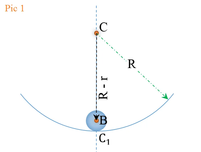

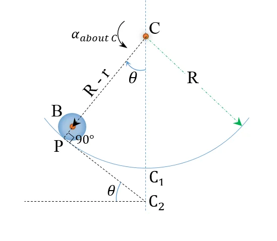

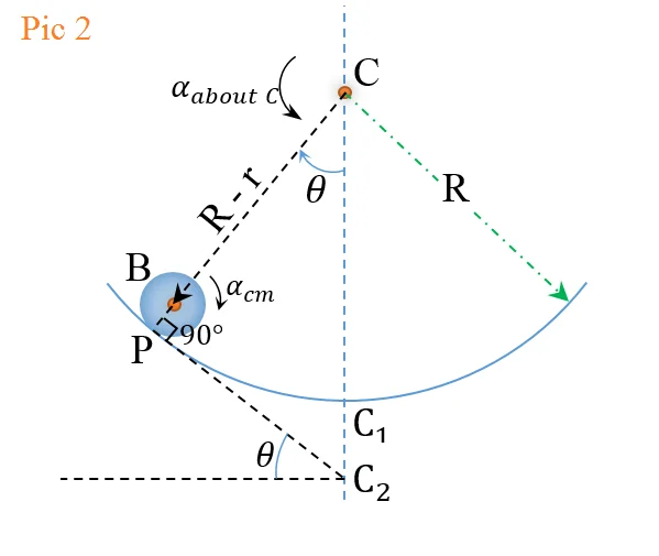

A solid spherical ball of mass m and radius r rolls without slipping on a rough concave surface of
large radius R. Find the magnitude and direction of friction on the ball.
$$ \tau = I\alpha $$, F = ma
Kindly see the attached pdf. My attempt to solve it, is in it.
I'm wondering if my solution is right. My idea is this: At any point of time, the ball may be assumed to be at an incline which is at an angle of θ(kindly see both the pics in the pdf file). The value of θ will continuously change and so will the value of friction.
I'm not able to figure out, why my solution is wrong, if it is wrong .

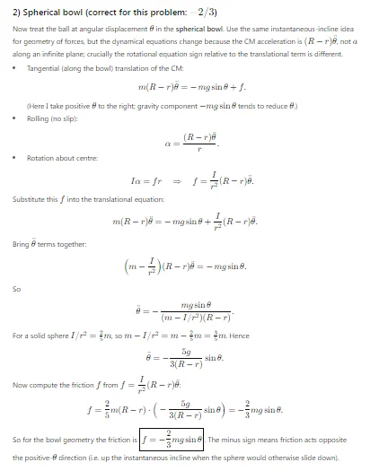

I dont think it is correct. The reason is that when I'm asking AI the same question, it is giving me another answer where the magnitude of ##f = 2mgsinθ/3##. And it shows the calculation too. I can't find fault in the calculation shown by the AI. But I also can't find problem with my calculation. However, both can't be right. Here's the calculation shown by the AI:
I have confirmed your result independently. Will try to locate the error in the AI solution, but rightnowI am a passenger on a very bumpy road!

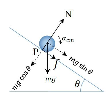

@NTesla, I (very nervously!) suggest that the AI answer is correct.
Friction here, apart from the lowest point, always acts uphill. This means that in your Post #1 pdf attachment:
a) the 2nd diagram is wrong as it shows friction acting downhill;
b) your expression for the acceleration of the ball’s centre of mass:
##a_{cm} = \frac {mg \sin \theta + f}{m}##
should be:
##a_{cm} = \frac {mg \sin \theta – f}{m}##
which, I think, will make your answer the same as the AI.
No, I don't think that's wrong. One can show any direction of frictional force(either up or down the incline) and the calculation will prove which direction friction will take. In my calculation, f has come out negative. And in the pic I've shown f down the incline. This only means that the friction is acting up the incline at all the points on the concave surface, except at the bottom most point, at which the frictional force is zero.
No, it wont. Even if we take your equation for ##a_{cm}##, then we will have to take positive value for the torque due to friction. And we will again end up with the same magnitude of frictional force (= ##2/7 mgsinθ##). Only, this time, the frictional force will come out positive in the calculation. So, we again reach the same value of frictional force.
Ok, here’s what is wrong with the AI solution.
First, "the CM acceleration is ##(R-r)\ddot\theta##, not ##a##” is wrong in that it is both.
Indeed, for this part of the problem it is unnecessary to use the ##(R-r)\ddot\theta## form. We can just change all occurrences of that in the solution to “a” (having defined positive as up the slope).
Next, it fails to specify which sense is being taken as positive for ##\alpha##. From its "Rolling" equation, we can infer that ##\alpha## is positive for rolling accelerating [correction to original post] up the slope, but in that case the upslope frictional force f exerts a negative torque: ##I\alpha=-fr##.
Correcting that leads to your answer.

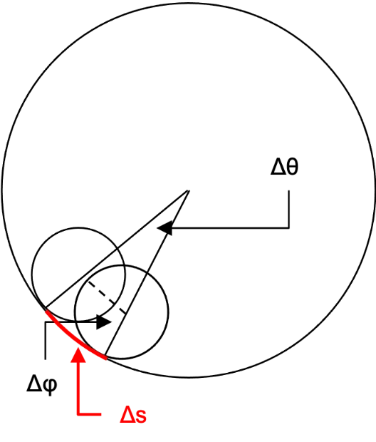

I do not understand the rolling (no-slip) AI equation $$\alpha=\frac{(R-r)\ddot {\theta}}{r}.$$ Here is my reasoning.
The center of the shell, the center of the ball and the point of contact are collinear at all times.
When the ball rolls without slipping on the shell and rotates by angle ##\Delta \varphi##, the point of contact travels by an arc length ##\Delta s = r~ \Delta \varphi## on the surface (see figure on the right).
This arc length is related to the angular displacement of the CM by ##\Delta s =R~ \Delta \theta.##
It follows that $$ r~ \Delta \phi=R~ \Delta \theta \implies \Delta \varphi=\frac{R}{r}\Delta \theta.$$ Now if the definition of ##\alpha## is the angular acceleration about the CM, i.e. ##\ddot {\varphi}~##, then it follows that $$\alpha=\ddot {\varphi}=\frac{R~\ddot{ \theta}}{r}.$$Did I miss something?
No, ##\Delta s## is greater than that because of the curved surface.
Consider e.g. R only marginally greater than r.
