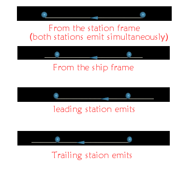

Hi, I'm new so please excuse me if I'm butting in. This is all very interesting but I'd like to add another observer to the seudo experiment. Assuming what Doc Ai and Janus are saying is correct (as far as I understand they are) then we get the following senario.
Let's say there are 2 space stations 450,000k apart. The rocket leaves the first station (call it "a") as outlined already heading towards space station "b". The light is still turned on when the rocket is 300,000k from space station "a".
Now the observer in the rocket sees the light from space station "a" when he is right beside space station "b" . Space station "b" cannot see the light for another 1/2 second.
Now let's suppose that the observer in the rocket has a mirror set up that aligns the light source from space station "a" with our observer at space station "b" as it passes so that he sees the light reflected from the rocket nearly a 1/2 second before he sees the light from space station "a". :surprise:
Hope I didn't botch that up too bad. It makes perfect sense to me (the experiment not the results that is).

plover said:
The observer in the rocket is the equivalent of the person on the railway embankment who sees the flashes simultaneously.
This is incorrect. The observer on the train is the counterpart to me in the rocket.
Please go to the link I edited in in my post above for the complete text of that chapter written by Einstein as well as the diagram referred to.
It is, of course, possible to construct an analogy where the observer on the train corresponds to the person in the rocket. In doing this, however, it is also necessary to state what the station(s) and any other relevant objects correspond to in the train scenario.
If you think the scenario I laid out in my previous post is somehow unfaithful to Einstein's thought experiment, could you explain?
I also note that the quote you give from the article describes what X predicts that Y will see (i.e. it is not a statement from the point of view of Y).
Chapters 10-12 of the Einstein article go over more about length contractions.

There is no mixup: they are identical. The lighning flashes are simultaneous, not to the embankment in general, but at one specific spot: the exact midpoint M between point A and point B. Einstein: "When we say that the lightning strokes A and B are simultaneous with respect to the embankment, we mean: the rays of light emitted at the places A and B, where the lightning occurs, meet each other at the mid-point M of the length A---->B of the embankment."
This mid-point M corresponds to the distance 300,000 kms from the space station in my rocket example because the light is emitted, in the train scenario, exactly at the moment the observer on the train is at the mid-point M between the two points. The observer continues to move and encounters the flash from B before the flash from A by his own reckoning not as seen from the embankment. The flash he perceives from point B corresponds to the flash from the space station as my rocket approaches it, (or it approaches my rocket if you want to define it that way) and the flash from point A corresponds to the flash from the space station as I am moving away from it (or it away from me).
The mid point M in the train scenario corresponds to the distance 300,000 kms in the rocket scenario because it is the same distance in the example where the station is approaching me, and also in the example where the station is moving away from me. In both cases the station emits light when the distance bewteen the station and my ship is 300,000 kms.
To make this as clear as possible let's say that when the distance between point A and point B in the train scenario was measured it proved to be exactly 600,000 kms. The midpoint, therefore, is located 300,000 kms from both A and B. Any value for the distance will do as long as point M is exactly midway between A and B. Using 300,000 kms helps you to see how the rocket example is the same as the train.
In Einstein's example, embankment observers see the light from B approach them at speed c. And they also see the train moving towards B. So they agree that the light from B reaches the train before it reaches the midpoint of the embankment. Everyone agrees that the train sees the light from B before the light from A.
In Einstein's example any observation anyone on the embankment might have about what the observer on the train sees is unimportant, and Einstein doesn't even mention it. What is important about any person on the embankment is that they will see the flashes of light from both directions at exactly the same time. That is important because Einstein wants to contrast it with what the observer on the train will see.
It is important to note that when the flashes occur, the observer on the train is located at the midpoint M between the two flashes. However, he moves away from that spot before the flashes arrive. The result is that he detects flash B before flash A, in spite of the fact he was at the midpoint when they occured!
By this reasoning, I would not detect the light beam from the space station, emitted when the distance between my rocket and the station was 300,000 kms, to be 1 sec, in any case of relative motion toward or away from the station (or it toward or away from me) By Einstein's reasoning, I will detect it in less than a second when the distance between my ship and the station is closing at .5c, and I will detect it in some time greater than 1 sec. when the distance between my ship and the station is widening at .5 c.
Again, If I detect it to be 1 sec coming or going Einstein has no basis upon which to build his case for what he calls The Relativity of Simultaneity.
