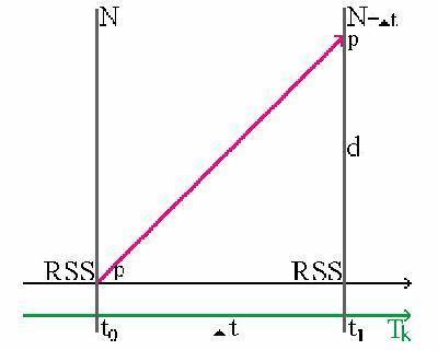

Below is an excerpt (Chapter 12) from my upcoming book, "Space, Time and Elementary Particles. (Proof in chapers 13 and 14, not attached)
Chapter 12 The Speed of Light and Space-Time
c = d / [(t2-t0) / 2]
The speed of light is measured with the Fizoau procedure (for Armand Hippolyte Louis Fizoau (1819-1896) a French physicist who, as one of his many accomplishments, was the first to measure accurately the velocity of light (on Earth) in 1849. The following is a description of the Fizoau procedure.
Definition: The speed of light is the speed of propagation of electromagnetic waves in a vacuum, which is a physical constant equal to exactly 299 792.458 km/s.
McGraw-Hill Dictionary of Scientific & Technical Terms
The Fizoau procedure takes a beam of light, bounces it off a mirror a measured distance away and then divides that distance by one-half of the measured time for the round trip: d / [(t2 - t0) / 2]. A photon is emitted from RSX at time t0 toward the mirror M that reflects the photon at time t1. RSX sees the photon at time t2. Since the speed of light is a constant, the two world lines of the photon (RSXt0 to Mt1 and Mt1 to RSXt2) are equal.
Fizoau set up an apparatus, which consisted of a rapidly spinning wheel with tooth gaps evenly spaced around the edge of the wheel. At a point (RSX), Fizoau directed a beam of light through the gaps at the edge of the rapidly rotating wheel towards a mirror eight kilometers away. The speed of the wheel was adjusted until the returning light could be seen through the next gap. Fizoau, by measuring exactly how fast the wheel was turning, could calculate an exact time for one gap on the edge of the wheel to be replaced at a specific location by the next gap around the edge of the wheel. After taking many readings, Fizoau calculated the speed of light to be 315,000 kilometers per second. Leon Foucault improved on that measurement a year later by using rotating mirrors and attained a speed of 298,000 kilometers per second. Foucault’s technique was accurate enough to confirm that light travels slower in water than in air.
Different forms of Fizoau’s experiment have been carried out many times over the years with a longer or shorter distance d, using a different frequency of photon, at different locations on the earth, at different times of day, with different positions for the apparatus and with different reference systems in motion relative to each other. The answer is always 299,792.458 kilometers per second exactly (in a vacuum). The speed of light is a constant for all observers that are in motion with a constant velocity.
The speed of light is an exact measurement: 299,792,458 meters per second exactly (in a vacuum) but that exactness is not by accident. Galileo has been credited with being the first scientist to try to measure the speed of light. Galileo used a lamp that he could uncover and when his assistant, at some distance away, saw the light from Galileo’s lamp, the assistant uncovered his own lamp. By knowing the distance between himself and his assistant and by measuring the elapsed time (Galileo had to use a clepsydra, a water clock, to measure the time interval) until he saw his assistant’s lamp, Galileo tried to calculate the speed of the light beams. Galileo concluded that if light is not “instantaneous, it is extraordinarily rapid.” This was in 1667 and Galileo figured that the speed of light was at least ten times faster than the speed of sound. (Actually, the speed of light is almost nine-hundred thousand times faster than the speed of sound.)
In 1675, the Danish astronomer Ole Roemer measured the speed of light. The astronomer noticed that the eclipses of the moons of Jupiter changed with the relative positions of Jupiter and Earth. When Earth was closer to Jupiter, the eclipses happened sooner than when Jupiter was far from Earth. The time difference between when the moons of Jupiter were expected to eclipse and when they did eclipse was up to sixteen minutes. Roemer reasoned that the change was caused by the greater distance that light had to travel when Earth was farther from Jupiter. Using the then accepted distances between the orbits, he calculated that the speed of light to be 225,000 kilometers per second.
After Fizoau made his measurement in 1849, Foucault and other experimenters began measuring the speed of light with greater precision. As the speed of light was measured with increased precision, the definition of a meter and of a second had to be defined with greater precision.
Historically, the meter was defined by the French Academy of Sciences as 1/10,000,000 of the distance from Earth’s North Pole to the equator on a line that ran through the city of Paris. This definition was replaced 1874 and refined in 1889 by an exact measurement between two marks on a bar of 90% platinum/10 % iridium that was kept in a vault in Paris. Then in 1960, the meter was re-defined as 1,650,763.73 wavelengths of the emissions of the gas Krypton. In 1983, a meter was re-defined again as the distance that light travels in a vacuum in 1/299,792,458th of a second. Then, to define a second, there had to be very accurate clocks. In 1955, the first atomic clock was built and refined in 1958. 1967, the 13th General Conference on Weights and Measures first defined the International System (SI) and a second was defined by 9,192,631,770 periods of the radiation of the cesium-133 atom. These clocks provide an accuracy of 2 nanoseconds per day or one second in 1,400,000 years.
The meter went from being defined as a distance in space (1/10,000,000 of the distance from the North Pole to the equator) to being defined as a measure of time (1/299,792,458th of a second) which can be equated, with the speed of light, into a distance in space.
c = d / [(t2-t0) / 2] When t2 – t0 is 2/299,792,458 seconds, d is defined as 1 meter.
The exact length of a meter is a fraction of space-time.
By international standards, a second is defined as the duration of 9,192,631,770 periods of the radiation corresponding to the transition between two hyperfine levels of the ground state of the cesium-133 atom.
Over a distance in time of one meter, the radiation of the cesium-133 atom oscillates 30.663319 times (1/299,792,458 of a second, times 9,192,631,770 Hz/sec. = 30.663319 Hz).
The oscillation of one wavelength equates to a distance of 1.087827757*10-10 seconds on Tk.
Or, one wavelength as measured as a metric distance on Tk is 3.261225571 centimeters.
Measuring Time in Units of Distance
Minkowski described the space-time continuum as an inseperate union and he used the complex configuration (√-1) for time measurement to allow time to be considered as the forth dimension equal to the three spatial dimensions: (ds)2 = x2 + y2 + z2 + tk2. However, space and time are measured in different units. By international convention, the units that are used around the world for scientific discussion are standardized: the meter/kilogram/second standard is used to measure length, mass and time. However, for any unit of distance that is chosen to measure space, a corresponding unit of distance can be used to measured time.
Thus, to change seconds into meters, the time interval in seconds is multiplied by the speed of light measured in meters per second.
c = 299,792,458 meters per second.
▲t = 1 second. c * ▲t = 299,792,458 m/s * 1 second. Then ▲t equals 299,792,458 meters.
▲t = 1/299,792,458th of a second.
c * ▲t = 299,792,458 m/s * 1/299 792 458 second. Then ▲t equals 1 meter.
When t is measured in seconds, a formula to measure a distance, ds, in space-time may be written as ds2 = x2 + y2 + z2 + c2t2 and the time interval conversion is positioned in the formula. In a space-time diagram, when using equal scales of space and time, one unit of space equaling one unit of time, the time units are directly convertible into spatial units. When one unit on the spatial axes is measured as one meter, then ▲t is equal to one meter on the Tk axis (time axis in the forth dimension). Whatever units the speed of light is measured in; meters, miles or cubits, the forth dimension can be measured in exactly the same units.
When ▲t on Tk, is measured as one second, then the passage of space through time, N to N+1sec., has progressed through 299,792.458 kilometers of the forth-dimension.
https://www.physicsforums.com/attachment.php?attachmentid=1165&stc=1
With distance in the forth dimension measured the same as distance is measured in space, a time interval that is measured as one second is equal to 299,792.458 kilometers on Tk. The corollary is that three-dimensional space, N, progresses to N+▲t through the forth-dimension at 299,792.458 km per second measured on Tk. Space, all of space, is physically moving through the forth dimension of time. The speed of light reflects the velocity of space through the forth dimension. Any observer in any reference system is measuring the velocity of N as N progresses to N+▲t when they measure the speed of light.
Space travels through the forth dimension in one direction. This forward direction creates the progression of our existence from the present to the future. As three-dimensional space progresses through the forth dimension from N to N+299 792 458 m, the clocks in RSS (Reference System Space)register one second. Other reference systems that have a velocity reference to RSS will measure space and time differently than RSS (the Lorentz transformations), but every reference system that maintains a continuous existence in space progresses through time with RSS into the future in N to N+▲t.
