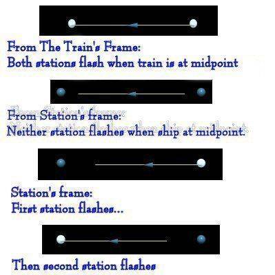

Maybe the attached images will help.
Let's assume that you have two space stations and a rocket. the rocket is traveling from one space station to another. Leading and trailing the rocket is a line that extends an equal distance in both directions. on the end of each line is a device that will trigger a flash of light from each station as it passes the station. The length of the lines are such that, from both station's frame of reference, each end of a line touches a station when the rocket is midway between the stations (first image of the attachment).
Now let's look at the same situation from the frame of the rocket. Length contraction has shortened the distance between the stations, so now the ends of the lines extend past the stations positions when the rocket is at the midpoint. (second image) Since the stations will not emit the flashes of light until triggered by the ends of the line(the ends of the line physically trigger the flash), they do not do so when the rocket is at midpoint (according to the rocket).
Instead we see what is shown in the next two images. First the leadiing end of the wire triggers a flash from the station ahead of the rocket, and then sometime later, the trailing end of the line triggers the station behind the rocket.
Thus the events of the station emitting the flashes are simultaneous in the station frame, but not simultaneous in the rocket frame.

  • #51
Note also that it is the station frame where the length of the line corresponds to the distance between stations. Since the station frame sees the line as length contracted, the rocket frame, in addition to measuring the distance between stations as shorter, also measures the line to be longer.

  • #53
The situation you describe is extremely interesting, and I find it to be an excellent lesson in length contraction. I haven't had much occasion to think about the length contraction of something large as viewed from something small. I've really only thought about it in terms of Einstein's measuring rods getting shortened. So, by using this example of the ship with filaments you and Plover have gotten me thinking about how, when a ship is traveling at an appreciable fraction of c the very length of the distance it is traveling shrinks from its perspective.
Thank you for putting the graphics together. They, and your verbal description, are quite clear; easy to follow.
However, as I said to Plover when he brought this up, I don't think this particular example can be used to account for why Einstein maintains the observer on his train will see one flash before the other. The reason is that in your example he will not be at point M when the flashes occur, but somewhere else. Einstein is particularly specific in pointing out that the observer on the train will be at point M when the flashes occur: "Let M' be the mid-point of the distance A--->B on the traveling train. Just when the flashes of lightning occur (as judged from the embankment) this point M' naturally coincides with the point M, but it moves toward the right in the diagram with the velocity v of the train."

  • #54

  • #60
zoobyshoe said:
I suggested a means to plover whereby this condition could be fullfilled, to my satisfaction anyway (he hasn't given his reaction) which would be to have a rod sticking out of the side of the train right where the train rider is seated. This rod would make contact with a switch located at point M on the embankment. The switch, when thrown by the rod would send an impulse (of magic, instantaneous energy) to the lights at A and B causing them to flash. In this way, we should be able to be assured that M' is at M when the lights flash.
I hope you realize that introducing a method of instantaneous transmission violates the very principles we are trying to clarify. The best we could do is place such rods an equal distance ahead of and behind the train rider, space so that when form the rider's perspctive, these rods trigger switches at the stations themselves which initiate the the flashes at each station.
This just gives us the reverse situation as we had in the last set of images I made.
This time, from the embankment frame, the ends where the poles don't even reach to the stations when the ship is at the midpoint. (image 2)
So the sequence from the embankment would go like this:
First the trailing station is switched on (third image) and then the leading station is triggered (fourth image).
Thus taking both this and the earlier attachment into account, one sees that the stations can either flash simultaneously in the station frame and not so in the train frame, or they can flash simultaneously in the train frame, but not in the station frame. But they cannot flash simultaneously in both frames. (assuming that each staion is only triggered once)

  • A' coincides with A at the moment of the flashes.
  • B' coincides with B at the moment of the flashes.
  • M' coincides with M at the moment of the flashes.
  • M' is somewhere to the right of M at the moment it passes the flash from B, and somewhere further to the right when the flash from A passes it.
As noted in EP(4) the only frame for which "the moment of the flashes" is defined is the embankment frame. Indeed the conclusion of the argument is that the phrase "the moment of the flashes" turns out to be nonsensical in the train frame.
To make the complaint that an observer at M' "will not be at point M when the flashes occur" is to anticipate the argument by using an assumption about time in the train frame as a premise rather than a conclusion.
zoobyshoe said:
And if we're in any doubt as to which rest frame Einstein means when he says M' coincides with [/i]M[/i], he makes it specifically clear that he means, at that instant, in both rest frames:"If an observer sitting at M' in the train did not possesses this velocity, then he would remain permantly at [/M] and the light rays emitted by the flashes of lightning A and B would reach him simultaneously, i.e. they would meet just where he is situated."
There is a moment when M and M' coincide.
In each reference frame it happens at the particular moment when the two points coincide (however that moment is defined by clocks located in the respective frames).
The two points do not continue to coincide because they are in different frames.
In the embankment frame, that moment also happens to be the one when the flashes occur. There is nothing in the sentence you quote that warrants saying anything about the flashes in the train reference frame. The path of the argument is, in fact, to lead you to the conclusion that our knowledge about the flashes in the embankment frame forces the conclusion that they will not be considered simultaneous in the train frame.
At this stage of the argument, there is no point where the position of the observer at M' can be defined - as considered from the train reference frame - when either flash occurs.
The only point under consideration is whether our knowledge of the simultaneity of the flashes in the embankment reference frame allows us to maintain that they will also be simultaneous in the train reference frame. And of course, as it turns out, we may not maintain that.
