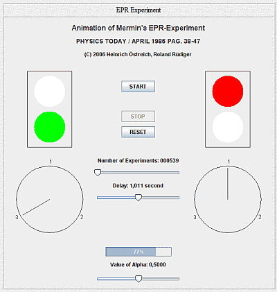

Run this Java applet:
"[URL Mermin's EPR gedanken experiment animated[/B]
[/URL]
...and you see why this is also wrong...
