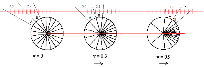

Method Using the Aberration:
I found a nice diagram of the aberration equation here: http://www.mathpages.com/rr/s2-05/2-05.htm which helps me make my point without a lot of math.
It appears to me, that even using the aberration equations, the Lorentz Contraction is visible, and for certain, it cannot be said that "all objects will appear normal" as Terrell claims.
In the attached diagram you can see that the length of the ruler swept out by angle A is approximately 5.5 units when in the original frame, but it is contracted to 3.6 units when the observer is going 50% of the speed of light, and to 3.1 units when the observer is going 90% of the speed of light.
The length of ruler swept out by angle B is 2.8 units, but contracted to 2.1 units when the observer is going 50% of the speed of light. However, when you go 90% of the speed of light, yes, there is ONE angle where the apparent length of the ruler is equal to the original length.
But Terrell's statements seem to indicate that he believes the "objects will appear normal" regardless of the angle viewed, which is simply not true.

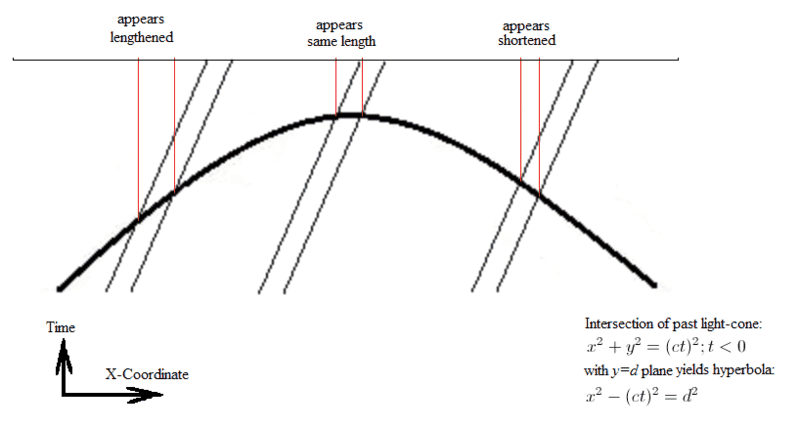

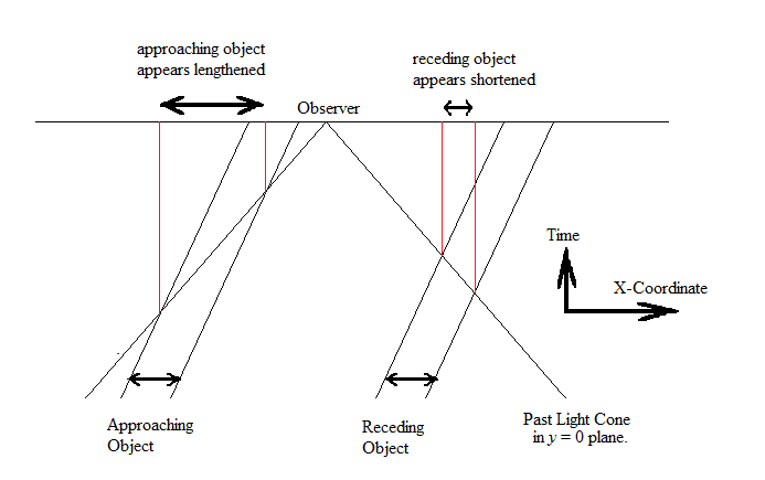

JDoolin said:
The main axiom I'm using here is that the current apparent position of an object according to an observer, is the positional component (in the observer's current rest frame) of the intersection of the objects world-line (or curve) with the [surface of] the observer's current past light cone.
So the attached diagrams show first, a one-dimensional object passing in the y=0 plane. In this plane, the distortion is always present.
In the second diagram, a one-dimensional object is passing in the y=d plane. In the y=d plane, there is a small region where there is no significant distortion between the "actual" length-contracted shape, and the "apparent" shape.

Maybe I should clarify that I am talking about the SURFACE of the light cone. I think the point you're missing is that the surface of the past light-cone with its point at (0,0,0,0) is the locus of events which can be detected at the event (0,0,0,0). This fact remains the same, regardless of the observer's reference frame.
I hope you can understand that the observer can see the locus of events on the surface of his or her past light-cone. The tip of the light-cone is the event where the information arrives. It is not a remote event, but THE local event. Naturally, it is also the one event which does not move when you perform a lorentz transformation. All of the other events move, but any event which is in the surface of the past light-cone stays in the surface of the past light-cone.
(If you have any doubt on this, think, how could it be otherwise? How could light that is arriving at an event (0,0,0,0) in one reference frame be NOT arriving at the event (0,0,0,0); the same exact event, in another reference frame? Also you can check the before and after transformation coordinates in my spreadsheet files, to check that indeed t' = -sqrt(x'^2+y'^2).)

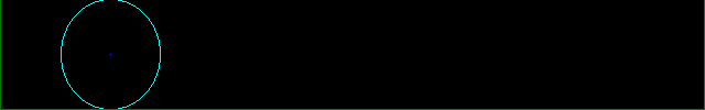

JDoolin said:
TThe animation on this page makes it show up better than in my diagram above.
http://www.spoonfedrelativity.com/pages/Is-Lorentz-Contraction-Invisible.php
The simplifying idea that I would offer is that you should take the intersection of the world-lines making up the passing object, and find where they intersect with the observers' past light cone.
Just for the record, here is a hard to find Wikipedia page with similar animations, and here is the page it was linked from.
Likes JDoolin

What is strange here, however, is that an elementary argument defeats the claim that "length contraction is invisible", yet a more sweeping mathematical argument results in that claim. What's also odd is that Baez says, via that same analysis, that shapes are preserved, but not apparent sizes, yet he never balks at the claim "length contraction is invisible" (even though it is in the title of his second reference). This would seem to be a record of inconsistencies that normally do not go so unnoticed. Are people just giving Terrell a "pass" on his misleading title? Because there are websites out there that continue to promote the claim that it is a well-established physical truth that "length contraction is invisible."
Likes JDoolin
I have always felt Terrell's title was simply wrong. I have never had the opportunity to read his whole paper. Penrose is much narrower in his claims: that a circle always looks like a circle. He never makes a claim that length contraction in general is invisible.
Likes JDoolin
Yeah, it's pretty much the same except for the choice of where the circle comes through.
He chose to have the circle move right through the origin (the observer) so you get that lima-bean shape when the back end of the circle reaches the observer.

PAllen said:
I have done the math on this, spefically for a ruler passing you by, at some distance away. What I find is that there is point of minimum apparent size which matches Lorentz contraction, and (at that moment) the ruler divisions toward the front are stretched, toward the back are compressed,
Are you sure it's not the other way around? The back (still approaching) should look stretched, and the front (already receding) should look compressed. See Fig.1 here:
http://www.spacetimetravel.org/bewegung/bewegung3.html
Likes JDoolin

Wait-- I finally understand something I've been missing, and I think this justifies Terrell's title. It all has to do with what "visible" means, as well as what "over a small enough angle" means. Terrell is right, we just have to understand what he is saying. First of all, in my simple case of a rod passing the point of closest approach, it is clear that the rod appears length contracted-- but only if you know how far away it is! So I've been including things that Terrell does not-- I've been including knowledge of the distance to the "string" that the rod is sliding along, perhaps via binocular vision of our eyes. But Terrell is pointing out that you don't get that information in a photograph-- it can't tell you how far the image is, so its overall size is ambiguous, all you "see" is the shape. And shapes are preserved!
So if we look at the photograph of the rod whose tickmarks are distorted, the photograph cannot tell us that the rod is all at a fixed distance. It could be a rod that is much longer than that, and some parts of it are farther from us than others-- that's what he means by "invisible." You have to have other information, like that the rod is all the same distance from us, things a photograph cannot tell you. So it's a much more limited meaning of "visible" than what we have been using, but it is literally correct, because all you know from a photograph is the shapes of the images, and that's what is preserved. (Also, he puts in that the angular size needs to be small, so even comparisons of sizes from place to place in the photo are disallowed, you cannot compare one tickmark to another without violating his stated restriction, you can only look at things that are invariant of scale so can be as small as you like-- and again that is shape only.)
So I think the bottom line is, the statement really only ever was that "length contraction keeps shapes invariant", and since scales are a matter of interpretation in a photograph, the contraction is literally "invisible", though in most practical applications we would say that we are still "seeing" it.
