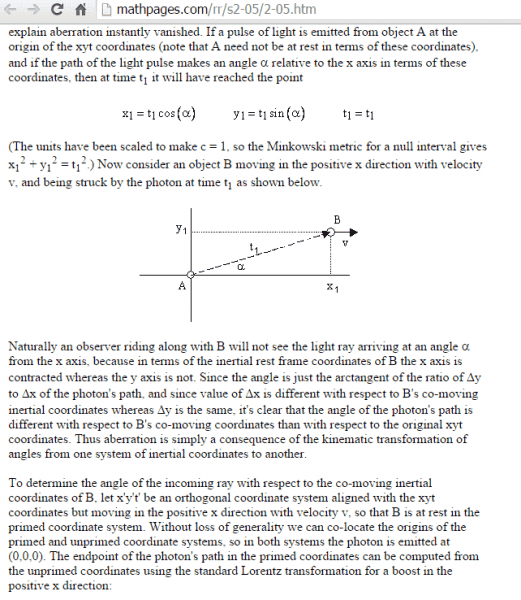

The amount of distortion has more to do with the angular measure of the object than the distance. (The angular measure becomes LARGER when you're close.) If the object is close enough that the angular measure is greater than about 15 degrees, where you can no longer use the small angle approximation [tex]\theta \approx \sin \theta \approx \tan \theta[/tex] I think you'll find that you would see significant differences in the compression of the front end of the object (which would be contracted) and the back end of the object (which would be stretched out.)
This phenomenon of having the front end contracted and the back end stretched out would always be present, but as long as you have the whole object fit within a "small angle" as it made its closest approach, I think the effect would be negligible.
I personally don't like the term "aberration" when it is applied to Special Relativity. Because it implies some kind of "illusory quality" to what is going on in "observer dependent measurements of distance" and it implies that there could or should be some "actual non observer dependent measurements of distance."

Although, I suppose aberration wouldn't necessarily have to imply "illusionary" Rather, aberration would be that sort of funny-looking shape you get when you take an extended relativistically traveling object and find its intersection with the observer's past light-cone.
Whereas the non-aberration shape of the object would be the shape you get when you take an extended object and find its intersection with the observer's t=0 plane.
But the location of the events which produce the "aberration effect" are the real locations of events.
For example, if I see an object coming at me at 99% of the speed of light, it's image appears to be moving toward me superluminally. But the actual events I am seeing are at the distances they appear to be. That the object is coming toward me at superluminal speeds might be an illusion. But that the events occurred at the distances where they seem to have occurred is NOT an illusion.
That the object is stretched out might be an illusion, but that the observed events occurred where they appear to have occurred in my reference frame is NOT an illusion.

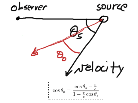

Is it the angle of reception?
I may be misunderstanding the equation for aberration but look at the following diagram
Now there's nothing wrong with the math here, insofar as it goes:
"the source is moving with speed
at an angle
relative to the vector from the observer to the source at the time when the light is emitted. Then the following formula, which was derived by Einstein in 1905, describes the aberration of the light source, [PLAIN]http://upload.wikimedia.org/math/3/9/9/39994abba112928ccc9e9d70a502fb93.png, measured by the observer:"
I think that the hardest thing to do is to figure out what these angles mean verbally and intuitively. For instance the light that goes along that "measured observed angle" never actually hits the observer along the vector between the observer and the source. It's just where the light passes through the observers reference frame.
Now, if you're sophisticated in it enough that you've thought through all this, more power to you. But as for me, I find the idea of finding the location of the object according to the intersection of past-light-cones with the worldlines of the object much more intuitive.
Rather than figuring out where a particular aimed vector of light passes through your reference frame, it figures out the locus of events being seen from a particular point in space and time.
  • #55

How do you derive the aberration equation?
[tex]\cos \theta_o=\frac{\cos \theta_s-\frac{v}{c}}{1-\frac{v}{c} \cos \theta_s}[/tex]
You'll see I posted a quote from the wikipedia article about it from above... But the more I think about it, I start to think this might be the source of the problem in Terrell's paper.
From Wikipedia: ""the source is moving with speed
at an angle
Now my reading of this is that the light is emitted along a "tube" that is aimed directly toward the observer in the reference frame of the observer when the source is at the given point.
The trouble is that if the "tube" is aimed directly toward the observer, in the reference frame of the observer, you're looking at the situation Post-Lorentz-Contraction. That is [itex]\theta_s[/itex] is not the angle of the tube in the source's reference frame, but the angle of the tube in the observer's reference frame. So this equation is not relating a difference between appearances in the source's reference frame and the observer's reference frame.
Rather, it is relating a difference between two different angles measured in the observer's reference frame.
If I were to try to confirm this, I would probably try to set up a diagram similar to the one I gave in post 54, and do some vector and trigonometric calculations, dividing the velocities into well-chosen x and y components, setting the final speed of the photon through the moving tube at c, and see if I could reproduce the aberration equation from scratch.
My point is, I don't think you would find any evidence of Lorentz Contraction in the aberration equation, because the aberration equation may simply be figuring out the direction at which rays travel from already lorentz-contracted tubes.
