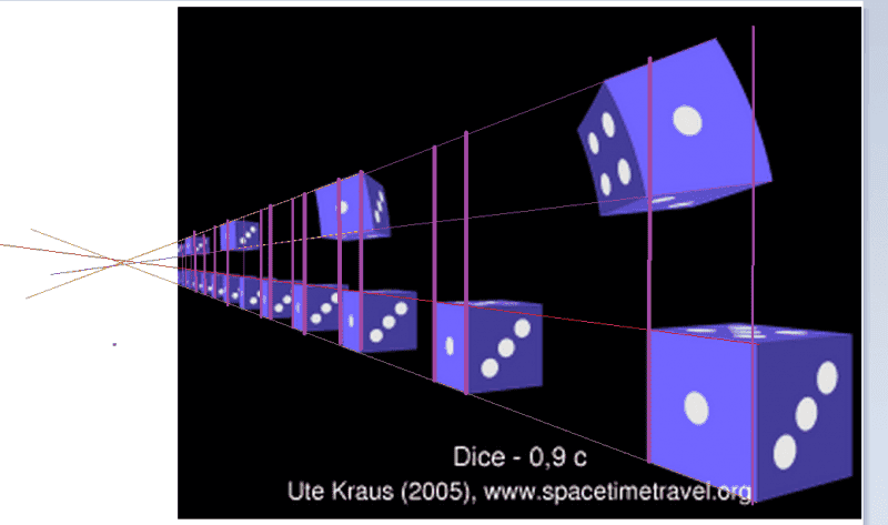

I have been thinking today about modeling an asterisk-shaped model. A set of eight or more tubes that would show the light paths as they came out of it, as well as the Lorentz contracted moving structure.
What I'd want to show is an animation of the paths of the light following the paths predicted by the aberration equation:
(Image from http://mathpages.com/rr/s2-05/2-05.htm )
But at the same time as it shows those paths of light, it should be showing overlying simply Lorentz contracted structure of the object.
Here, I just made this video showing the concept... Showing how the tubes of the source can be pointed one way in the observer's reference frame, while the actual photo paths can be pointing in an entirely different way. It's pretty sloppy, but I think, at least, it gets the idea across.

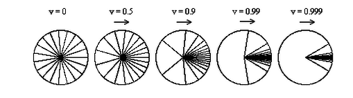

All right, thanks to everyone for clearing that up for me, I was definitely making aberration too difficult. My bad.
Anyway, I think I see that Baez is right, though Terrell's "invisibility" claim is still a bit of a stretch-- two cameras in relative motion that image the same object at the same place and time will always image the same shape, it will just appear to be in a different direction, and it can also have a different total angular size.
If how that could be is still as unclear to anyone else as it was to me, consider Baez' two pinhole cameras, taking a picture when at the same place and time, but this time let's put the "plus sign" a little ahead of the camera that is tracking its motion, such that when the two cameras coincide, the stationary camera takes an image of the plus sign apparently at its point of closest approach. The plus sign is riding on a string through its horizontal piece, and the moving camera is trailing it on a parallel string that passes through the stationary camera.
So if the plus sign is moving left to right, this of course means the plus sign is really a bit to the right of the point of closest approach at the moment the cameras coincide and snap their photos. We know that the image from the stationary camera will show a length contracted horizontal piece, because we agree that there we can correctly reckon that it is length contracted. The moving camera, on the other hand, sees the plus sign as being a little rotated, because it is trailing it a bit, so the photo in the moving camera will also have a shortened horizontal piece. Baez is saying that the amount it will be shortened in this example is exactly the Lorentz factor, such that the shapes of the plus signs will be the same in the two photos. So to get the moving camera to coincide with the stationary one when the stationary one needs to snap this photo, the moving camera must trail the plus sign by exactly the angle needed to make the plus sign look Lorentz contracted. That the two images look the same is the basis for saying length contraction is "invisible"-- it's an ambiguity between whether the visible length contraction is real as for the stationary camera, or due to rotation as for the moving camera, when just looking at the "literal" images. This would seem to be a special feature of Lorentz contraction, perhaps an equivalent way to assert the postulates of relativity.

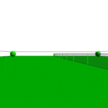

I was previously going to point out a couple of no-cost programs that illustrate all the relevant effects (aberration/doppler/headlight); I now have the full information so here goes (search the web if you need to know more about what they do):
1. Real-time relativity. Windows/Mac downloads but runs under Wine in Linux. The author's SR primer is here.
2. A slower speed of light, Windows/Mac/Linux. Testbed for MIT's SR game framework, now starting to look like abandonware.

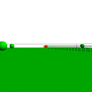

http://people.physics.anu.edu.au/~cms130/RTR/Physicist.html
"The 2D screen image is created using the computer graphics technique known as environment mapping, which renders the 3D virtual world onto a 2D cube map."
I'm not sure if this accounts for differential signal delays, which are key to the visual effects for close passing by objects discussed here. It depends how it "renders the 3D virtual world onto a 2D cube map". The 4D-raytracing approach seems to be the most general to me.
  • #85
JDoolin said:
So if by isotropic you mean "the same speed"
This.
Likes JDoolin
  • #86
Ken G said:
No, I agree that the standard meaning of "see" is much broader than the limited meaning applied by Terrell. And I appreciate your efforts to elucidate all the various factors here!
What I'm actually saying is that it is the conclusion of Baez that appears to be correct, and I did not see that before. Baez' claim is that two cameras taking a picture at the same place and time will always photograph small shapes the same. The shapes may appear at different places in the visual field if one of the cameras is subject to aberration, and there can also be some changes in total angular size relating to similar issues, but the two shapes will be the same, i.e., a plus sign seen as having a given contrast in the lengths of its pieces in one photograph will have that same contrast in the other photograph as well, and that would not be true in Galilean relativity it seems. How to express that fact in words is a bit tricky!
And I claim that is false and provable from my detailed analysis of the moving rod. If you had a cross (with equal arms in its rest frame) with one arm in the direction of motion, then there would be one moment where the length of one arm would be shorter by gamma than the other arm. A camera at rest with respect to the cross at the same time would not see this. This is actually in agreement with Terrell (but not Baez if you quote him correctly). Terrell would say that the moving cross looks rotated such that one arm does have shorter angular span than the other. My analysis agrees with rotation (as one possible visual interpretation) in that the markings on the shorter arm would be stretched on one side and compressed on the other in a way that precisely matches rotation. However, if you imagined this arm parallel to motion as hollow, moving along rigid rod at rest with respect to the camera, you would be forced to re-interpret the same image as contraction with stretching and compression, because rotation could no longer be sustained as a visual interpretation. Penrose actually makes this point in his book "Road to Reality" that the rotation interpretation would interfered with if you introduce other objects moving at different speeds (he mentioned a track rather than hollowed out arm I proposed).
[I used brute force ray tracing in my analysis with no prior assumptions. I posted the resulting formulas, but not the derivation. If I have time at some point, I may post the derivation (it is actually only a page long on my hand written sheet). ]
[Edit1: One caveat, is that I have not analyzed the image for the camera co-moving with the cross, located at the same place and time as the camera taking the image I described above. It is possible that such an analysis could vindicate Baez as follows: in the frame of this camera co-moving with the cross, the cross is not being viewed head on, but substantially displaced; that is, at rest but far from head on in the direction of one arm. Then that arm would subtend less angle, and show distortion consistent with rotation. If that is the case, then Baez is vindicated (in the sense that both cameras would see a distorted cross). Again, if I have time in the future I will try to check whether this is what occurs. At this moment, I am suspecting that it does, and Baez is right, but in a different sense than Ken G. implies above.]
[Edit2: Further, if I am right in how Baez is correct in a certain sense, the if you start from a camera at rest with respect to the cross looking head on, and ask about a camera passing by at high speed snapping at that moment, what it would see is a non-distorted cross shifted a good distance forward, such that the light delay induced stretching compensates for the length contraction. Thus, a big part of this is simply that what one camera sees as 'head on' the other [momentarily colocated camera] sees as displaced in such a way that the combination of effects (displacement, light delay, contraction) preserves the shape.
So, while this is all interesting, it remains true for watching the cross go by:
1) There will be a time when one of its arms is shorter by gamma (and, at this time, it will look like it is being viewed head on - equidistant on either side of your line of sight). It is really hard for me to accept any definition of 'seeing' that doesn't call this directly seeing length contraction (despite the somewhat perverse way Baez's claim may remain true, as outlined in edit1).
2) At all times, length contraction is visible in the obvious way that if you account for light delays without assuming length contraction, you predict the wrong image. Thus what you see is at all times directly seeing what is expected by length contraction, and not what you would see without it.

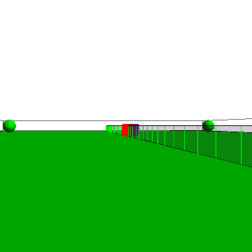

I just now played a slower speed of light, on my machine... Although my graphics card is woefully insufficient for smooth graphics, I was able to get through the game at lowest resolution and some choppy graphics. I thought it was quite nice; artistically done, and enjoyable and probably a lot more fun on a gaming computer. There was a question I have related to the graphics though.
When I got up to 30, 40, 50 percent of the speed of light, I was happy to find, as I would expect, that when I accelerated toward objects, they immediiately receded into the background, and when I backed up, the objects sprang forward. That is totally what I would have expected from aberration.
However, I was trying hard to watch the cross-section of objects against the ground. While the ground in front of me, itself, stretched out significantly, the actual mushroom and hut cross-sections against the ground did not seem to be stretched. So I'm wondering if I'm actually seeing the phenomenon that Penrose, Terrell and/or Baez is talking about? Or did the programmers shortcut the rendering of the huts, and just render them as circular huts and circular mushrooms? If the demonstration represents an accurate rendering, I'll have to eat my words... But I can't imagine How could the ground appear stretched, while the objects along the ground do not appear stretched by the same ratio?
I couldn't see any aberration in the shapes of individual objects until the very end, when I collected the final watermelon. Then the aberration in the yz-plane (away and vertical) became plainly visible. However, I still don't think I saw aberration in the xy-plane. (away and horizontal.)

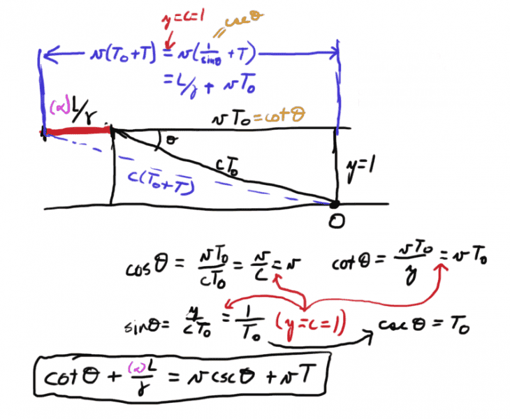

Yes, I originally thought that had to make Baez wrong. But it's not something he would likely get wrong, so it's very odd. I agree that if you put the moving camera right across from the moving cross, it has to see a symmetric cross at all times. But it certainly doesn't seem like the stationary camera will see a symmetric cross when the two cameras coincide in that case (though I suggested a different case where it seems like they might both see a contracted horizontal arm), because in this case, the image at that moment won't look like it is at the point of closest approach, it will look like it hasn't gotten there yet. But that should still make it look asymmetric. So we seem to have a case where one image looks symmetric, and the other doesn't. But this is in stark contrast to the conclusion of both Terrell and Baez, who cite high-powered mathematics and seem to understand exactly what they are saying.
What Baez says is:
"First, circles go to circles under the pixel mapping, so a sphere will always photograph as a sphere. Second, shapes of objects are preserved in the infinitesimally small limit. "
This seems to also be said by Terrell:
" Observers photographing the meter stick simultaneously from the same position will obtain precisely the same picture, except for a change in scale given by the Doppler shift ratio, irrespective of their velocity relative to the meter stick."
Terrell does at one point say it won't look contracted, it will look rotated, but a rotated cross does not look like "precisely the same picture".
I don't understand that, wouldn't rotation contract all the tickmarks on the horizontal arm? But more importantly, we cannot even compare different tickmark lengths, because both Terrell and Baez are talking about an effect that is first order in smallness (the "infinitesmally small limit"), so no second order terms like a gradient in the stretching.
But note that does not say the stationary camera would not also see something it could interpret as a rotation, so this doesn't speak to the issue of differences between the images.
Actually, the scenario you describe here is exactly the one I described above. (Ignore the false turn on aberration, you are right that aberration only appears for a camera we regard as moving.) I figured that's what made Baez right, but what about the case where the moving camera is directly across from the cross, where it will always see a symmetric cross-- how could the stationary camera see that when they coincide? It doesn't seem like the stationary camera would ever see that, but if it ever does, then Baez must be right. If not, then I'm confused about what they mean by preserving the "shape of an object"-- if I take a cross in my hand, and rotate it, is that the same shape only rotated, or a different shape?

When what you call the stationary camera coincides and sees a symmetric cross, in that camera's frame its viewing is NOT head on at that event. Aberration will have change the incoming light angle such that the image appears to still be approaching, and the light delay stretching will compensate for the length contraction such that it produces a symmetric photograph.The one case I can't quite resolve is that a rapidly approaching cross still far away will have the parallel (to motion) arm greatly stretched by light delay (by much more than length contraction can compensate, when it is far away). I can't find an all stationary analog of this case.
[edit: I think I resolved this last case, so there no discrepancies between my understanding and Terrell (Baez?), except for describing any of this as not seeing length contraction.
The resolution for approach is to consider a camera stationary relative to the cross, but displaced, sees some subtended angle for the shorter arm as e.g. 3 degrees, with a viewing angle of, say 40 degrees to the left. Then, a moving camera approaching the cross, momentarily coinciding with this camera, sees the same 3 degree subtended angle, the viewing angle is interpreted as much more than 40 degrees off head on. Thus, compared to a similar cross stationary with respect this 'moving camera', at the same viewing angle, the moving cross will appear to have one arm very elongated.
Properly accounting for frame dependence of viewing angle appears to resolve all remaining anomalies, as I see it.]

Actually, I'm starting to think maybe the game designers rendered some of the objects in the game with the full aberration effect, and other objects in the game without it.
Here are four screen-captures from the promotional video at http://gamelab.mit.edu/games/a-slower-speed-of-light/
This is a very short part of the promotional video but it captures several things. For instance the distance between the two poles increases when the observer moves to the right, and it shrinks when the observer moves to the left (so long as the poles are on the right-side of the observer's view.
Looking at the warping of this one structure in the game, it seems like they attempted to get the shapes right. The circles on the ground don't look quite circular, but rather they look flattened ovals, as I think they should.

  • #101
Yes, flat disks are supposed to look rotated. I think when Terrell says this makes length contraction "invisible", he only mean the observer who does not know relativity will not see anything that sets off an alarm in just the nature of that flattened disk. The observer cannot say "hey, wait a minute, that's a length contracted disk," they can just say, "hey, who rotated that disk?" Of course, we agree that "seeing" is allowed to invoke additional information, like, there's no one there to rotate that disk.

A.T. said:
Are you sure it's not the other way around? The back (still approaching) should look stretched, and the front (already receding) should look compressed. See Fig.1 here:
http://www.spacetimetravel.org/bewegung/bewegung3.html
PAllen said:
You are right. I did that math a while ago, re-did it this morning. I had remembered it backwards.
You guys have gone into really subtle details that I hope to get into sometime soon. But I just wanted to come back to this simple statement about flat lines. I noticed that the link A.T. posted to actually shows videos of straight lines passing
• left-to-right in the distance (Lorentz Contraction at "small angle")
• right-to-left in the distance (Lorentz Contraction at "small angle")
• back-to-front underfoot (Lorentz + Moving Away)
• front-to-back underfoot (Lorentz + Moving Closer)
Now, what it doesn't show, is the "large angle", that is, if the camera panned to "the feet" as the lines passed underneath the observer. If you could imagine "strafing" a fence, you should expect that to one side, the fence should be obviously stretched (in the direction you're moving toward), and to the other side, the fence should be obviously contracted (in the direction you're moving away from), and directly in front of you, the fence should be as it is in the "Lorentz Contraction at 'small angle'" examples.
We're all agreed on this point, right?
