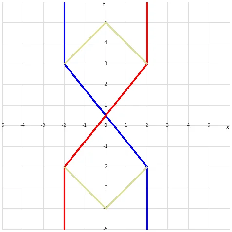

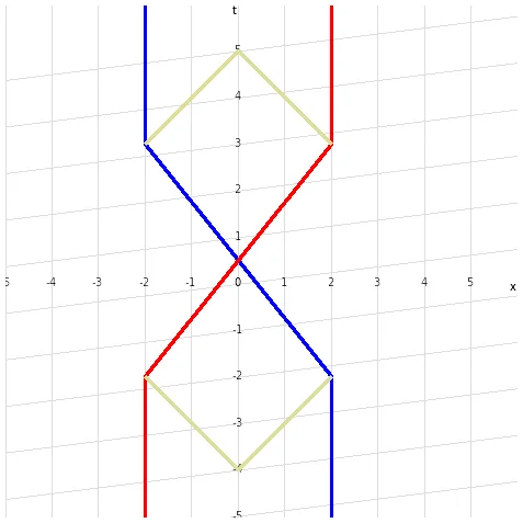

@James Hasty - here's why all attempts to measure the one way speed of light fail.
This is a Minkowski diagram - it shows the position of objects at different times. If you came across displacement-time graphs in high school physics, this is the same thing except we usually draw position horizontally and time vertically.
This one shows two clocks, one red and one blue. Initially (at the bottom of the diagram) they are at ##x=-2## and ##x=+2## respectively. At ##t=-4## a light pulse (yellow) is emitted from ##x=0## in both directions. It arrives at the clocks at ##t = -2## an they immediately set themselves to zero and begin moving, swapping places. They complete the manoeuvre at ##t=3##, come to a stop and immediately emit light pulses back to the origin, which arrive there simultaneously at ##t=5##.
The interesting point about Minkowski diagrams is that we take them pretty literally as maps of spacetime (at least, one space dimension and the time dimension). So the clocks (which are just point-like objects on this scale) are really the lines - points extended in time.
Note the assumption that the speed of light is equal in both directions in the diagram above. Can we consider an anisotropic one way speed of light? Yes - like this:
Notice how the horizontal grid lines are now slanted? That means that the initial light pulse leaves at ##t=-4## but arrives at one clock slightly before ##t=-2## and the other slightly after ##t=-2## - the speed of light is slightly higher in the ##+x## direction than in the ##-x## direction. And a similar thing happens at the top of the diagram with the returning light pulses which are not emitted at the same time but arrive at the origin at the same time.
But notice that none of the red, blue or yellow lines has changed. The only thing that's changed are the grey lines which are not there in reality. They are just things I added to the diagram to make interpretation easier. So there is no actual physical difference between the isotropic and anisotropic cases - the actual physical measurements will always be the same.
And that is the important bit. It does not matter how many bells and whistles you add to your experimental design, nor whether you have a 2d or 3d setup, whether you use wheels or bananas or whatever. The difference between the isotropic and anisotropic cases is always and only in the shape of the grid you imagine drawing on spacetime. This has no physical consequences.
