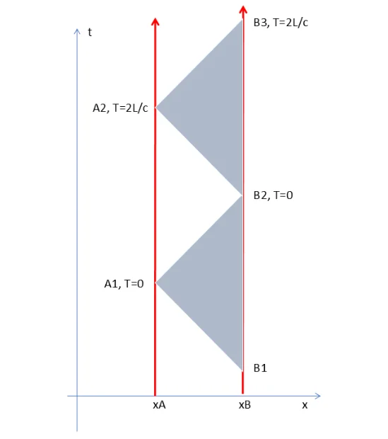

Given the round-trip average speed of light reflected between any two points is a constant: c = 300,000 kilometers per second. The method described below may be used to synchronize two clocks in an inertial frame without the assumption that the speed of light is isotropic.
ASSUMPTIONS
1. Two identical clocks A and B in the same inertial frame are stationary relative to each other a fixed distance L apart. Time passes at the same rate for both.
2. Both clocks are able to send/receive light signals and to write/read the send/receive times into signals.
3. The speed of light is anisotropic.
METHOD
1. At time t[A1] and time t[B1], clock A sends a light signal to clock B. The clock B time is unknown to A.
2. Clock B receives the signal from A at time t[B2] and sends a light signal back to A encoded with the time t[B2].
3. Clock A receives the signal from B and reads the time t[B2].
4. The time t[B1] can now be determined by A since it is given: t[B1] = t[B2] - 2L/c.
5. Then adjust clock A time to t[A(sync)]=t[A(now)]+Δt , where Δt=t[B1]-t[A1].

We might as well assume that ##t[A1] = t[B2] = 0##. When A receives the signal back from B, the clock reads ##t = \frac {2L}{c}##. A resets its clock to ##t = \frac{2L}{c} + 0 - \frac{2L}{c} = 0##.
Effectively, B sent a signal to A at time ##t_B = 0## and when A receives the signal it sets its clock to ##t_A = 0##. That's one way to do it.
Then the measured speed of light from B to A is infinite/undefined; and the speed of light from A to B is ##c/2##.

James Hasty said:
I am assuming the 1WSOL is anisotropic.
No you aren't. Dividing the round trip time by two and assuming that is the appropriate clock offset is an assumption of isotropic light speed.
As Dale said, do the maths with ##\kappa## and see what comes out.

James Hasty said:
In the introduction, "it is given" that the average speed of light is c for the 2WSOL . Then t[B2] - t[B1] = 2L/c.
No. At time t[B2] clock B receives light from clock A, that has moved only once over the distance L.
I misread the OP. As @PeroK says in #2, you have a ##c/2## one-way speed in the A-to-B direction and an ##\infty## speed in the B-to-A direction.
Note that this has the odd effect that two simultaneous events can be causally connected, but only in one spatial direction.

James Hasty said:
Let's be clear on definitions
Indeed, to be clear post a spacetime diagram with each event labeled and each signal indicated. And perform your calculations using one of the standard notations provided to you earlier.
Also, use Latex for all of your math. When you have prepared that send me a DM and I will reopen the thread.
Edit: but I do think it is clearly unfeasible. You know the times the signal was emitted, received, and returned. You need to calculate the speed of light there, the speed of light back, the length, and the offset. Seems like too few equations in too many unknowns.
@James Hasty has prepared the diagram and some careful thoughts so I am reopening the thread.
I would think of that more like the case of lightlike coordinates. That a time coordinate is the same along a null path in some direction doesn't make it a possible set of simultaneous events. I would still require that a path be spacelike to make such claim.
PAllen said:
a time coordinate is that same along a null path in some direction doesn't make it a possible set of simultaneous events. I would still require that a path be spacelike to make such claim.
There is disagreement in the literature on this point. But I tend to agree with you. Anderson, in contrast, does not restrict his ##\kappa## to be less than 1.
I also agree. To call what you get with a homogenous but anisotropic two way speed a "simultaneity plane" you need to require that ##c/2<c_\pm<\infty##. Going further than that turns one of your spacelike coordinates null or timelike, which is a fine coordinate system but doesn't have a natural interpretation in terms of "stationary objects" and "simultaneous events".
I should have put "simultaneous" in scare quotes in #13.
