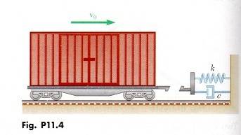

A loaded railroad car is rolling at a constant velocity when it couples with a spring and dashpot
bumber system. After the coupling, the motion of the car is defined by the relation
##x = 60e^{-4.8t} sin16t##, where x and t are expressed in millimeters and seconds, respectively.
Determine the position, the velocity, and the acceleration of the railroad car when
(a) t = 0, (b) t = 0.3 s.

I get the correct results.
Is my approach to solution correct?
