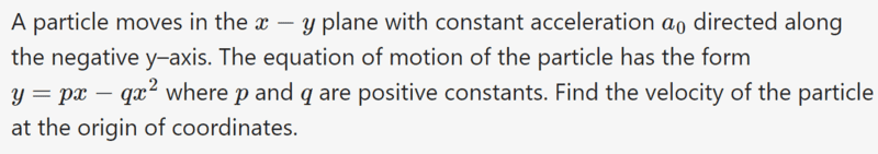

A particle moves in the ##x-y## plane with constant acceleration ##a_0## directed along the negative y–axis. The equation of motion of the particle has the form ##y=px-qx^2## where ##p## and ##q## are positive constants. Find the velocity of the particle at the origin of coordinates.
1. If ##\dot x = v_x=\dfrac{dx}{dt}## is the ##x## component of velocity and ##\dot y = v_y=\dfrac{dy}{dt}## the ##y## component of velocity, then the (scalar) velocity or speed at a point is given by ##v = \left( \dot x^2+\dot y^2\right)^{\frac{1}{2}}##.
2. Acceleration components ##a_x=\ddot x## and ##a_y=\ddot y##.
3. Acceleration can also be expressed as a function of position, for instance, ##a_x=v_x\dfrac{dv_x}{dx}##.
Problem statement : I copy and paste the problem as it appears in the text down below. I have only changed the symbol of the given acceleration from ##a\rightarrow a_0##, owing to its constancy.
Attempt : I must admit that I could proceed very little.
Given ##a_0=\dfrac{d^2y}{dt^2}\Rightarrow \dot y = a_0t+b##. But the constant ##b## is unknown.
Likewise, it is also given that ##\dfrac{d^2x}{dt^2}=0\Rightarrow \dot x = c##, but the constant ##c## is unknown.
Differentiating the path of the particle ##y = px-qx^2## on both sides with respect to time, ##\dot y = p\dot x-2qx\dot x\Rightarrow a_0t+b = pc-2qcx##.
This equation can yield the position ##x## as a function of the unknowns ##b,c##.
Substituting for ##x## in the equation of the curve can yield ##y## again as a function of the same unknowns.
I can't see how to progress from here.
Request : A suggestion as to how to proceed to solve the problem will be welcome.

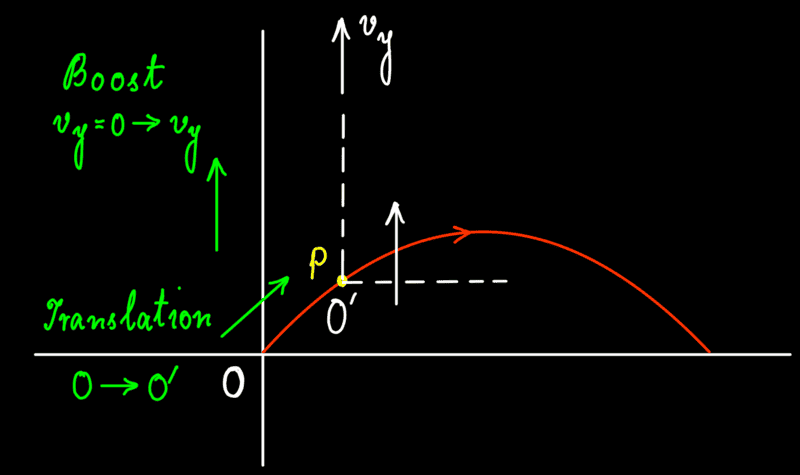

Making ##y=0## at some time ##t=0## involves a translation of coordinates. Which is valid.
Why can't we do the same for ##v_y##? Give our frame a boost equal to ##v_y## at time ##t=0## so that the particle has ##v_y=0## at time ##t=0##.
Let me draw a projectile motion to help you see my point, mistaken though I might well be.
The path of the projectile is shown in red. At some point P, the projectile clearly as its position ##y\ne 0## and y-velocity ##v_y\ne 0##. So I propose making a translation of the origin to some ##O'## such that ##y'=0##. Likewise I propose giving this frame a boost equal to the particle's y-velocity ##v_y## such that the particle has velocity ##v_y'=0##.(We'd discuss the situation with the ##x-##components a bit later, let's focus on the ##y-##ones for now)
Yes, but the particle is no longer at the origin at ##t = 0##. You can't transalte the coordinates without affecting the equation you were given: ##y = px - qx^2##. That's a coordinate dependent equation.
I think this is a very interesting point, and I am prepared to wait before solving the problem.

brotherbobby said:
I choose ##t=0## when the particle is at ##(0,0)##. I likewise choose ##v_y=0## at the time ##t=0##. You might say that this gives the frame of reference a boost - but why am I not free to do that?
Because now you've set ##v_y = 0## at the origin. You can check that this is invalid by looking for a counterexample. Any projectile motion with an initial velocity at the origin would do that. You can check that this satifies an equation of the form ##y = px - qx^2##. ##v_y## would be zero at the apex: ##(x_1, y_1)##. If we make this the origin, with ##x' = x - x_1, \ y' = y - y_1## we get the new equation:
$$y' + y_1 = p(x' + x_1) - q(x' + x_1)^2$$And this equation is not of the form ##y' = px' - qx'^2##.
Whereas, a time translation ##t' = t - t_0## does not change the equation of the trajectory in the ##x-y## plane. So, you can take ##t = 0## at the origin without changing the equation you were given to work with.

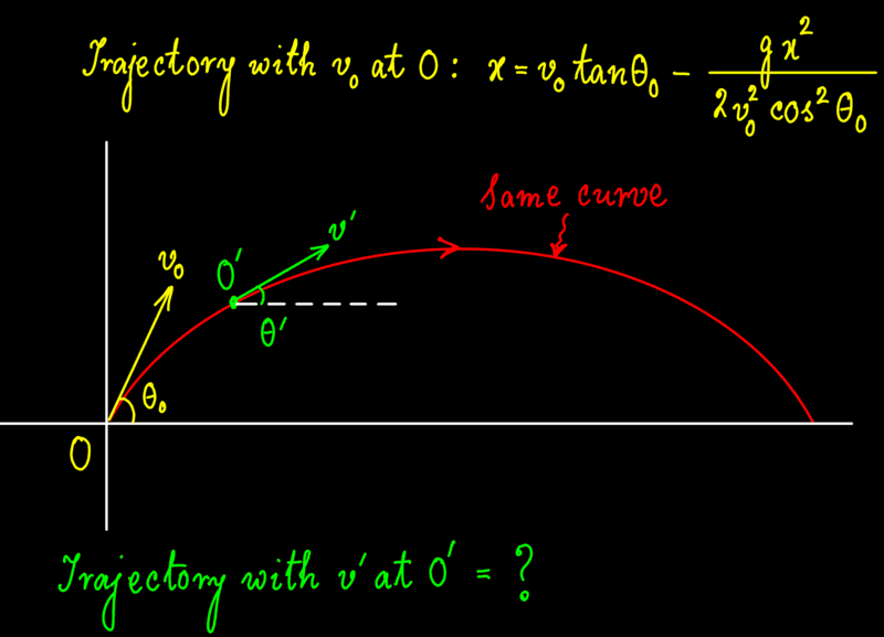

Yes. But how to go about finding the velocity at the origin? The problem is set in a twisted way.
Do you know how the equation of trajectory looks like for projectile motion? What are the p and q constants in it?
PeroK said:
It must. Even the equation of a straight line changes if you translate the ##x## and/or ##y## coordinates.
I agree. In ##y=mx+c##, ##c## is well-known to be the ##y-##intercept. "Move" the coordiates a distance of ##c## vertically and the equation of the same line is ##y'=mx'##. Rotate the axes and even ##m'## will change.
However, I think the present conundrum requires a mathematical working out, not least because of its non-intuitive nature. I draw below for you what I have in mind - but briefly, it is this :
"If I transform the equation of the trajectory for a projectile, viz. ##y = x\tan\theta-\dfrac{gx^2}{2v_0^2\cos^2\theta}## where the quantities have their usual meanings, from the present origin ##O## to a new origin ##O'(a,b)## along the trajectory, and suitably use the new angle to the horizontal ##\theta' (<\theta_0)## and new initial velocity ##v'(<v_0)##, will it alter the form of the equation from ##y'=x'\tan\theta'-\dfrac{gx'^2}{2v'^2\cos^2\theta'}##?"Of course my intuition tells me it shouldn't, wrong though I know it is. The drawing below shows my confusion:
We have for the new velocity ##v'=(v'^2_x+v'^2_y)^{\frac{1}{2}}## where ##v'_x=v_{0x}=v_0\cos\theta_0## and ##v'_y=(v^2_{0y}-2gb)^{\frac{1}{2}}## and ##v_{0y}=v_0\sin\theta_0##.
Likewise for the new angle ##\tan\theta'=\dfrac{v'_y}{v'_x}##.
Already I can see your point, in that there is a ##b## of the new coordinate origin appearing in the equation but nowhere the ##a## of the new origin. Is it possible that the ##b's## will cancel out with one another, or with the ##a's## where they are related by ##b = a\tan\theta_0-\dfrac{ga^2}{2v^2_0\cos^2\theta_0}##? I have to calculate to find out.
Sure. ##p=\tan\theta_0## and ##q = \dfrac{g}{2v_0^2\cos^2\theta_0}##
Then what else do you need to find velocity at time t=0? What is the ##v_0## in the expression for q?

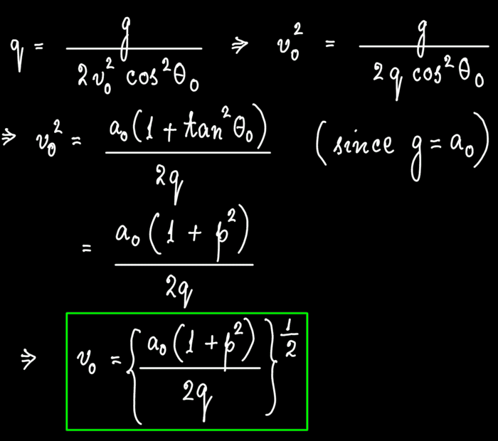

I copy and paste my working below.
This is the answer from the book, but it makes reference to the details of projectile motion, so perhaps less suitable. I suspect the way to the answer is @Orodruin 's method in post#5, which I will do in a moment.
As you see in the posts above, I am stuck with a conceptual problem - namely, should the equation of the trajectory of a projectile change if one were to effect a change in its coordinates to some point along the trajectory?
Imagine you fire a projectile straight up and want the speed at the origin, which was the original starting point. First, you move the origin to the highest point, where the speed is zero and that's your answer?
  • #33
I am sure you phrased the question incorrectly. Can you rephrase it for me?
  • #34
I think you should focus on the problem you started with. As a separate exercise you might want to study some graphs and look at how their equations change when you translate the ##x## and ##y## coordinates.
If you don't like taking ##t = 0## at the origin, then take ##t = t_0## at the origin. Or, use the alternative method using derivatives, where you don't need to introduce the time parameter.
In any case, you don't need the parameter ##\theta##. That unnecessarily complicates the working. You are already given ##p## and ##q##. That's what you should be working with.

Yes, I got it. Let me copy and paste the solution to the problem. Better still, since we have had plenty to discusss and digressions along the way, let me start with the problem itself.
Problem statement :Solution :
Given the equation of the curve : ##y = px-qx^2##. Thus
\begin{equation*}
\begin{split}
\boldsymbol{\dot y}& = \boldsymbol{p\dot x-2qx\dot x}\\
\Rightarrow \dot y(O)& = p\dot x(O)\quad [x(O) = 0]\\
\Rightarrow v_y(O)&=pv_x(O)\quad\quad \mathbf{(1)}
\end{split}
\end{equation*}
Differentiating the bold equation above again, we get
\begin{equation*}
\begin{split}
\ddot y& = \cancel{p\ddot x}-2q\dot x^2-\cancel{2qx\ddot x}\quad [a_x=0\rightarrow \ddot x=0, x(O)=0]\\
\Rightarrow \ddot y(O)& = -2q\dot x(O)^2\\
\end{split}
\end{equation*}
But it is given that ##\ddot y = -a_0##, since the acceleration is directed downward. Hence from above, we obtain ##-a_0 = -2q\dot x(O)^2\Rightarrow v_x(O) = \sqrt{\dfrac{a_0}{2q}}\quad\quad \mathbf{(2)}##
Using (1) above (2) above, we have ##v_y(O) = \sqrt{\dfrac{a_0}{2q}} p##
But ##v(O) = \sqrt{v_x(O)^2+v_y(O)^2} \Rightarrow \boxed{\boldsymbol{v(O) = \sqrt{\dfrac{a_0}{2q}(1+p^2)}}}\quad\color{green}{\Huge{\checkmark}}##.
This agrees with the answer in the textbook.{The problem fades in importance to the critical point I gathered during my discussions with @PeroK - namely, that the equation of the path of a projectile ##y(x) = px-qx^2## is true only for the initial velocity ##v_0## defined at the origin. I am yet to show how this is true, and the thread therefore remains unresolved}
  • #41
You can have ##v_0## wherever you like, but then it's no longer ##v_0## that you are trying to calculate! If you are asked for the velocity at the spatial origin, it makes little sense to set ##v_0## somewhere else.
Moreover, if you don't have ##t = 0## at the origin, then you need to be careful about whether ##v_0## is ##v(t = 0)## or ##v(x = 0)## as these no longer coincide.
